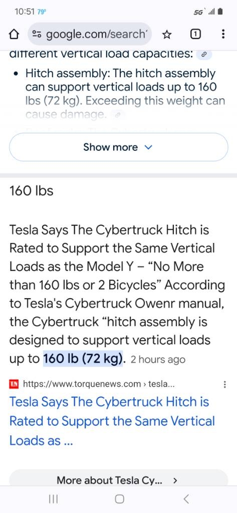

Here's something to consider with a cybretruck and pulling.
The vertical load for their hitch is the same as a Y model.
160lbs
So how can they safety pull anything but a tiny little trailer??

In the same article I found, apparently the hitch can handle an 1100lb tongue weight. Someone did a copy and paste in the manual from the Y manual.
Seems a likely explanation, but maybe not inaccurate in the end, after what we've seen from these hitches.
If they had it originally rated 1100 lb., I suspect they must be lowering that number today, based on those that have cracked or fallen off. It is a serious problem, and I'll be surprised if they don't address it in future revisions.

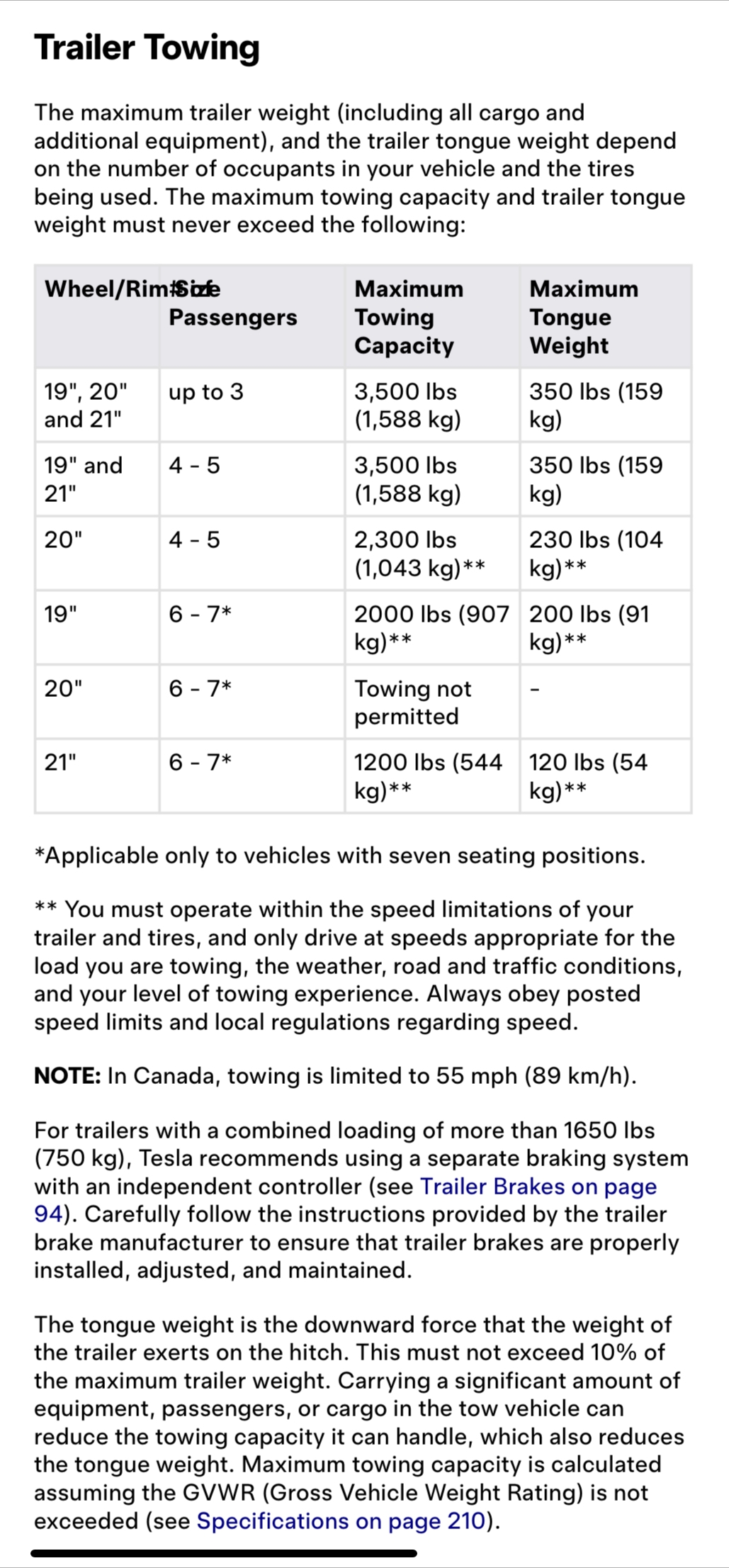

The online manual says not to exceed a tongue weight of 10% of the 11,000# tow rating. That is where the 1,100# comes from. Since bumper pull tongue weight should be 10%-15% to avoid swaying from side to side, that's cutting it close to tow at max capacity. If towing close to max capacity you either have to overload the hitch to tow without the risk of swaying, with the risk of damage to the receiver hitch, or underload it to avoid receiver hitch damage and risk losing control from swaying. The 1,100# is 15% of approximately. 7,400# so that is a more realistic number of what you can safely tow and not overload the receiver hitch. Plus the fact that towing at max weight eats up the battery and you have to stop every 100 miles or so to charge makes me think they didn't really design it with serious towing in mind.

From my owners manual it does state 160 pounds for bicycle racks. But those are long levers. For trailers with a short drawbar with a trailer ball the limit is 350 pounds.
