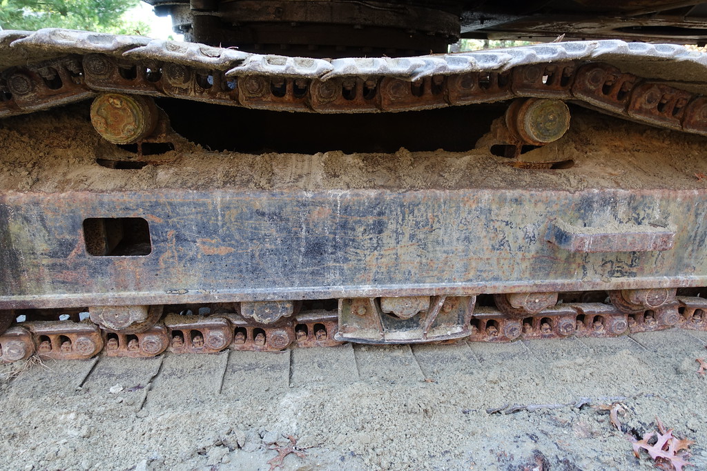

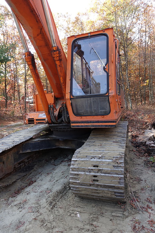

I went and looked at a Hitachi excavator. I took some photos and was hoping some of you could tell me "something" from the photos.
The excavator is a Hitachi UH083LC. It's been owned by a friend of my father's for the last 20 years or so, and hasn't had much use over the last 5-8 years. He is retired now and getting rid of his equipment.
I do trust what he says and am not overly concerned that he is trying to pull the wool over my eyes, but just thought I'd get some of your opinions on the machine. I know nothing about excavators.

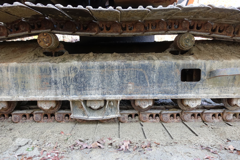

He operated it for about 45 mins while I "watched", and I didn't see any leaks or major slop anywhere. He did say one of the track pads were broken which he pointed out to me, and that one track needs some grease to tighten it up. The only issue with the excavator is that when you are traveling with it, and hold both sticks all the way forward, it doesn't track perfectly straight, but always goes a little to one side, so you have to adjust a bit every once in a while to go in a straight line.
The pins for the bucket are a little loose and could be replaced. He does have an extra bucket (same size) with new teeth on it. It started right up and sounds really smooth with no unique noises. The cable to shut down the engine is broken, so you have to crawl up on top of it and shut it off from inside the engine case, not that big of a deal to fix I imagine.

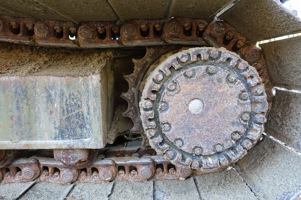

He said he has replaced the sprockets and chains on the undercarraige and I won't have to worry about wearing them out anytime soon.
Unfortunately it doesn't have a thumb. I don't know how much this would be to add, but it would be nice. Here are some photos, I'd love to hear some opinions on this model if anyone has experience good or bad. He also has a D3 dozer I might take a look at just for the fun of it :)

When you go to replace the bucket pins, look at replacing the bushings as well they will likely be worn excessively. The sprockets don't look awful but they don't look new either one track looks overly tensioned the other not tensioned enough. Broken track pads aren't a huge deal as long as the chain links aren't broken, which it looks like none of them were.

If you do end up purchasing the machine I'd recommend replacing all the fluids save for the hydraulic fluid depending on how many hours are on the machine,those final drives can be VERY costly to repair/replace

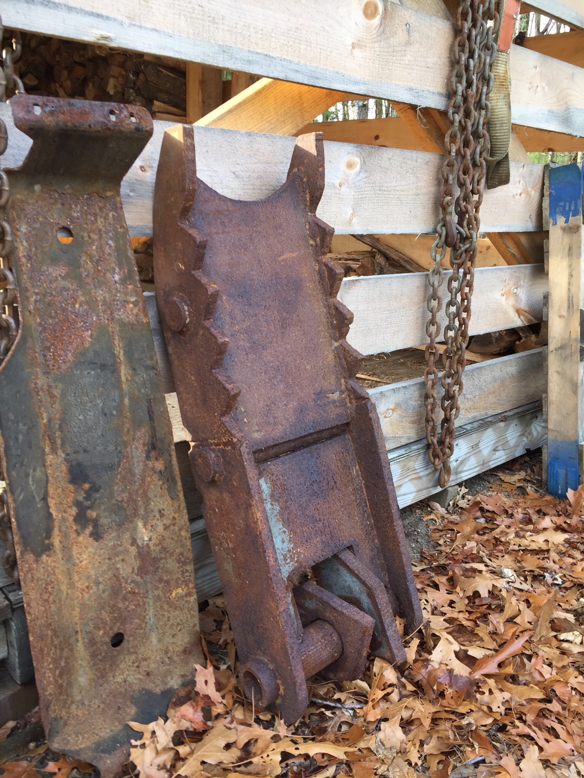

I actually have a mechanical thumb, although it's meant for about a 24k lb machine or so, built out of 1" steel, so I don't know if it's "stout" enough for a machine this big or not, but maybe would take a chance and if I bend it up then think about buying a new one.

I've seen worse looking machines for more $. If it does what you need right out the gate, $10K is a good price in my opinion. As with anything, there could be a multitude of things that are failing or about to fail. The undercarriage is not horrible by any means, but it might need the track adjusters rebuilt to keep the track tight. One of the travel motors could be failing since it won't drive in a straight line, those can be very expensive to fix. The biggest fear I have of older equipment is the lack of parts.

This is the thumb I made. It would be a little short, but it's made out of 1" steel and 3/4" steel.

He told me that I need to put some grease in the track adjuster on the loose track to tighten it up. Is there a rule of thumb as to how 'tight' you want to make it? He mentioned putting a 2x4 along the track and measuring the distance of sag, but I don't recall how much sag it should have.
