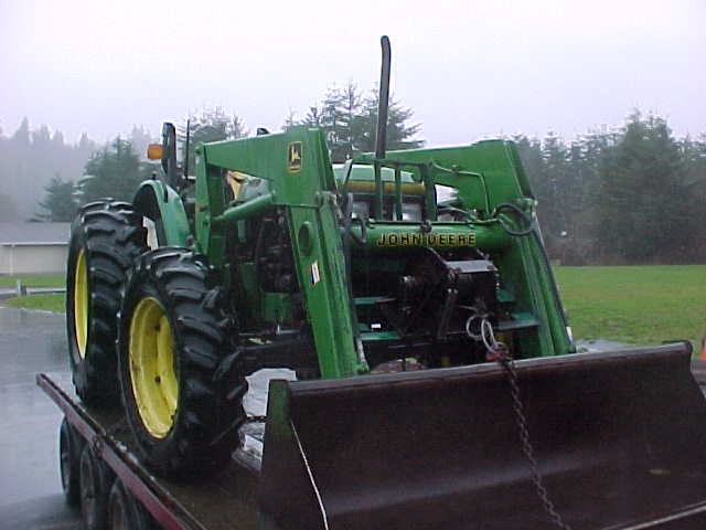

I have been buried to the frame. Evend with two wheel and no loader it is not that bad to get out. I take a fence post or something that is handy and won't break and get it behind the tractor wheels from one side to the other and chain it to each wheel. (be careful not to go through a spoke where the valve stem is) and back up slowly.once you have lifted the tractor up on the post put onother one down and so on. Of course unchaining each one. A loader is nice to lift the front and curl the bucket back to help push. I have a hydraulic winch permanently installed on my loader frame. I use it more than I ever expected. from moving piles of brush to loading logs. It is something that should be standard equipment.

I'd be interested in seeing a picture of how you installed a winch on your loader frame if you have one... Thanks in advance.

Light isn't too good, but hope you can get the idea. Heck of a time trying to figure how to get a pic in here.

<font color=blue>Heck of a time trying to figure how to get a pic in here</font color=blue>
Yeah, but think of the feeling of accomplishment when you did it - and did it well, too./w3tcompact/icons/wink.gif
