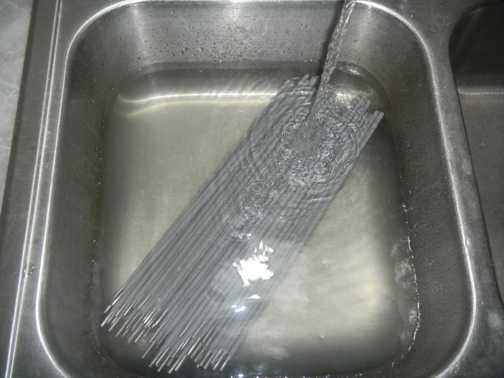

How does one decide when to bathe their 6011 rods?
/ Ever last 200st #24
When they run erratic, or burn off to one side.
Oh, okay, thanks. I was afraid the only response I would get would be something silly involving dirty children.
