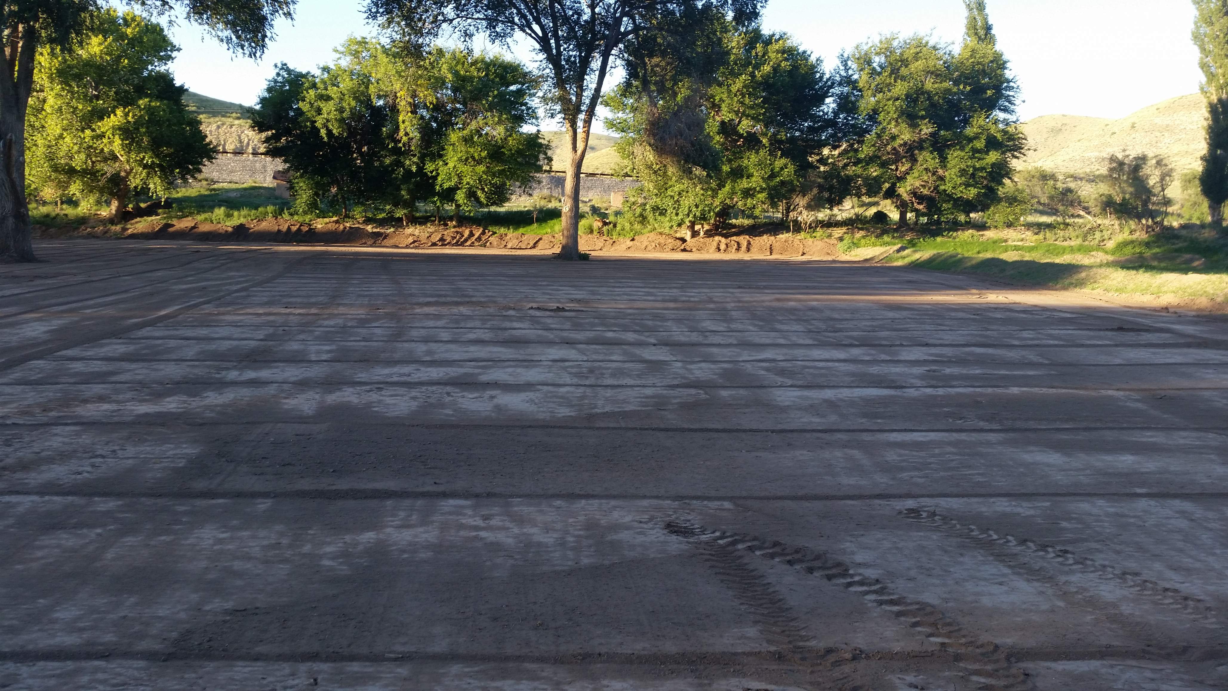

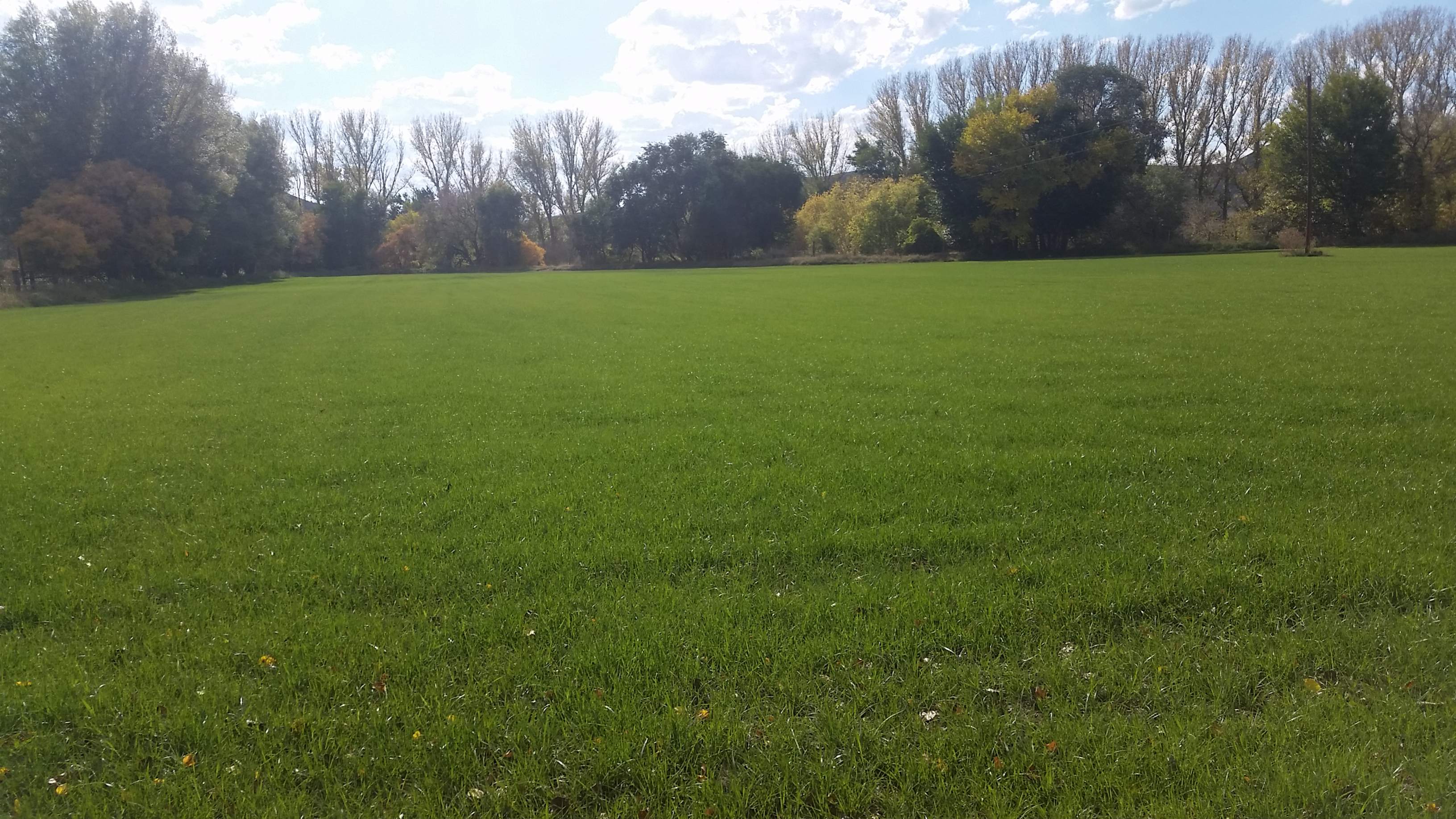

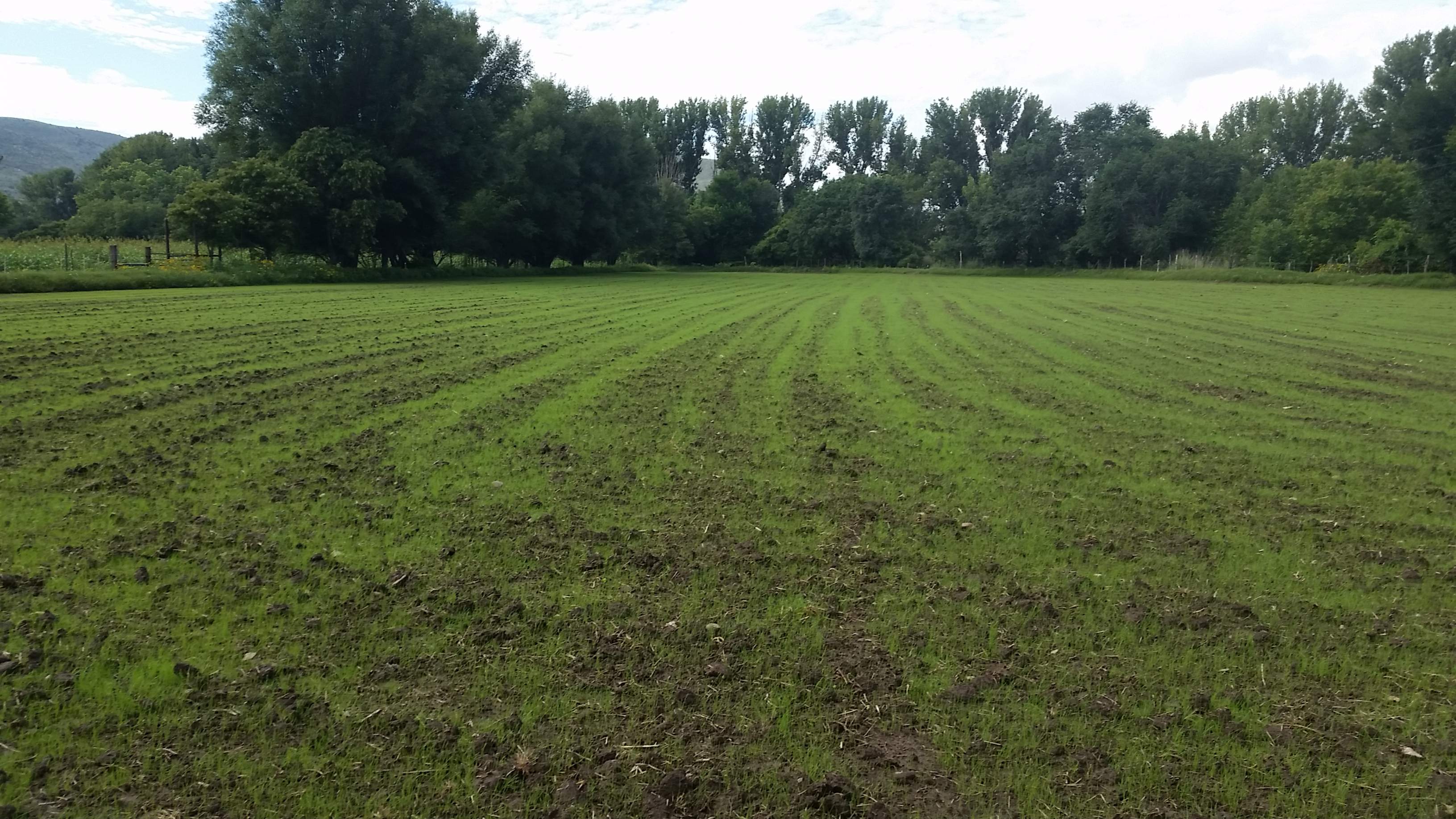

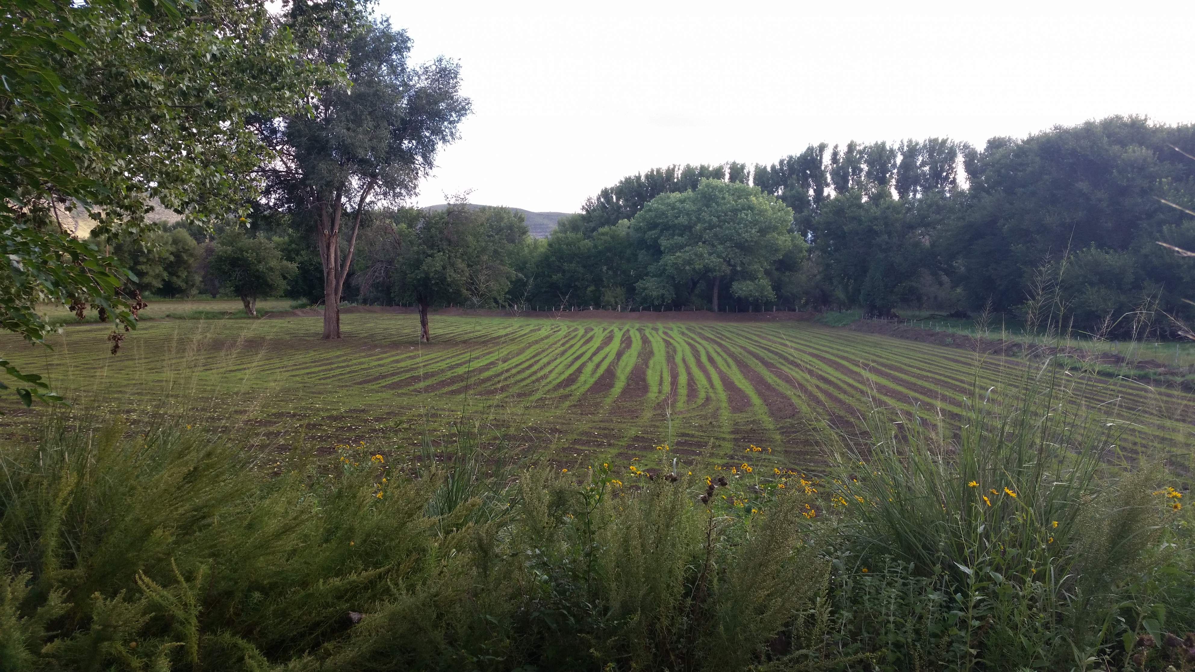

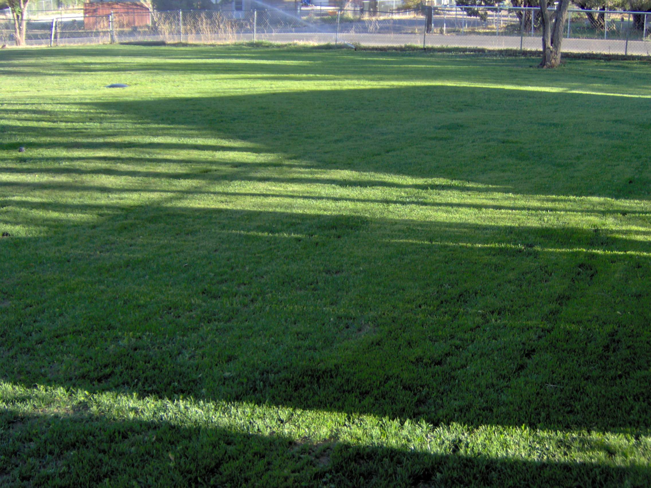

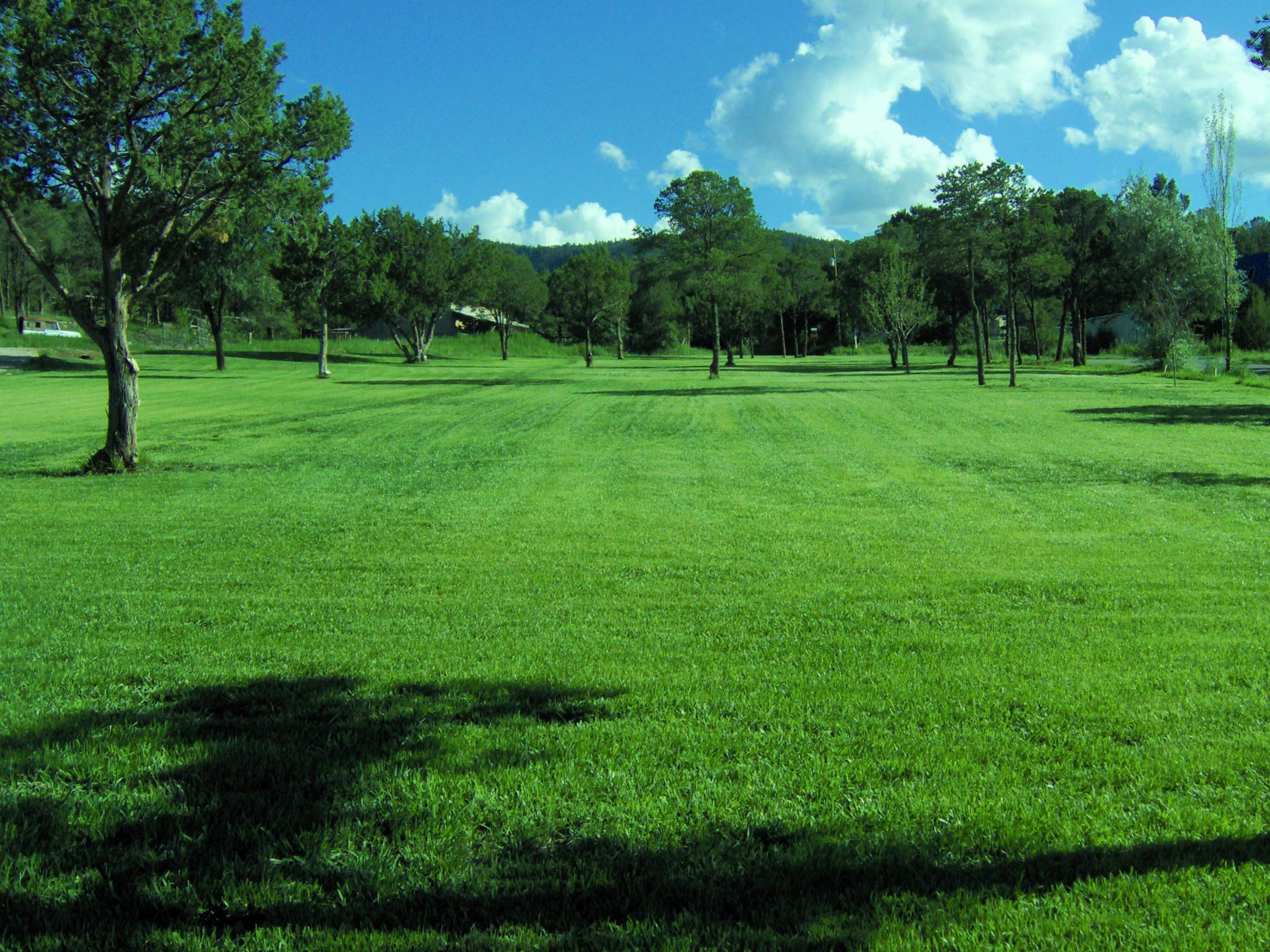

I use a 3ph broadcast spin spreader for new pastures and lawns in most cases. Works well enough for me. Wheel tracks will usually be where the grass comes up first due to the compaction and better seed contact with the soil. I divide the seed up so that I can make three trips across the field for more uniform seed application. Pictures below.

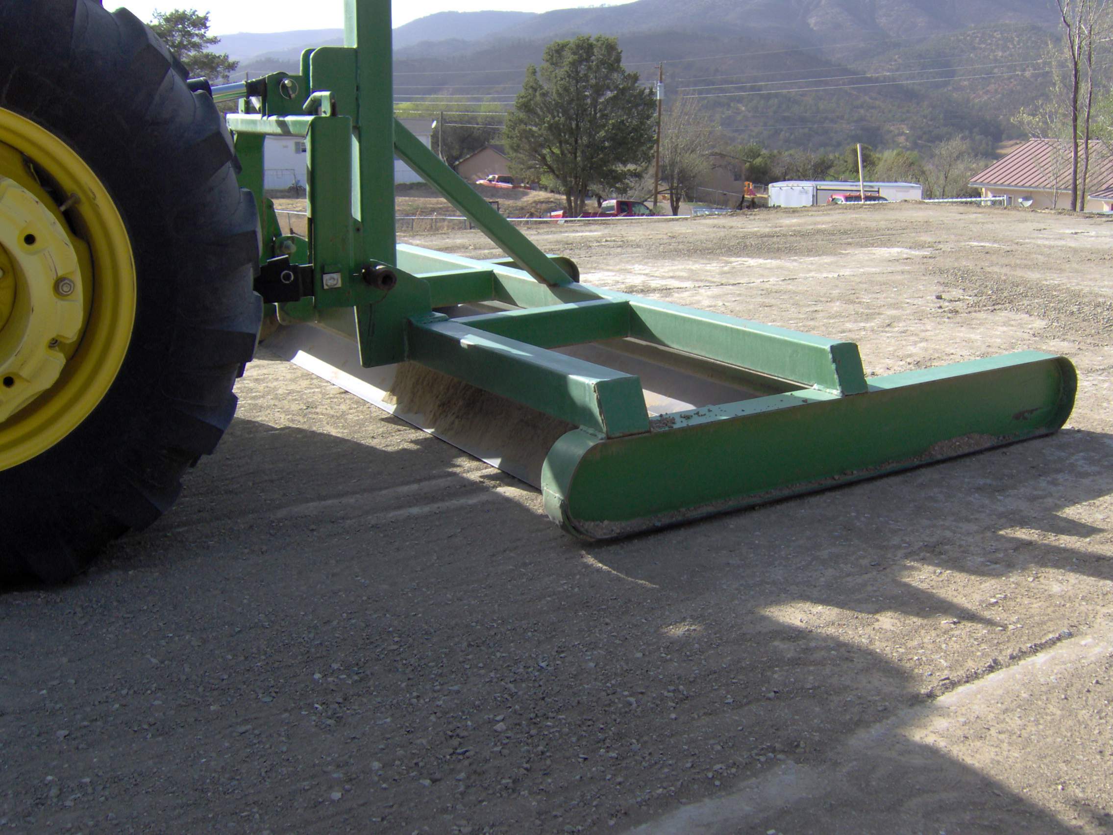

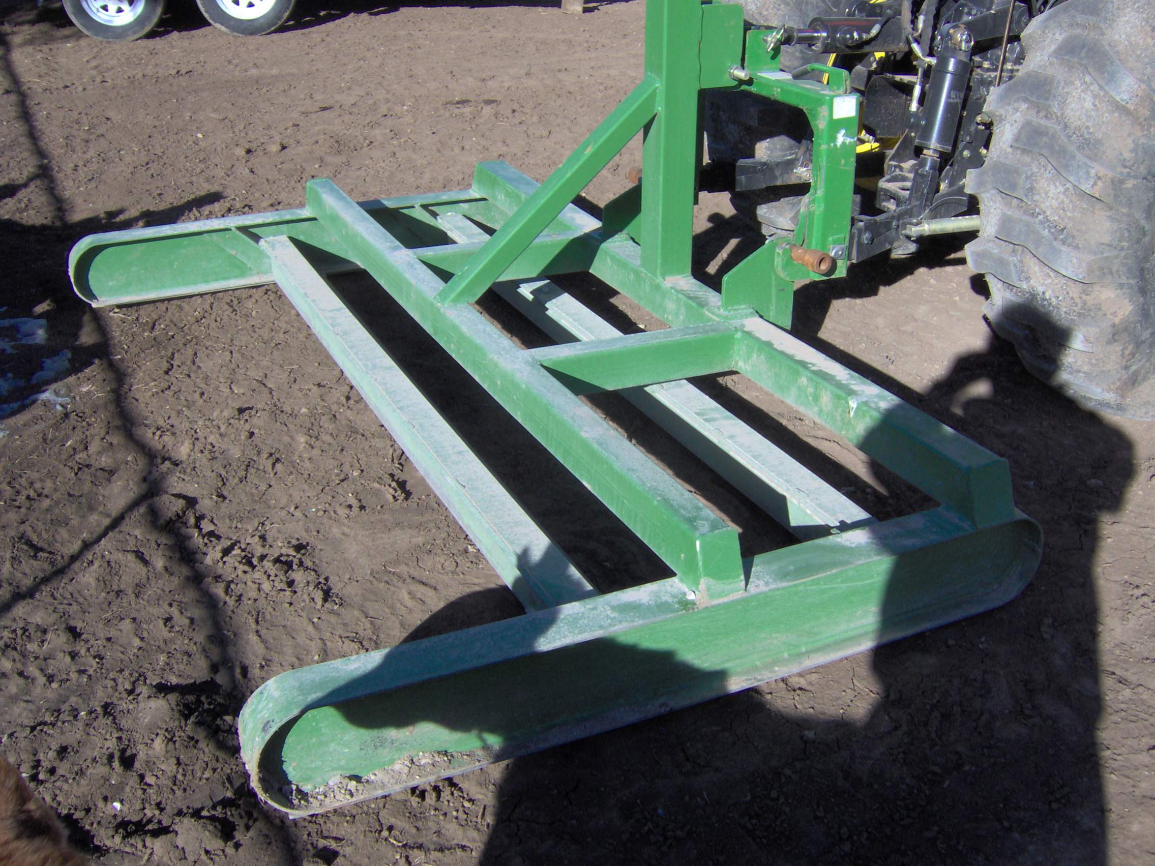

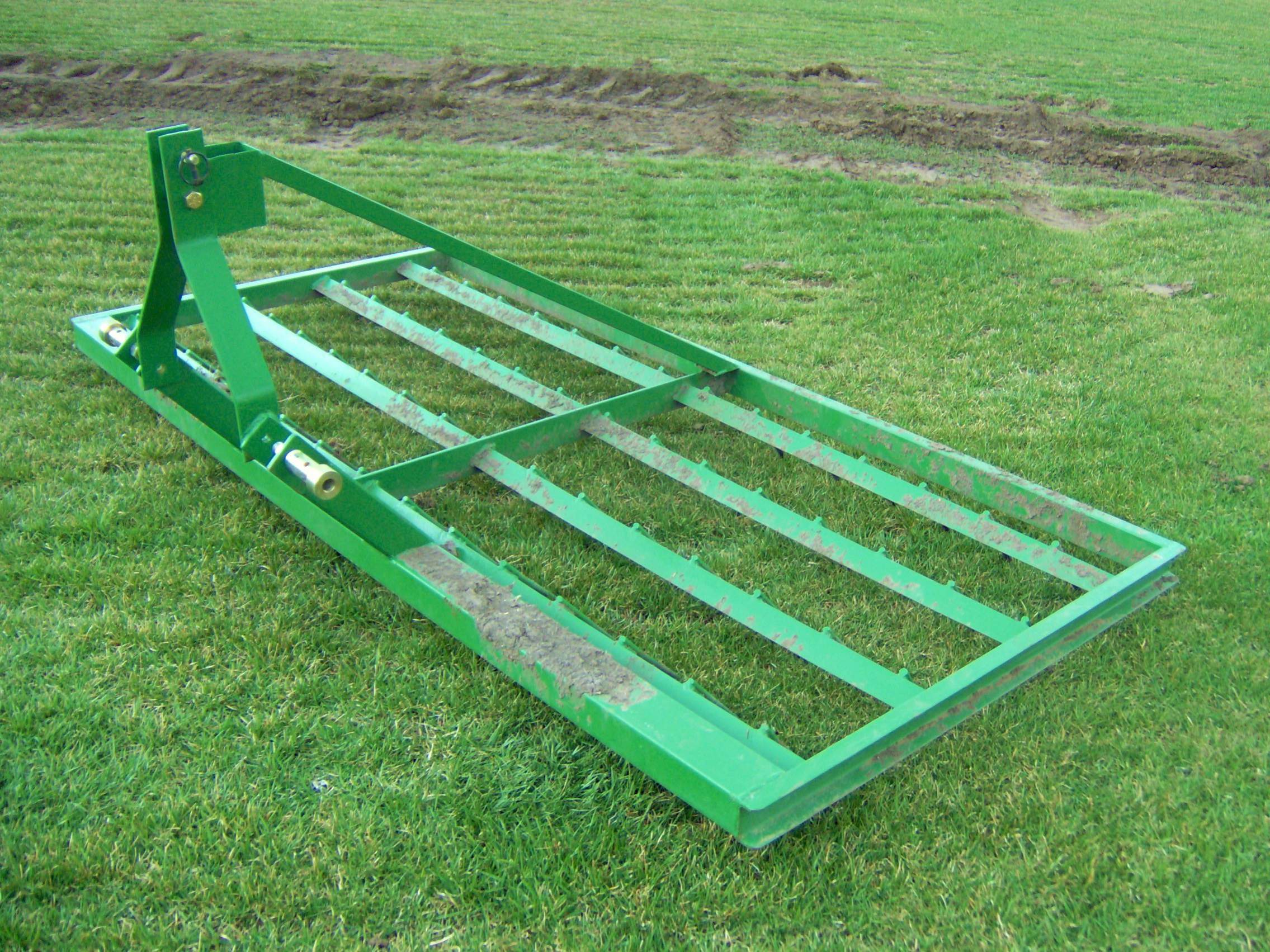

I don't use drags myself but are good if on a tight budget. I built a 3ph spiked tooth harrow for about $250 pictured below. I also built an 8' land plane grader scraper for smoothing lawns and fields pictured below. I also use a pine straw rake to cover seeds with good results too.
For fields and pastures I frequently grade the area with a box blade and laser set up for flood irrigated land then plant as above.
A few pictures of my work after the grass has grown up.
