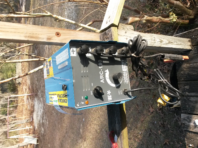

Well, I ended up getting a Chicago electric Arc-180 for $60. It's an AC/DC machine. It is a bit misleading, Arc-180 is 130 amp max on AC and 115 amp max on DC. I can't say that I'm impressed with the DC side, maybe it's rods (Hobart 6013 3/32), operator error, or maybe DC just likes cleaner metal than AC? If I switch over to AC it seems I get much better penetration, and less trouble starting an arc on slightly rusty material. I would say it's certainly worth the $60, but I guess I was hoping that the DC would be like magic and make everything easy.
Thanks for all the advice, and although I didn't follow it (except turning down an AC only hobart, and getting Ac/Dc), I think for the price I did well.

Paul,
Thanks for letting us all know. Keep us updated. For 60.00 you did well. You can't go wrong if it spits out a few sparks for you. DC shouldn't be hard to start unless you are using the electrode holder connected to the negative, or it could be because of the machine's really low OCV (25 volts or less on a good day). That looks like an older unit. Some of the older ones were Italian, but then they also had some that looked like the same ones but made in China. The transformer unit you have likley has a duty cycle of 10% on AC at max amps, and 15% I believe on DC if its the Chinese version. I'd stick with 3/32 welding rods for sure. While 1/8" is theoretically possible, I don't think it'll be practical. Due to the duty cycle limitations, I'd probably try 1/16 rods for best performance with starting and over all welding. But keep in mind this unit is below the class, capability and arc stablity of the other units mentioned here. Take care of it, and you shouldn't have any problems getting your money back out of it if you ever want to upgrade.

Not trying to be mean, but that AC only Hobart would have been a much much much much better unit than the one you pictured.
Most of the Chicago Electric welders are not very good to start with and the one you have shown looks to be 115 volt input power. No way is that thing cranking out 130 amps AC or 115 amps DC off a 115 volt input power. If it is the volt/amp curve is so bad that it not suitable for welding.
Now if you have the option of converting the plug to 230 volt input power then it might output the claimed spec's. For $60 though you likely did not get hurt, but you likely limited to 5/64" diameter rods and 1/16" diameter rods with a slight possibility for 3/32 6011. I am guessing your actual output on that unit is 70 to maybe 80 amps max off of 115 volt input power.
If that plug that appears to be a 115 volt plug is a blurry NEMA 230 plug then disregard most of what I said other than most all of the HF welders are not very good.
DC is nice, but it is not the huge welding made easy that everyone makes it out to be.
