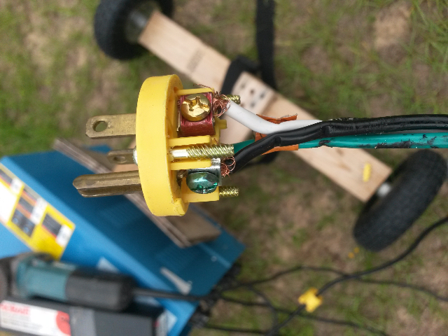

Ok, so I had problems with DC one the welder, had a heck of a time getting a stable arc using 3/32 6013 and only a sightly less hard time with 3/32 6011 name brand rods. And when I did finally get a bird poop bead, if I chipped the slag, the whole bead would come off. Zero penetration, at 105 amps. Ok, but far from happy with 130 amps AC... fan would never come on on either, always hard to start a bead. Always had a hard time, but I didn't want to admit it cause I assumed operator error. But I got an idea.... dangerous right; here hold my beer. What if the cord is only hooked up as 120v 20 amp instead of 240v 20 amp?
Here's what the plugged looked like.... so black to ground, green to hot...
Reversed black to Hot and green to ground, and.... guess what... It works like it should.... I was trying to burn 3/32 @ 57.5 amps DC and 75 amps AC...

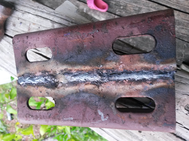

I know I shouldn't post a picture oof any of My welds but what the heck. 80-83 amps DC, 3/32 nd 6013 on some 3/16" brackets.

I'd say that is way to hot, which makes your travel speed way to fast. I'd try down around 50 to 60, maybe 70-amps. And slow down!
   / Everlast 140 and other DC welders #37
Yes i agree and way to hot. 65-70 should do him fine for starters.
   / Everlast 140 and other DC welders #38
You should have nice rounded ripples in the bead. The pointed ripples are an indication of too fast a travel speed. Looks a little too hot but you can't rely on the dial, you have to go buy what the weld is telling you. Some rods like 7024 will have slightly pointed ripples but they are a production rod. Shield Arc has some good pictures of what the ripples should look like.

I'll turn the heat down and slow down. I just was happy to lay down a rod or two with out a dozen start and stops.
