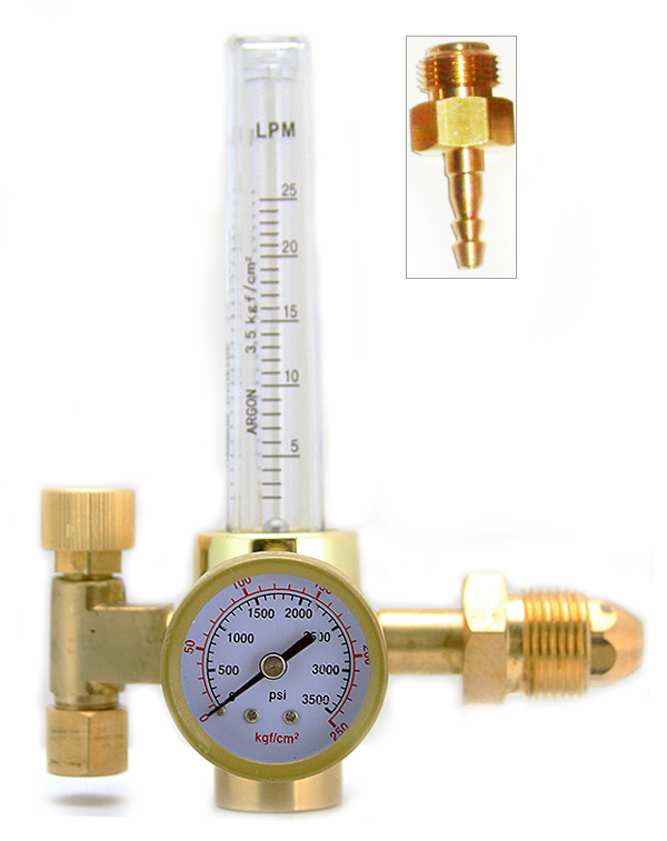

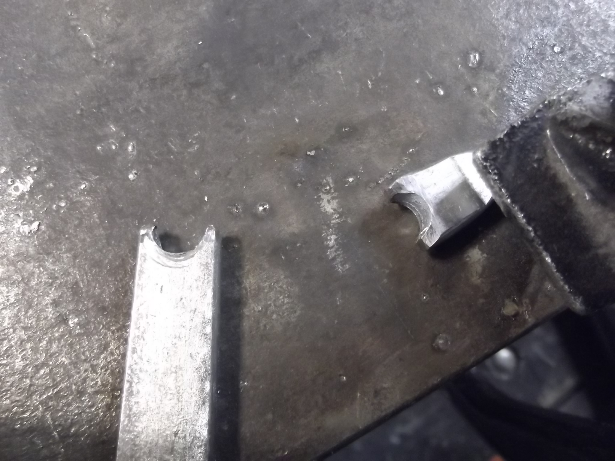

GW you should get into TIG welding. You have most of what you need now. Just a cheap $25 regulator about $75 for a 17V (for valve) torch and a bottle of argon, either rented or buy. I guarantee you will like it once you get the hang of it. It is usefull for all those things you were thinking about getting a MIG for without all the expense..Yes it is slower, but also more precise. You are always in control, and can work at your pace. It is sort of like gas welding. It is sort of like soldering only different.:D Anyway when you want to weld some thin, or small thing, break out the TIG torch and have at it. Here are some copper crush washers I made out of household copper wire in just a couple if minutes with my TIG setup on my PA160. And here is a broken hook I TIGed back together.
