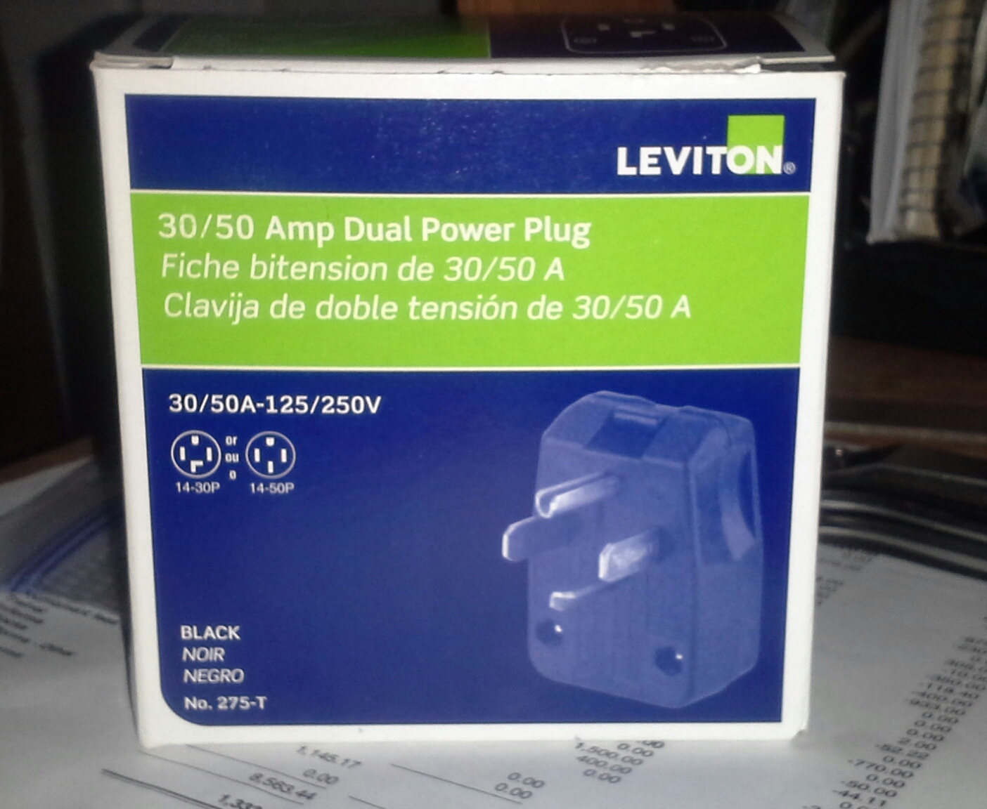

I'm getting closer. Picked up the plug while at Home Depot getting ready mix.
Here's the correct plug. One of the blades is more narrow than the other.

I'm using the same Home Depot (4-wire) plug without the neutral blade. It allows me to plug into all the 4-wire 220V/50A and 220V/30A outlets in my barn. Of course, I can only use 100+A on the 30A outlets but the flexibility is nice.

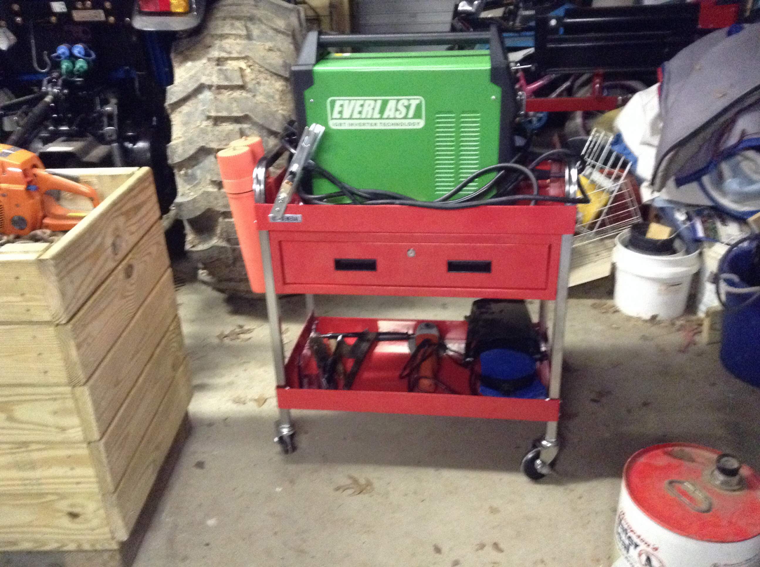

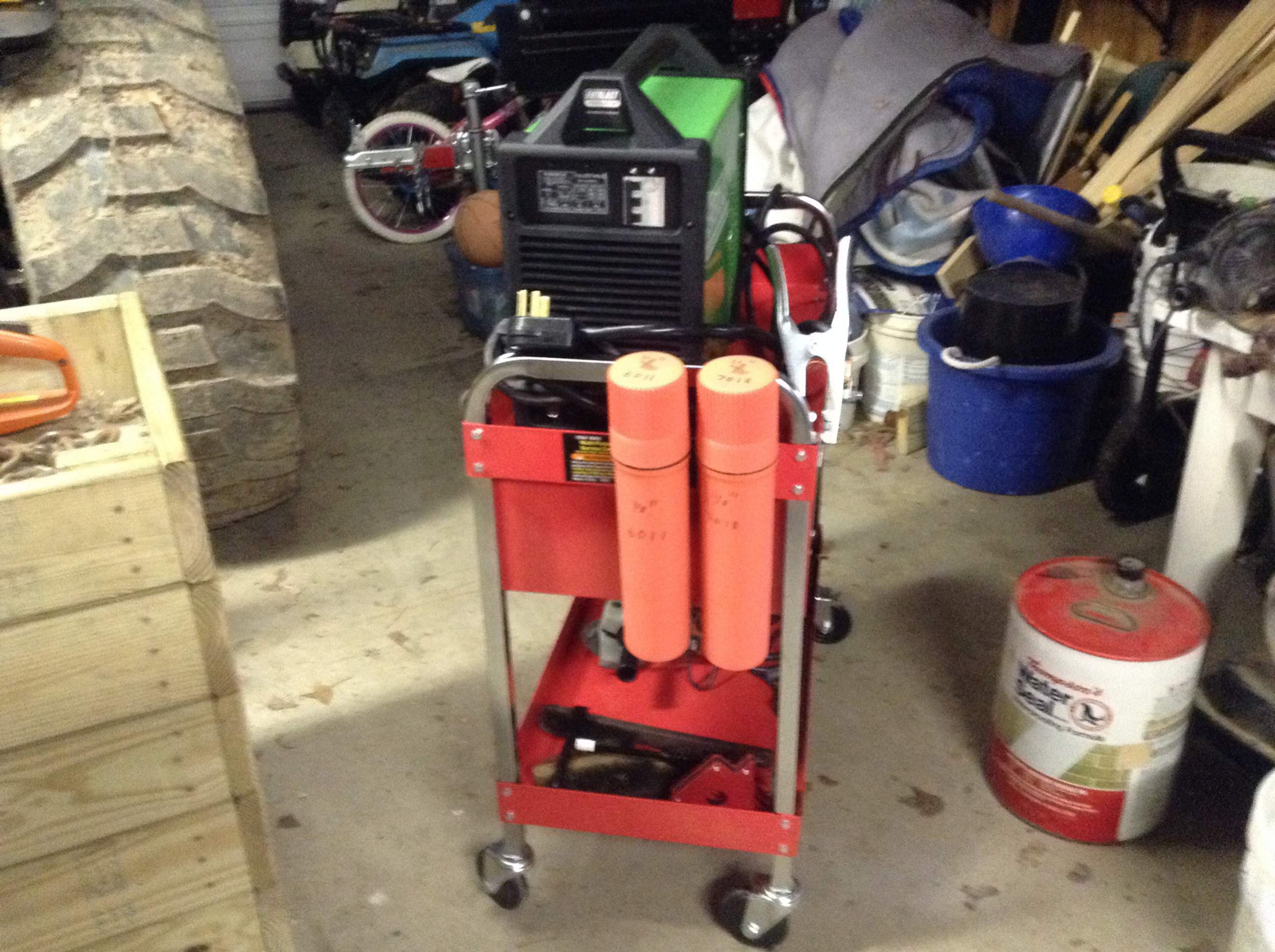

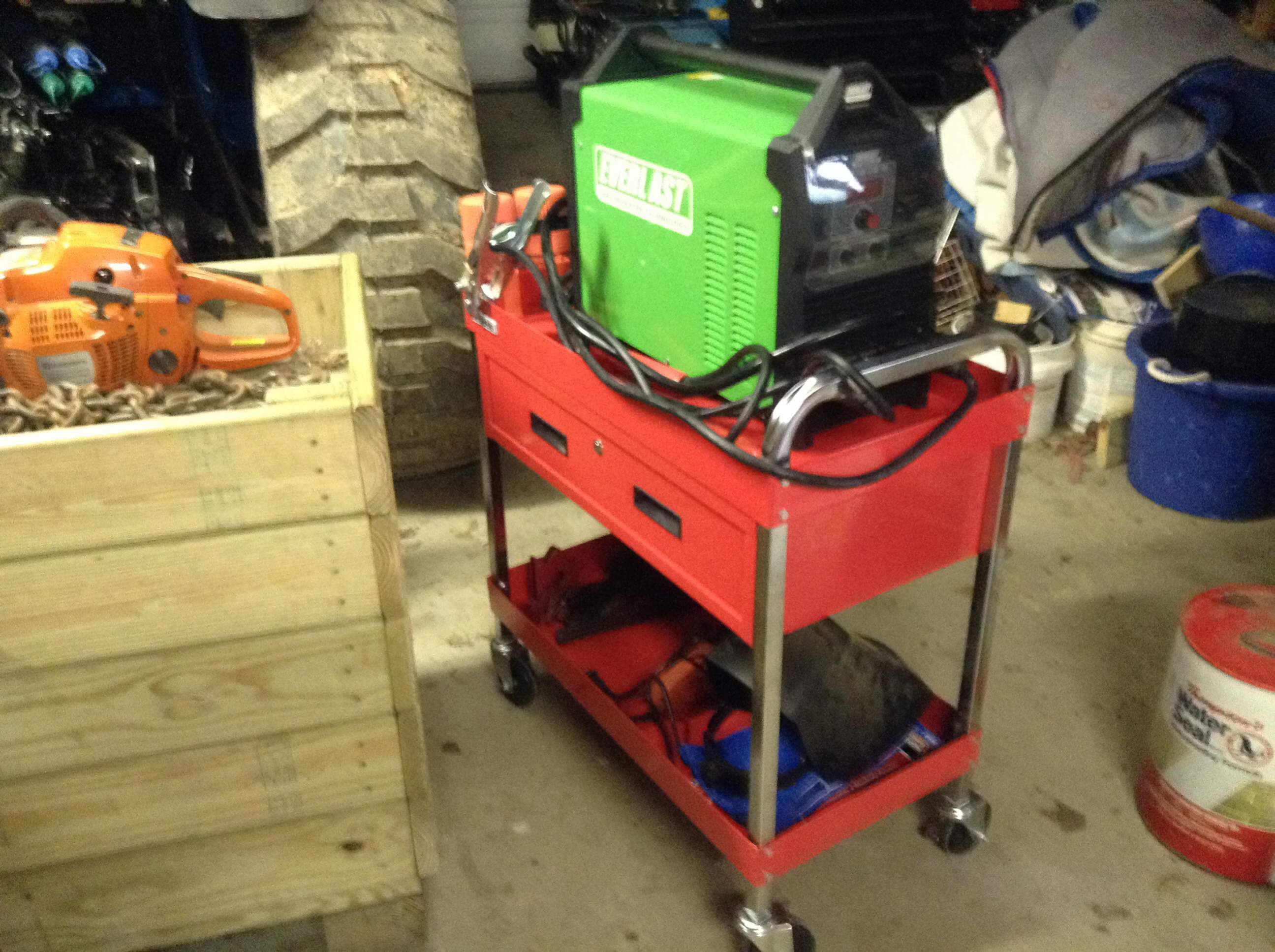

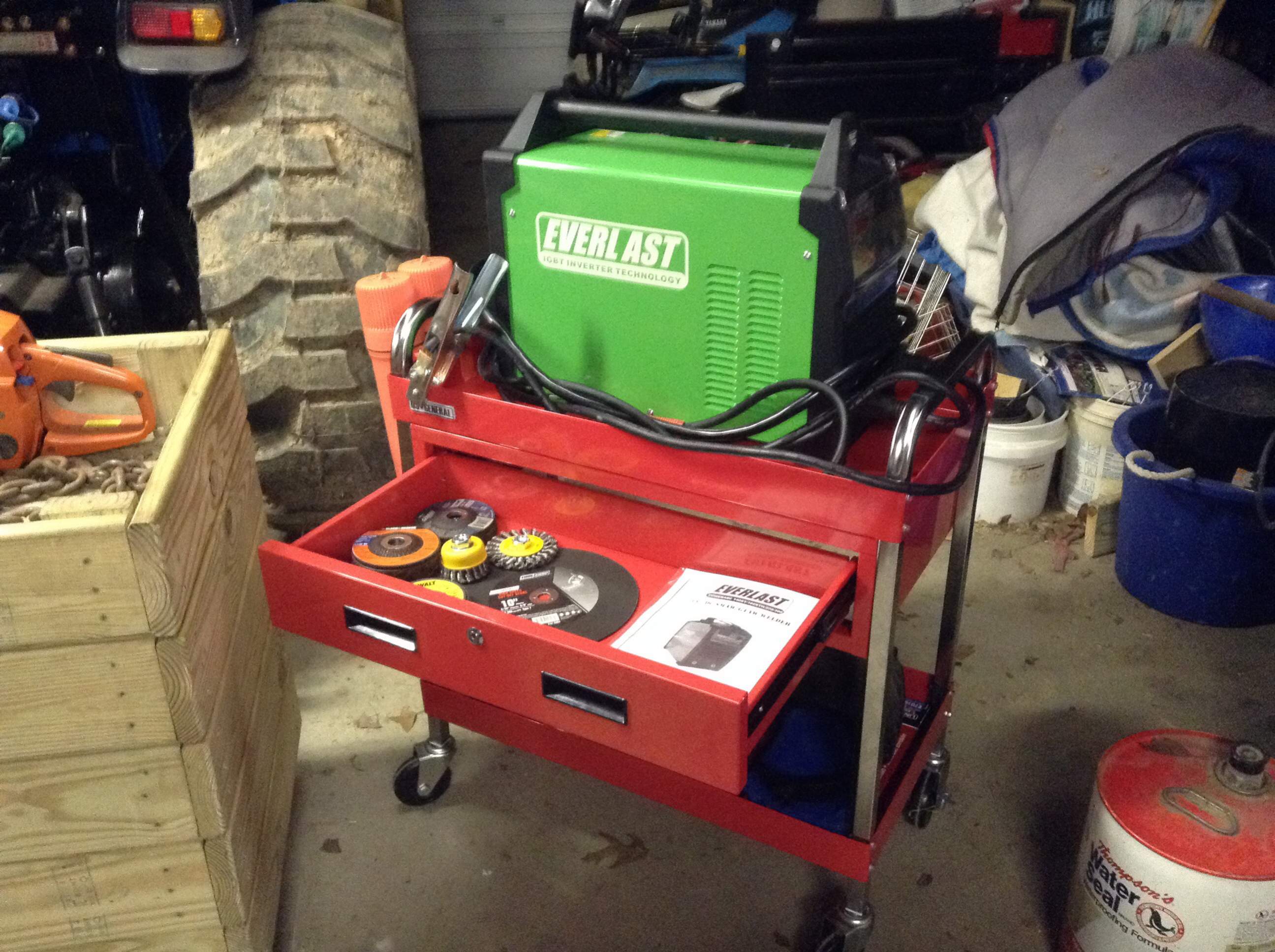

I put my PA300 on this cart:
Steel Tool Cart w/ Locking Drawer
I like it so far, seems heavy enough and rolls nice on concrete. A good quick fix for me, although one of my 1st projects might be to build a cart. The HF rod containers clip on the ends nicely. :)
