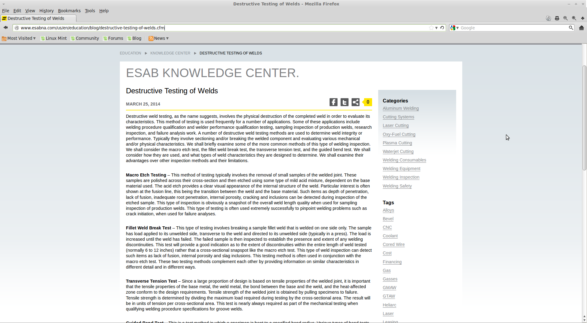

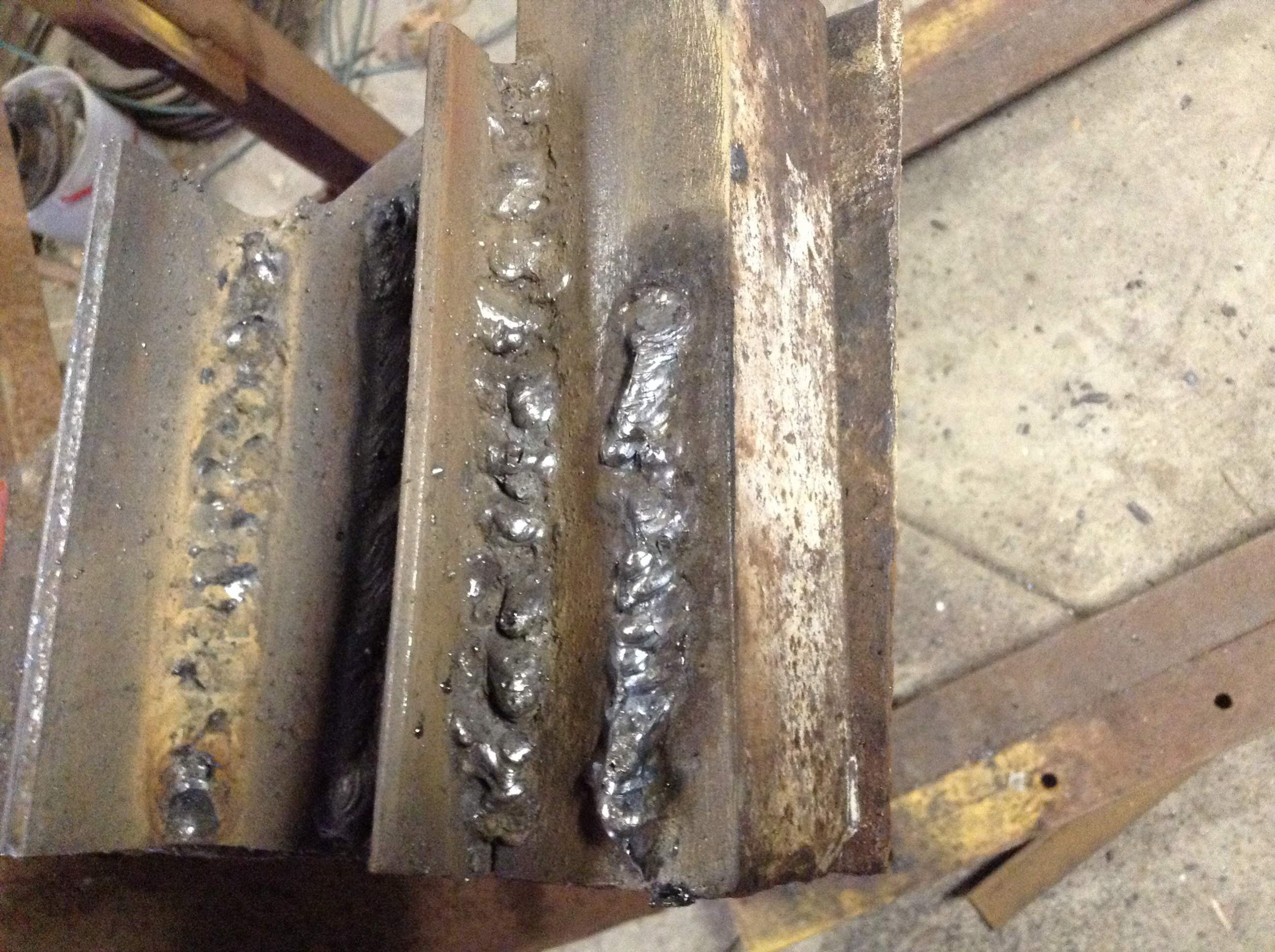

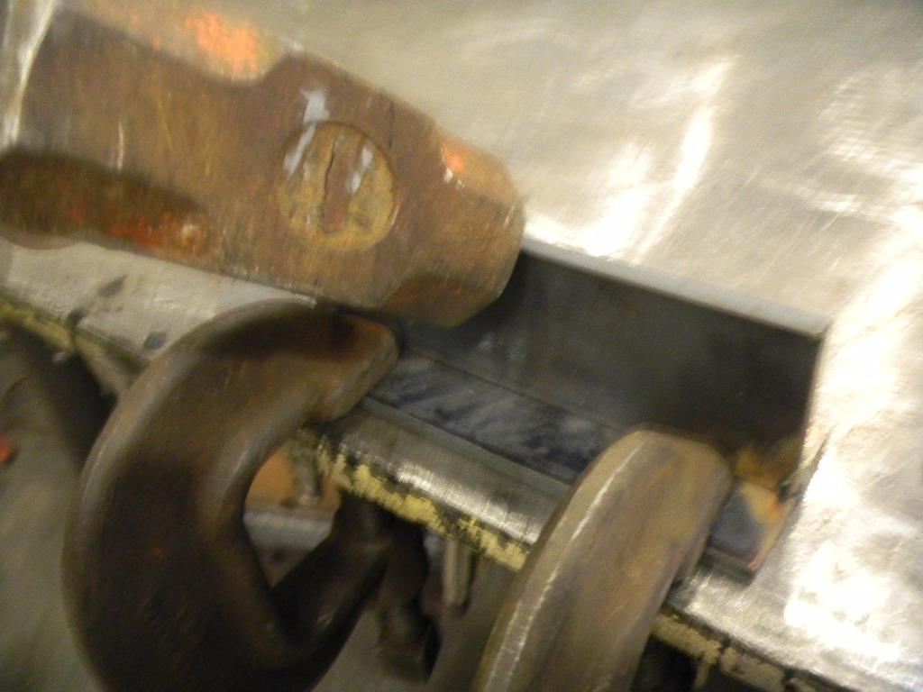

I've played around with different brands of 6010, and Hobart's 335A 6011. Same joint prep, same amps. Believe it or not, I got better penetration with Hobart's 335A 6011.
Use 7018 when ever you can, but especially on things that may be in an impact situation. A while back I did some fillet weld break tests. 7018 out performed all the other rods hands down.
Here are the results.
6013 broke with only 3-blows of a 4-pound hammer.
6011 = 8-blows.
7014 = 10-blows.
6010 5P-Plus = 10-blows.
7018 cold never seen the inside of an oven = 18-blows.
7018 right out of the oven = 23-blows.
