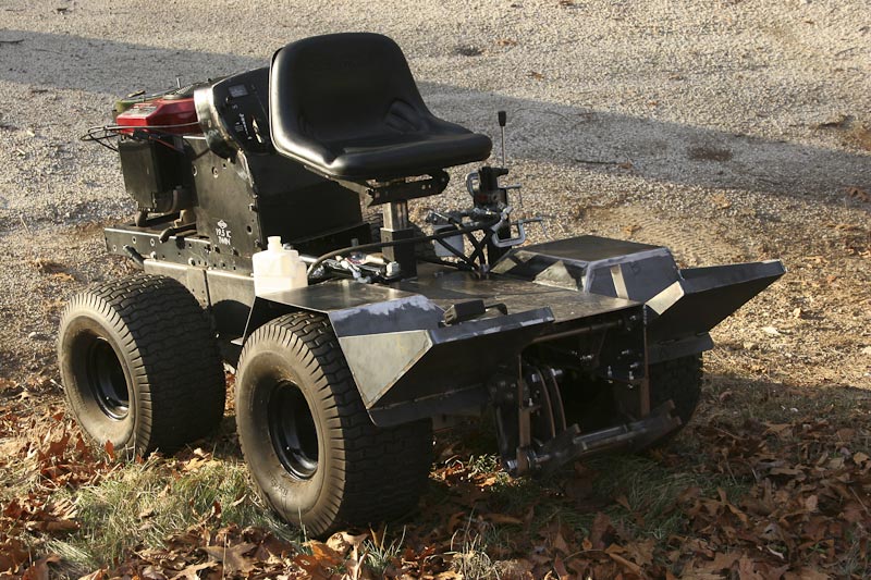

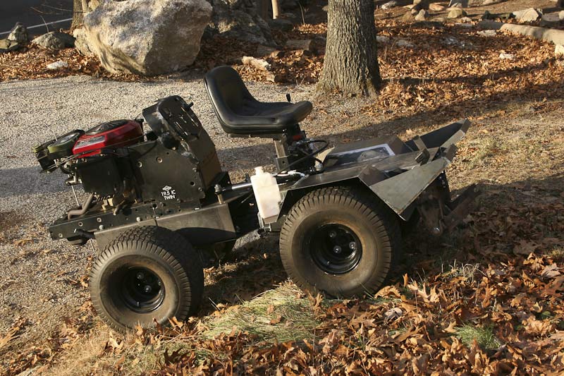

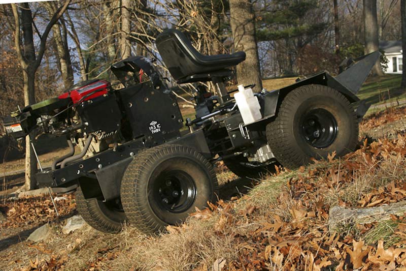

I lost my friends as helpers because of the holidays ,but I did manage to get the steering hydraulics plumbed up and managed a little test drive. I am happy to report that all my pulley alignments , tensioning and jackshaft setup works perfectly through full range of articulation and oscillation. I tried it out on the steepest hill in my backyard and it went right up it with no wheel spin. I was even able to stop midway and start again with no problems. I am trying to get it functioning enough to plow snow. It is very rough looking right now ,but I can work on the finishing touches in between snowstorms.

   / Everlast Power Plasma 50 #25
Evo,
When this thing gets finished, you could draw up plans and sell them. This is a serious DIY project that could grace any "popular" mechanical magazine. I know its a budget operation, but I can't help but thinking how nice some chrome ATV tires and wheels would look, and a custom rolled cowling for that engine would finish it off.
#26
The cowl I have is actually the hood from the Sears LT1000 that this started as. It will do for now but there is definately a new rear cowl and fenders in the works that will hold the dual battery setup and a 8 gallon hydraulic oil tank to run the loader that I am working on. I am desparately trying to get this thing up and running just to plow snow this winter. When it is not being used for snow removal I will continue to work on the fit and finish of it. Again thanks to you and Everlast the pp50 it has made fabricating parts as easy as cutting paper with scissors. The replacement torch has worked flawlessly and I will soon be calling you to get some more consumables . I use this thing to cut everything and my back thanks you. Gone are the hours spent with cut off saws and right angle grinders struggling to get some intricate shapes made.
