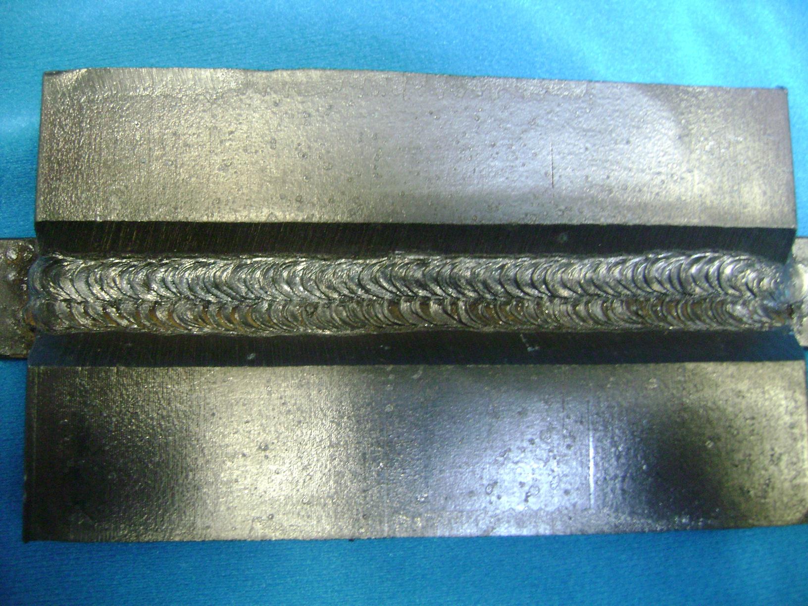

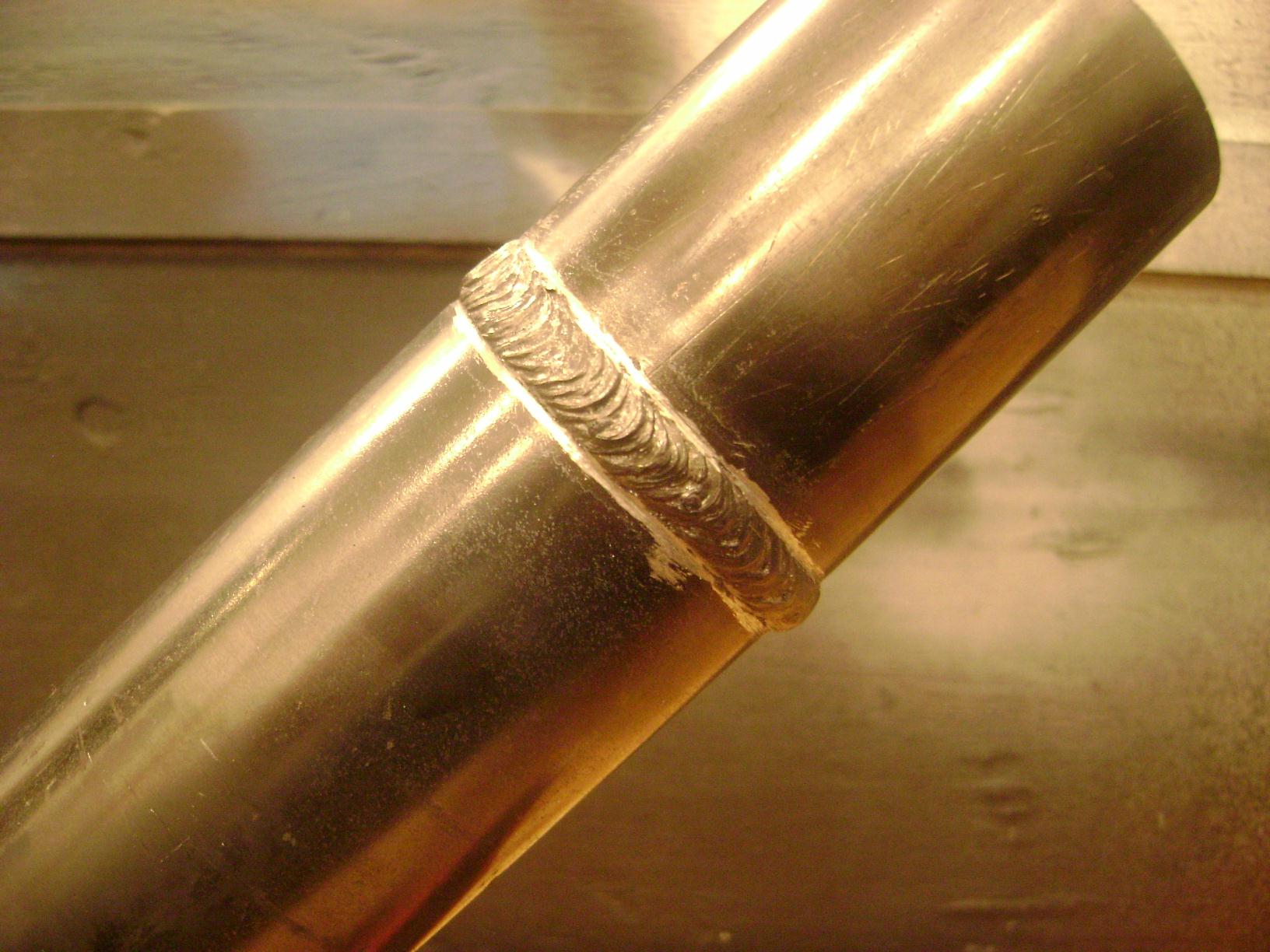

I don't know anything about the 140st, but I do know with the PA-200 once you get past the mind set of holding a close arc length it produces a great looking weld with 6010. I found out with my PA-200 it likes ESAB's 10P-Plus the best. I had a hard time convincing myself I could get a stack of dimes look with such a close arc length but these pictures show it can be done.
Mark do you have to hold a close arc length with the PA-300?
