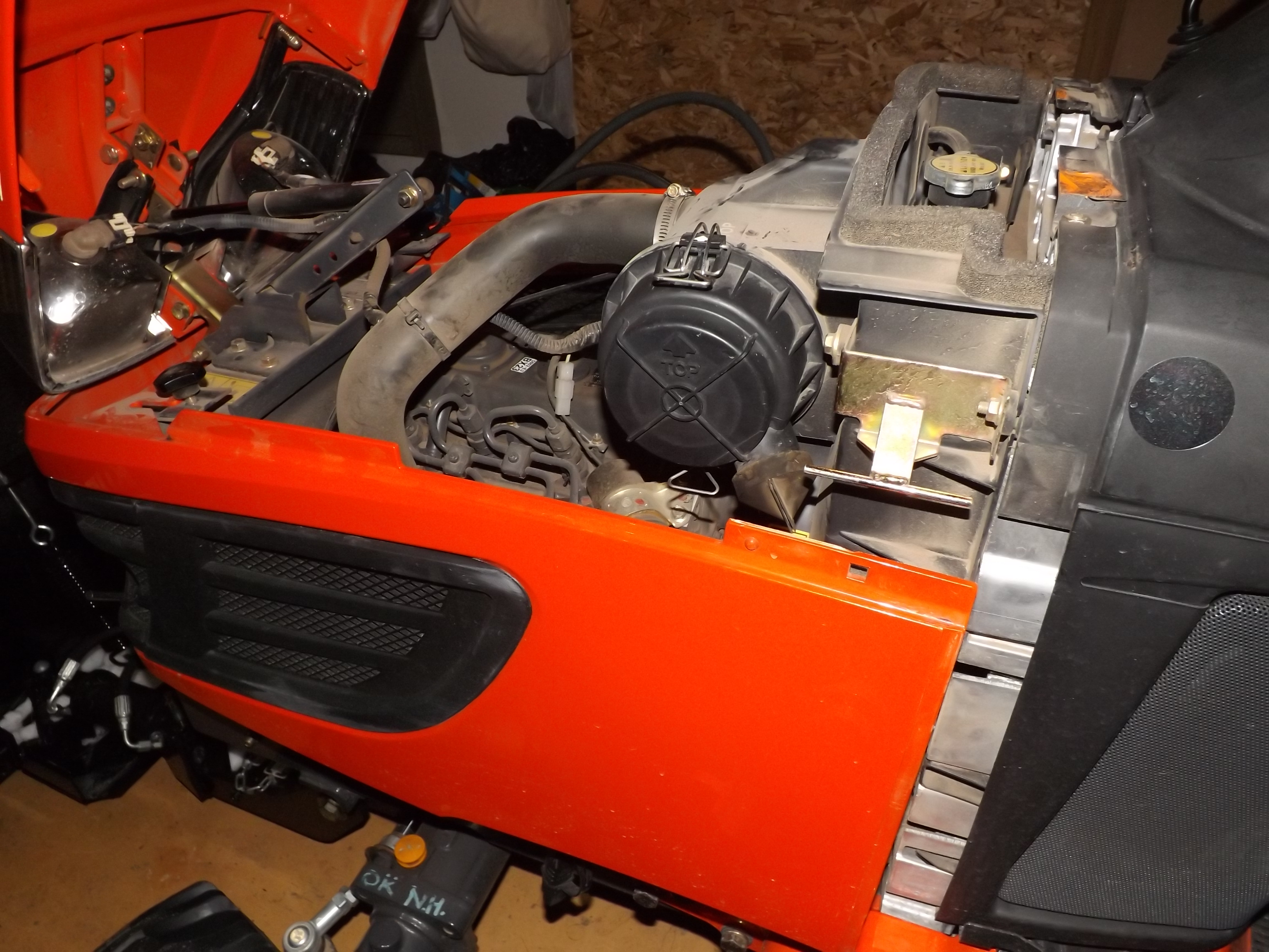

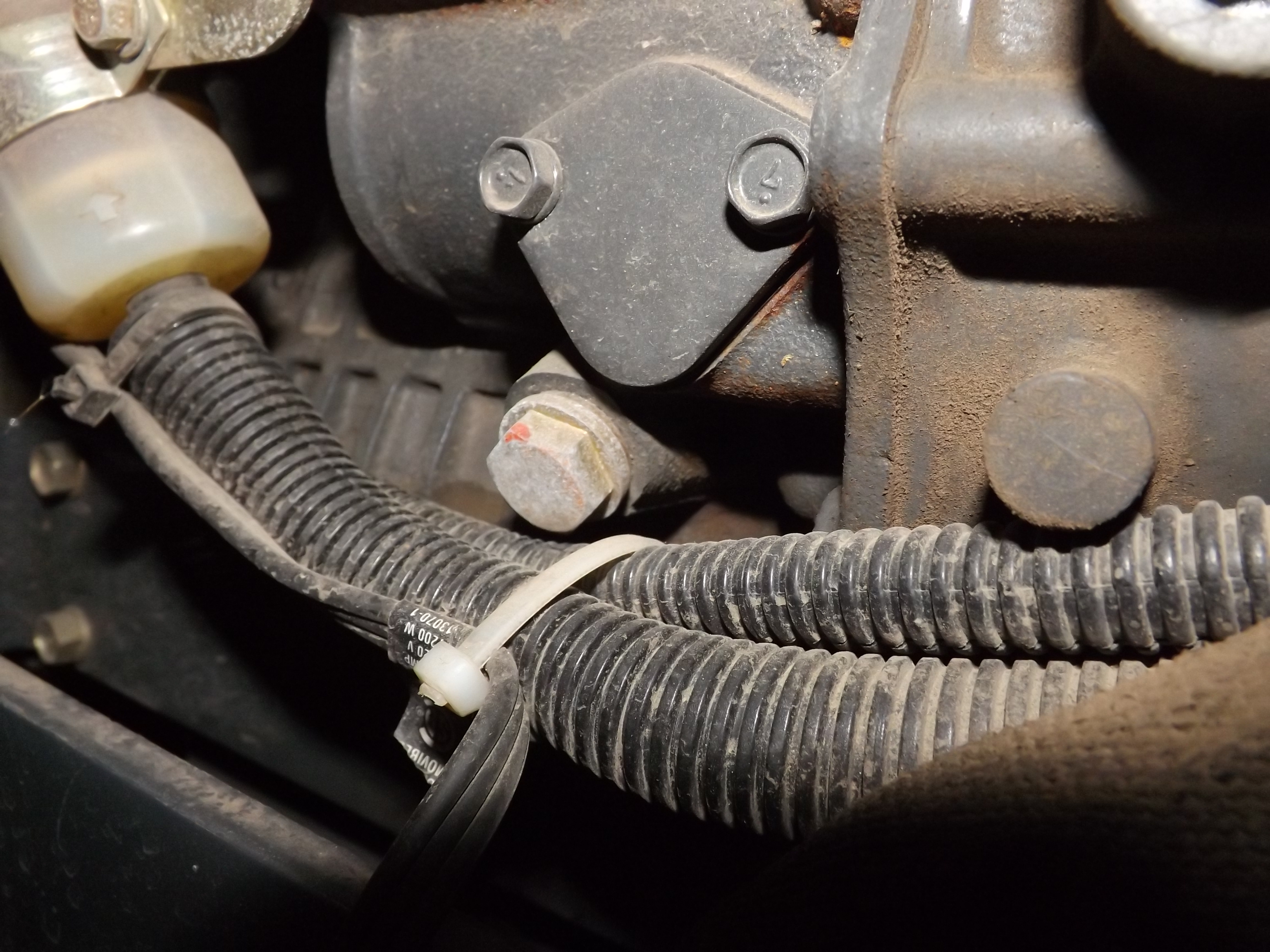

I was so encouraged by wotalota's post, I went out to have a look. Took my camera. Granted, I am in a weakened state, just home for the hospital and anesthesia, but that famous/infamous bolt wasn't hard to locate. It is on the port, (left when sitting on the tractor) below the hydraulics pump. My lines with plastic loom covering obscured the view a bit, but there it is. I didn't have a rag to dust off the head of the bolt, but even so the red paint is visible.
A photo for reference perspective and then the photo beyond the side panel.

Well I don't really know much more. Sitting on the tractor, it is on the left side low down. Look at the thread linked previously the images should guide you to it. Roger (rvcrawford) explained were it was and its purpose in that earlier thread. Pointing out hat you have to both drain at the lower hose and in order to also drain the block, remove the red painted bolt. It all checked out when I followed his instructions. It surprised me that something so important was not in the copy of the user manual that came with the machine. But tech writers are human so they say and these things happen. It seems clear to me that initially not knowing about the block drain left me with a mix of old and new coolant in the machine. Now if you do not find such a bolt on your BX and if the amount of fluid that comes out matches closely that capacity listed in the manual then perhaps there is a variant issue in the models.

It's an easy "find", wotalota. Thanks.
Now, some skeptics believed oil would pour out of that bolt. I'm inclined to find out tomorrow. But it is logical that there WOULD be a block drain on these 700-1200 c.c. Kubota 3 cylinder engines because A.) it was indeed on my B series engine (same as BX2660) and B.) Kubota sells a huge percentage of these same engines to marine applications where winterizing the block is essential and those engines often don't use a radiator as a tractor would. It is just stands to reason, in my mind anyhow, that the BX engines wouldn't have specialized engines with that port filled while the engine was being cast. Easier to just put a bolt into it allowing the engine to be sent to applications such as marine division or stationary gen set.
