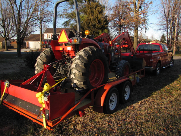

I have a DK45 SE and the first implement I got was a box blade. I have a 72" mower as well. My use sounds similar to yours, but soil conditions may be quite different. Mine is mostly used for grading trails that are surfaced with crushed stone.
I ordered the 72" but ended up with a 66" because the wait would have been long for the wider blade. I am now glad I got the narrower blade, it is easier to maneuver and very nearly as wide as the tires. (Close enough) I made some modifications to mine, there is a thread at Kioti DK45SE box blade/carry-all/trailer hitch/counterweight/top n tilt VIDEO

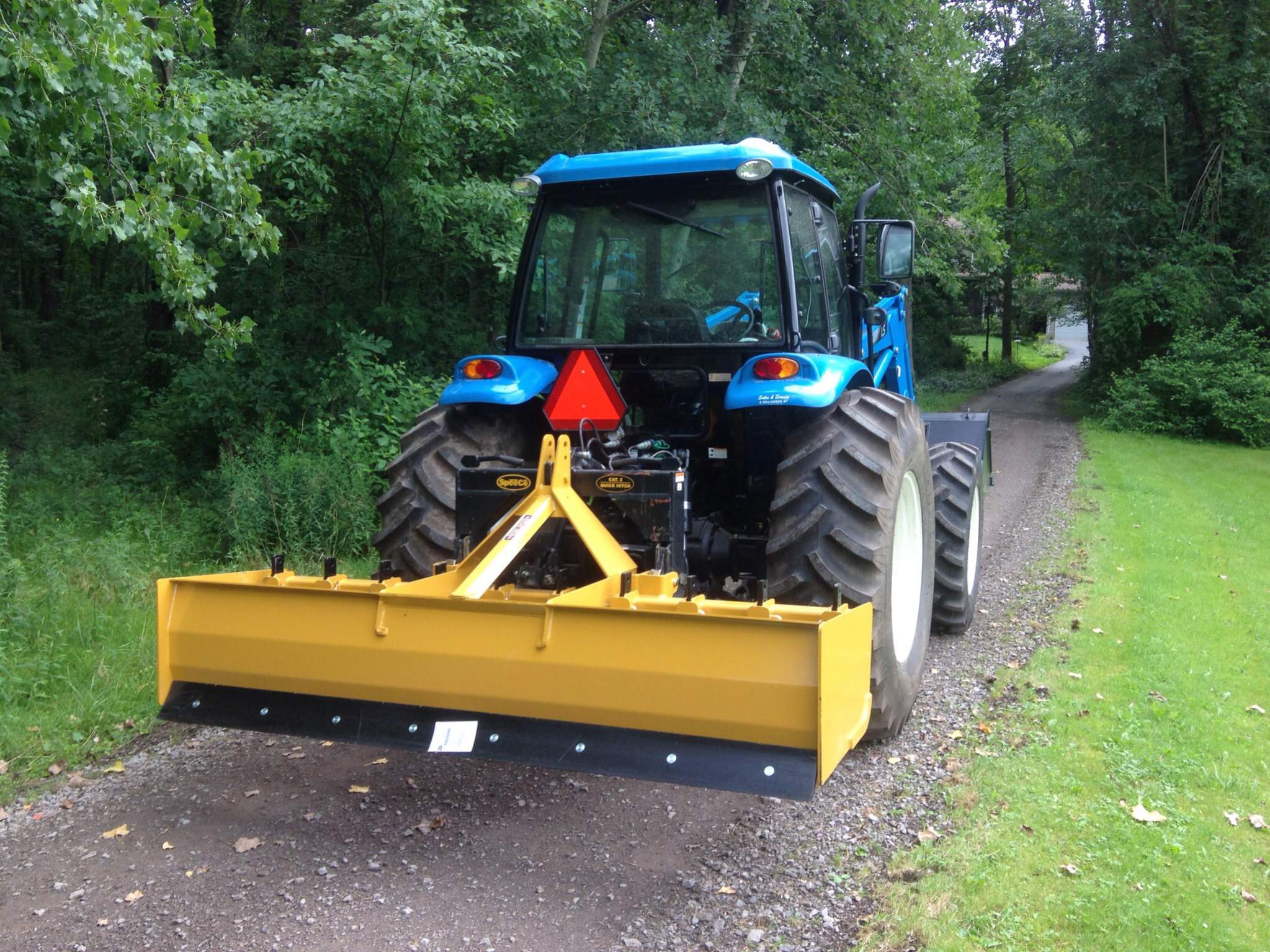

I bought a new BB with the second tractor DK40HST and love the box blade. It has the "clevis" style attachment which is stronger. Mine just had a sticker on it showing the model. I think my dealer said they are made in Illinois. This is the only picture I have of it.

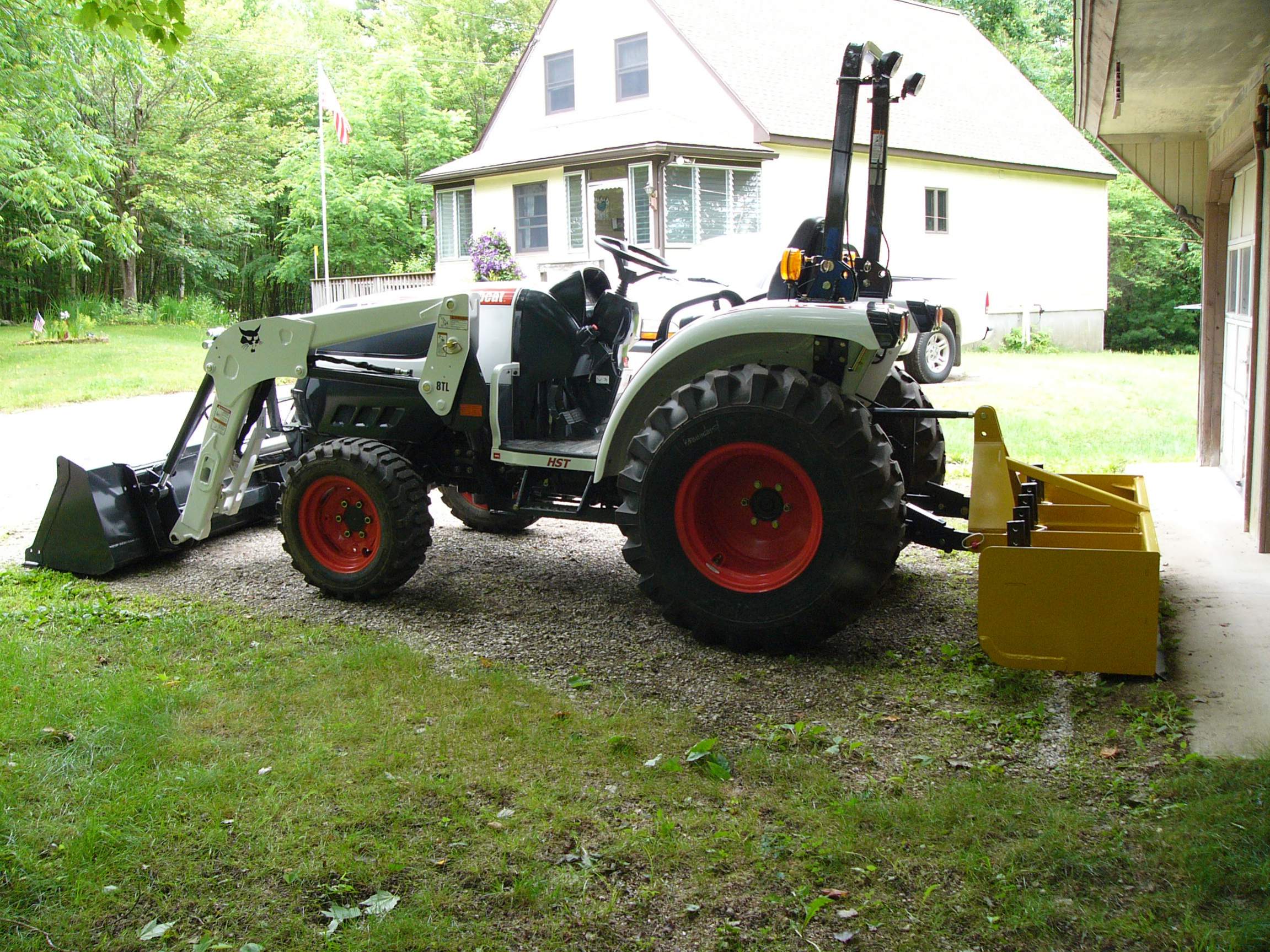

I have an EA 72" box blade and am very satisfied with it. Very rugged construction
and works well with my Bobcat CT335 tractor.
