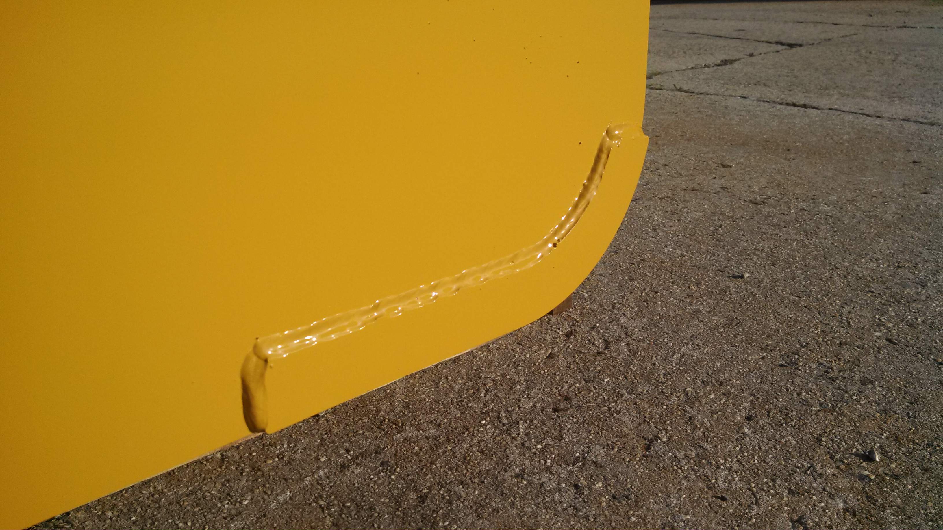

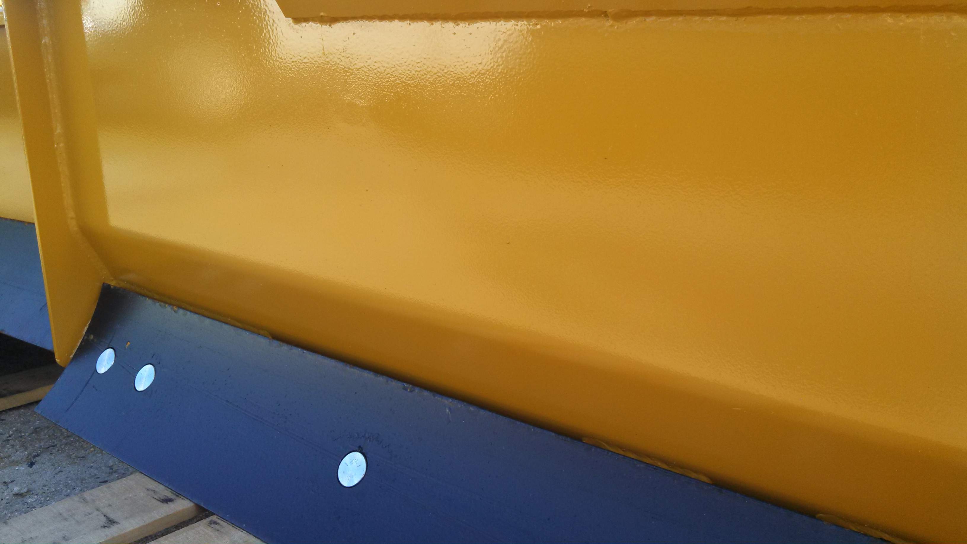

Both box blades have 1/4" side plates. We weld an additional 1/4" piece on the leading edge, where the most wear occurs. This doesn't add much to the weight, but greatly increases the lifetime of our box blades.

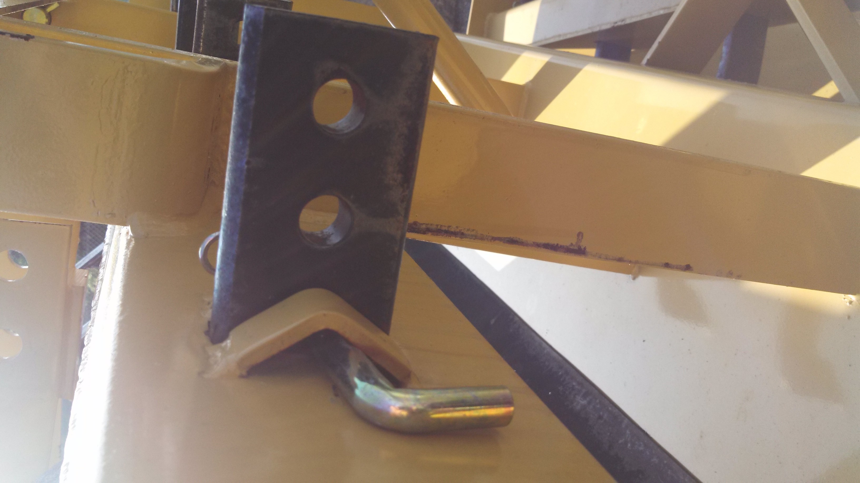

We have a more durable attachment point for the ripper shanks.
ETA:
United:
