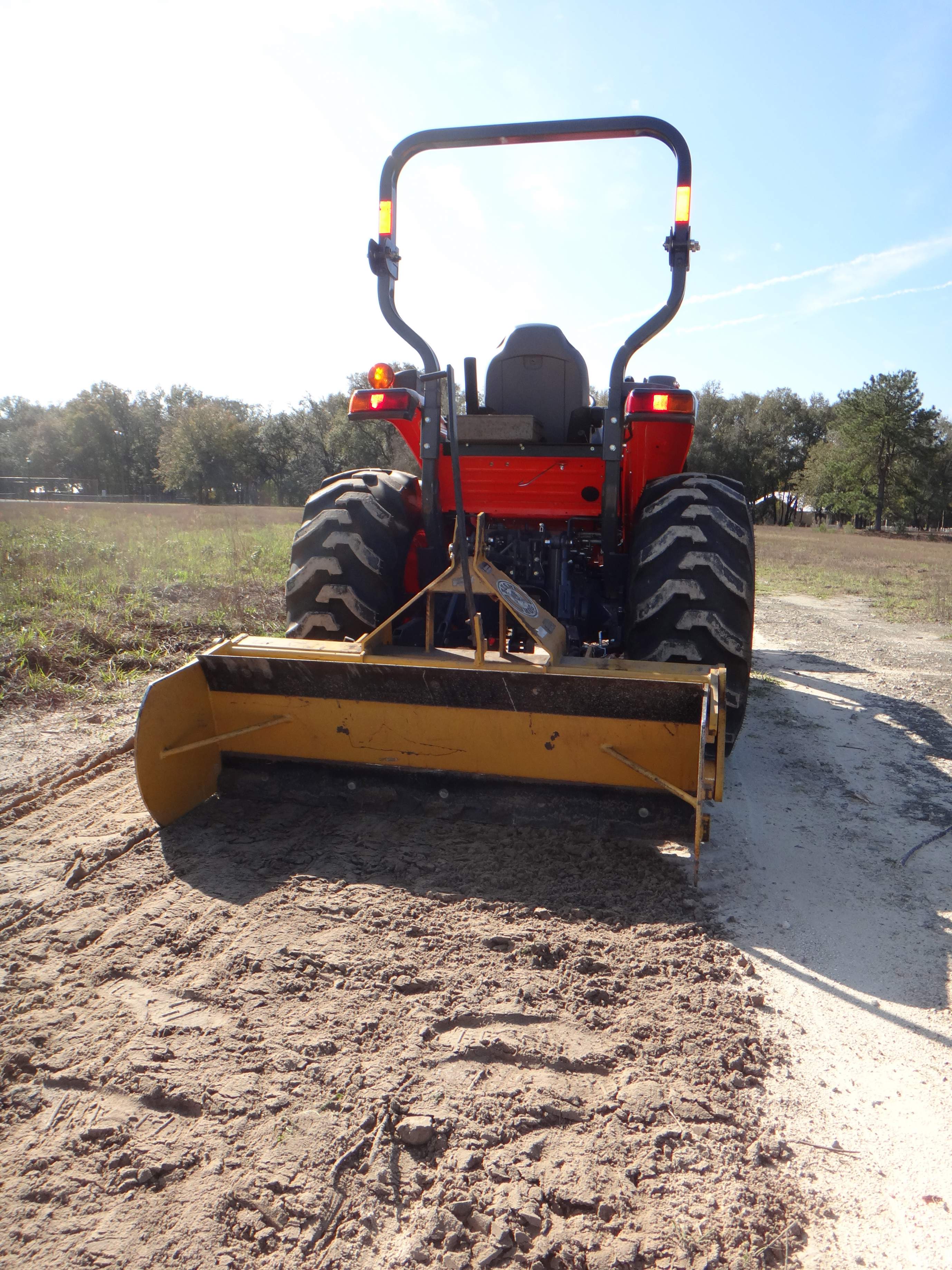

I purchased a 60" Bush Hog (brand) Rollover Box Blade, 630 pounds, when I had my B3300SU, essentially the same tractor as B3200. I liked ROBB so much I retained it when I sold the B3300SU in favor of my L3560. My L3560 tire width is 69" so a little tire track shows on each side of the box.
You want as much weight per foot of width as possible on a Box Blade, while retaining the ability to pull it with a full box of dirt. Gravity is all that acts on the 3-Pt hitch. You need implement weight to cut, preferably 100 - 125 pounds per foot of width.
If you do not have an FEL on the B3200, go with 60" for sure.
I have several ETA implements. I have been happy with all.
Photo #1 ROBB as ballast.
Photo #2 ROBB smoothing.

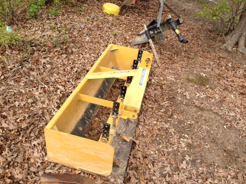

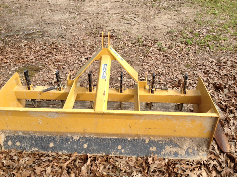

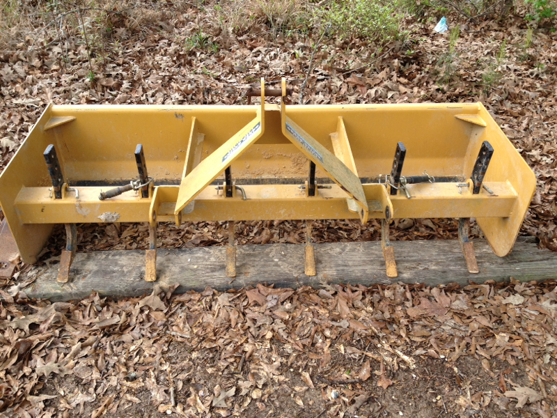

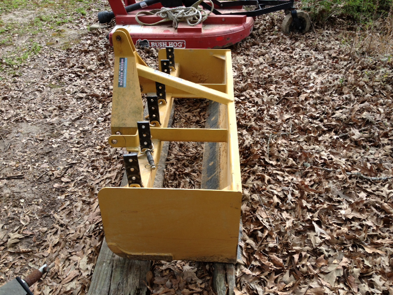

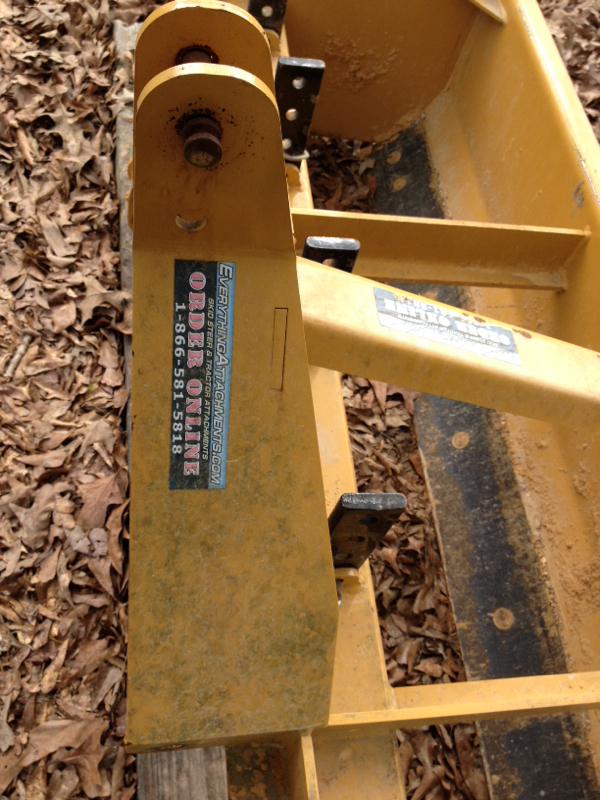

Ok here are the pics of my ETA grader box that's been sitting out in the weather since I received it on 09-21-12. Today is 04-01-2014.
Today is April Fool's Day. But people would be a fool if they think ETA attachments are no good or if buying from a long distance is not worth it. This is no JOKE. LOL!! (please don't take offense)
I'm 100% satisfied with my box, and the people who handled the sale and transaction. I will buy from them again in the future. There's a couple attachments I have in mind that I've wanted for a while.
