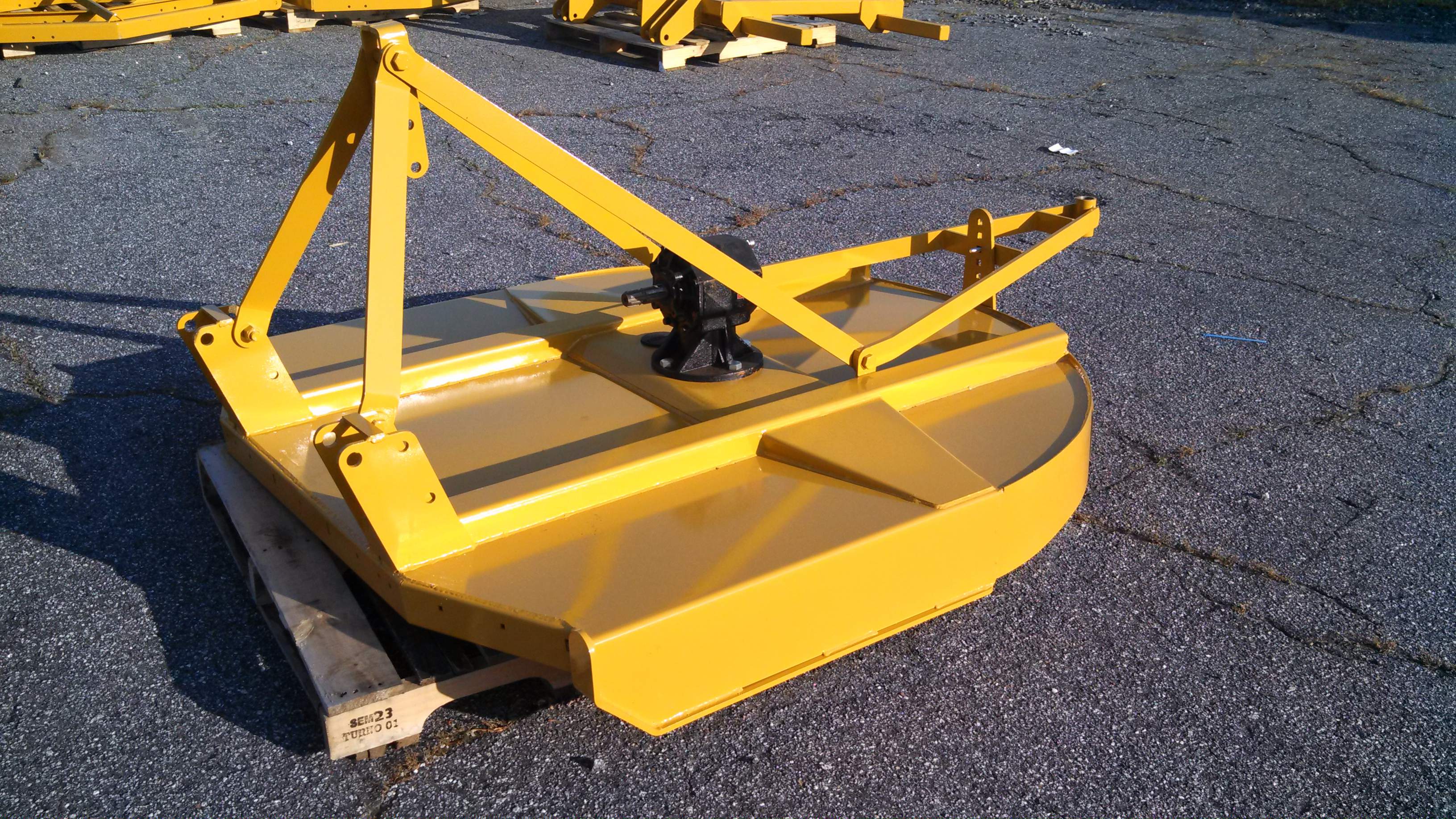

I like the fact that everything is welded solid:thumbsup: I hate stitch welding. I cannot begin to count the number of things that I have fixed or worked on over the years, and when fixing up, I will weld solid. Most notably the older style meyers ST and C plows. I HATE stitch welding. While a full weld may not be required for strength. I think the real benefit is sealing everything up. While the support ribs on snowplows and bushhogs and other stuff are pretty thick steel and likely to never be an issue, if stitch welded, everywhere there isnt a weld is a place for water and dirt and debris to lay and rot the thinner metal skin that it is attached to.
For minimal additional cost, weld things solid please.

I,m not familiar with the term stitch welding, is this considered stitch welding?
Yes, in the context of this thread that is stitch welding.
Pretty much anything that isnt welded solid all the way around. Allows lots of tight areas for water and debris to collect and work on rusting stuff out. Not to mention in the areas under the braces isnt likely to have any paint.

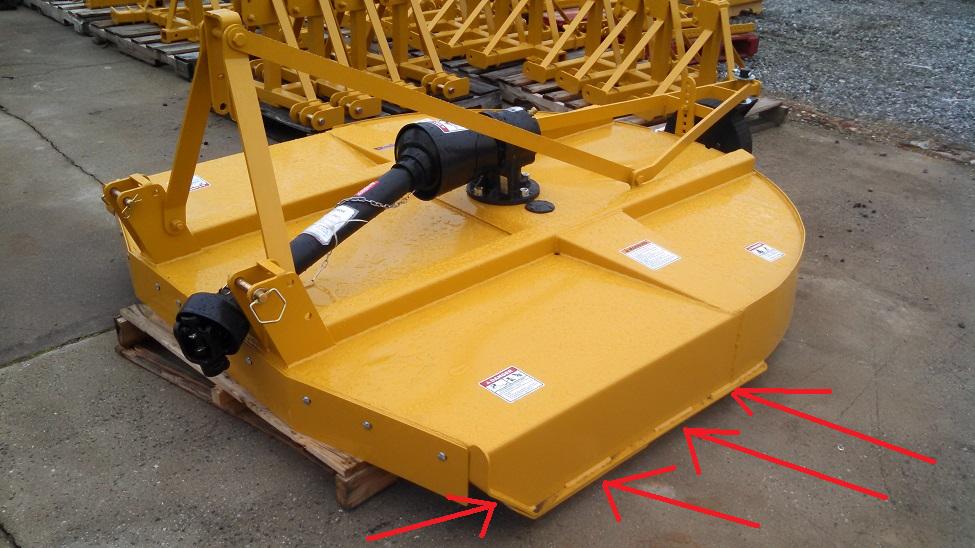

Better. Tail wheel assembly still looks weak.
That's 1/2" steel and the assembly is identical to the Land Pride RCR1872. Not weak IMO.
Yes, the outside of that skid is stitched, but the full length of the inside is a solid weld.
I just checked the LP. It is stitched on the outside and not welded at all on the inside.:eek:

Why did you choose not to weld that solid on the outside?
If you look at any old piece of equipment (assuming a quality paint was used), The places that always rust are where two pieces are joined together but NOT welded. Moisture will get in that area, and never dry out, and do its thing and start eating away at the material from the backside.
What would it add, $5 in production cost to go ahead and weld that solid?
The better question is....Why did Land Pride choose not to weld anything? Most importantly, on the inside!!

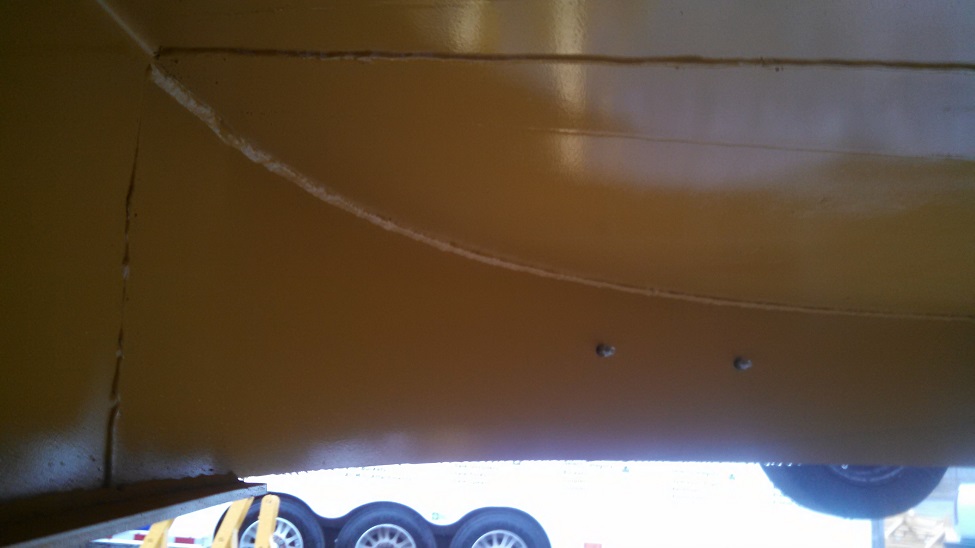

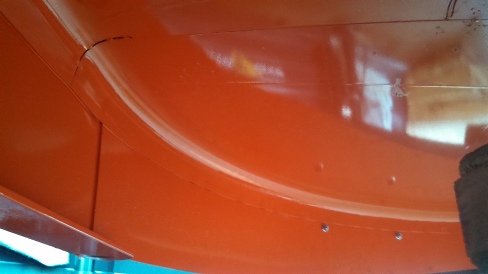

Here's a little comparison.
Underneath
Here is the LP. See the splits across the top, around the back and down the side. Notice that there is no spot welding, no stitch welding and definitely no solid welding.
attachment.php
Now the ETA. Wow, all Solid Welded.
attachment.php
Thumbnail pics(in case the others don't show up in your browser)
LP
ETA

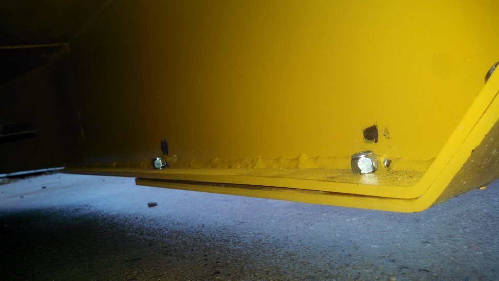

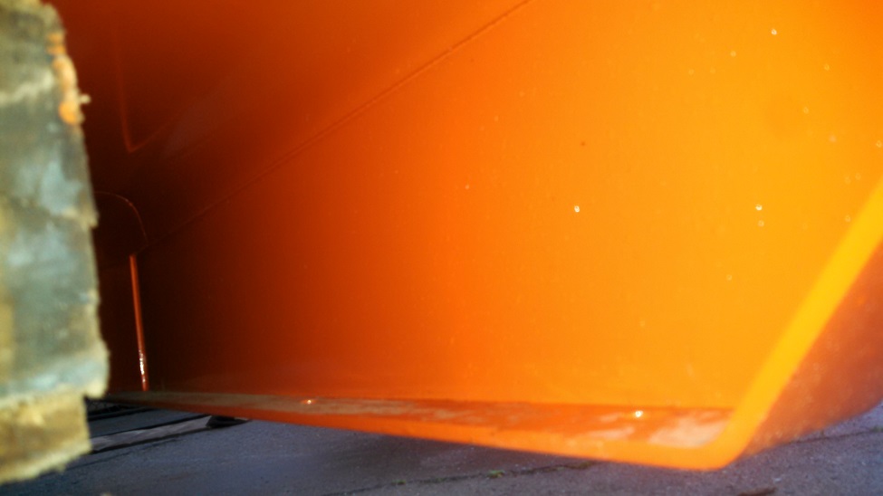

Skids(inside)
LP....NO welds.
attachment.php
ETA....Again, Solid welded. Also, notice the standard bolt on skid shoe in addition to the welded one. LP offers an optional bolt-on skid that can be ordered from the parts dept. for $44(plus shipping)
attachment.php
Thumbnail Pics
LP
ETA
