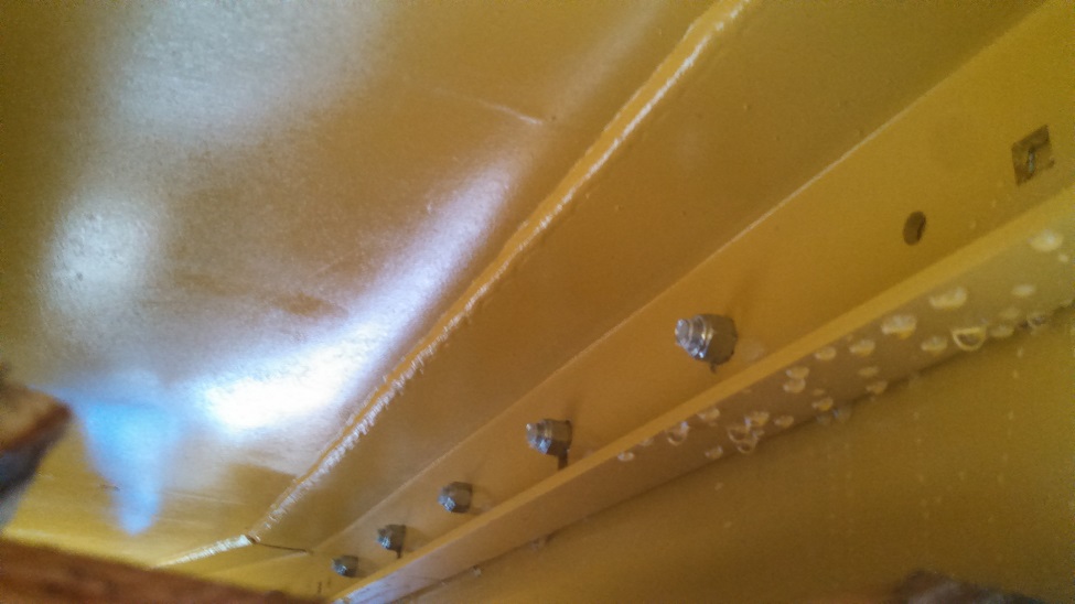

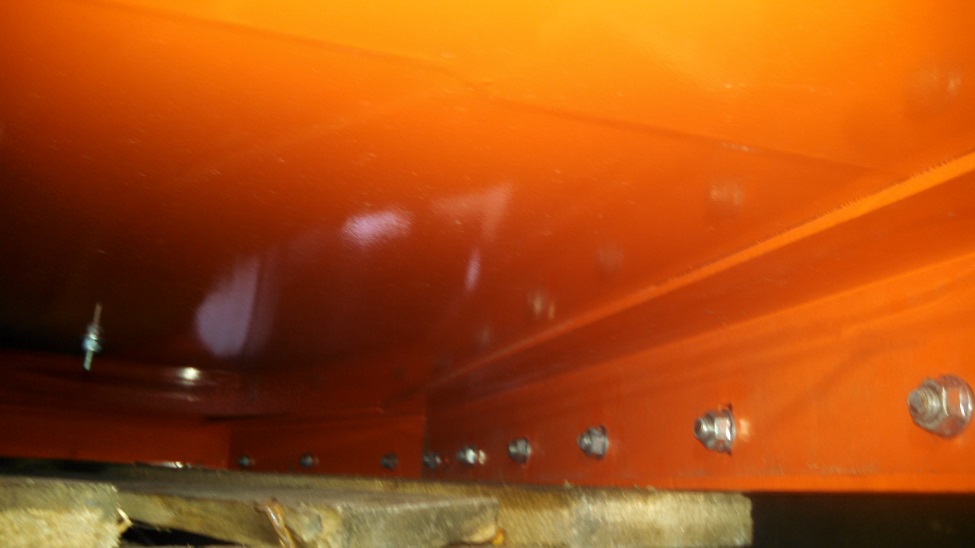

Underneath the Front
Land Pride....Once again, no welds.
attachment.php
ETA.....Solid Welds
attachment.php
Thumbnails
LP
ETA

Not sure if it is just my browser/internet. (been acting up lately) but the pictures didnt show up.
There is no doubt that the ETA design with more weld is better than LP with alot less weld. But why stop there. Why not just go ahead and make it a solid weld for little more cost.
I know I am splitting hairs here, and given the thickness of the material it is likely to never be an issue in that case. But like I said, I see far too many things rot out think gauge decking under heavier supports that would have never been an issue if welded solid.
I added thumbs, so you can click on them to see. The larger pics do not show up on some browsers(including my phone).
I do not know the reasoning on the outside of the skids, but ours blows the orange one away. Our skids are solid welded on the inside and stitched on the outside VS only outside stitches on the LP.
We knocked this one out of the park. I just wanted to outline the extra value that is packed into this cutter.
****Same goes for the 60" and 48" models*****

I dont always follow all of your products or builds. But a question: Are you guys welding all these by hand or by robotics?
Like I said, either way I dont think it would cost much to just go ahead and weld that outside solid. I am not a fan of stitch welding ANYWHERE other than something that is temporary. May not be an issue for others. But is for me.

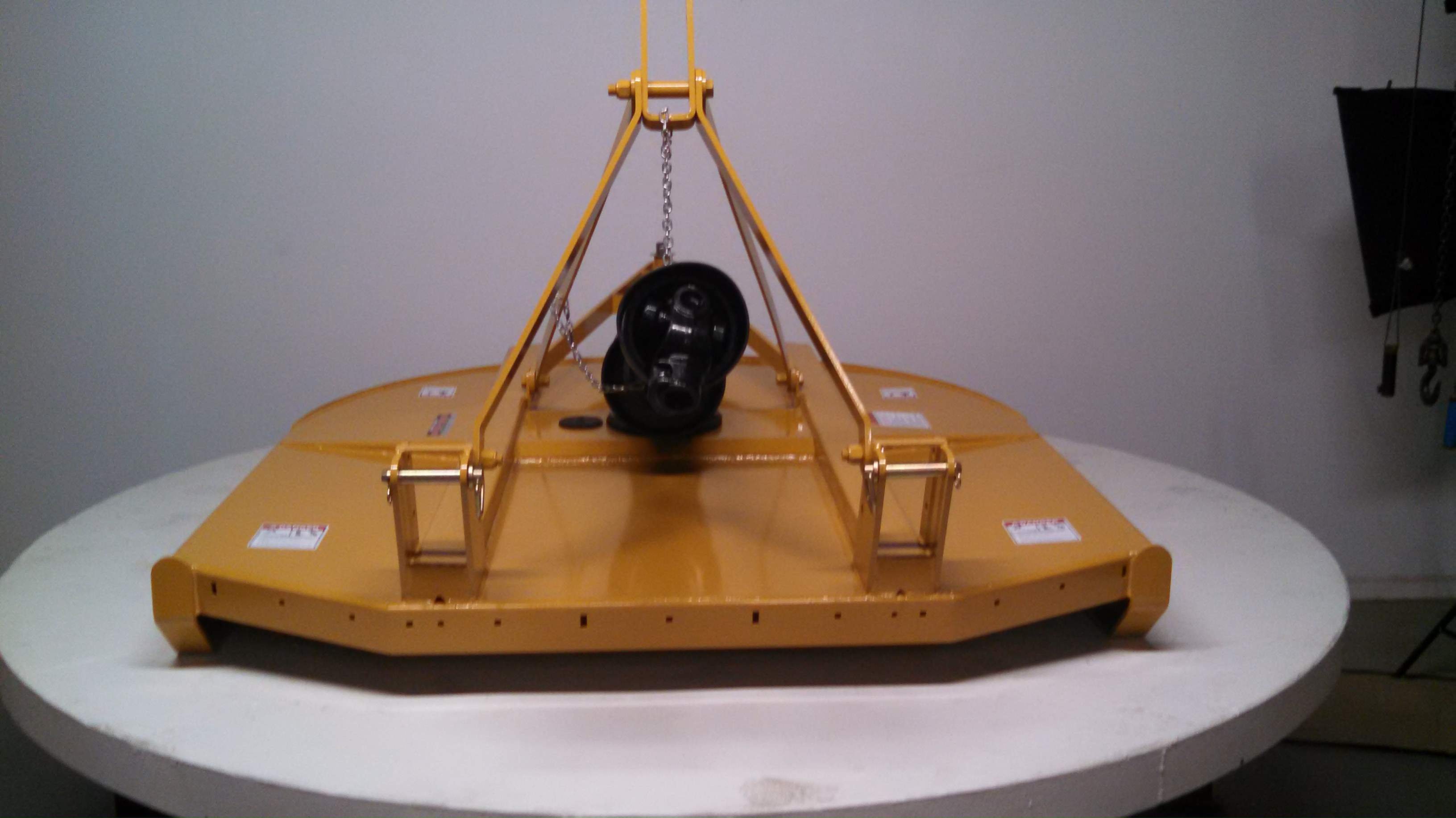

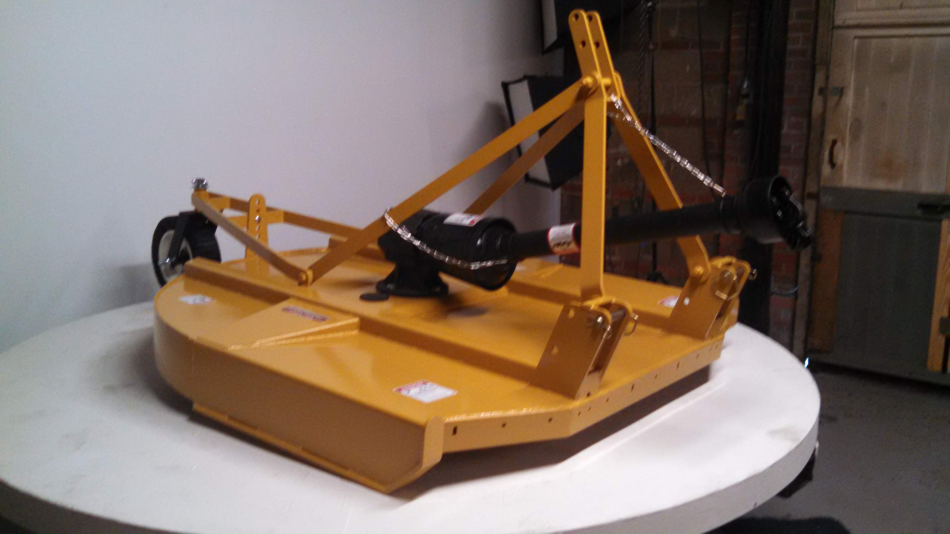

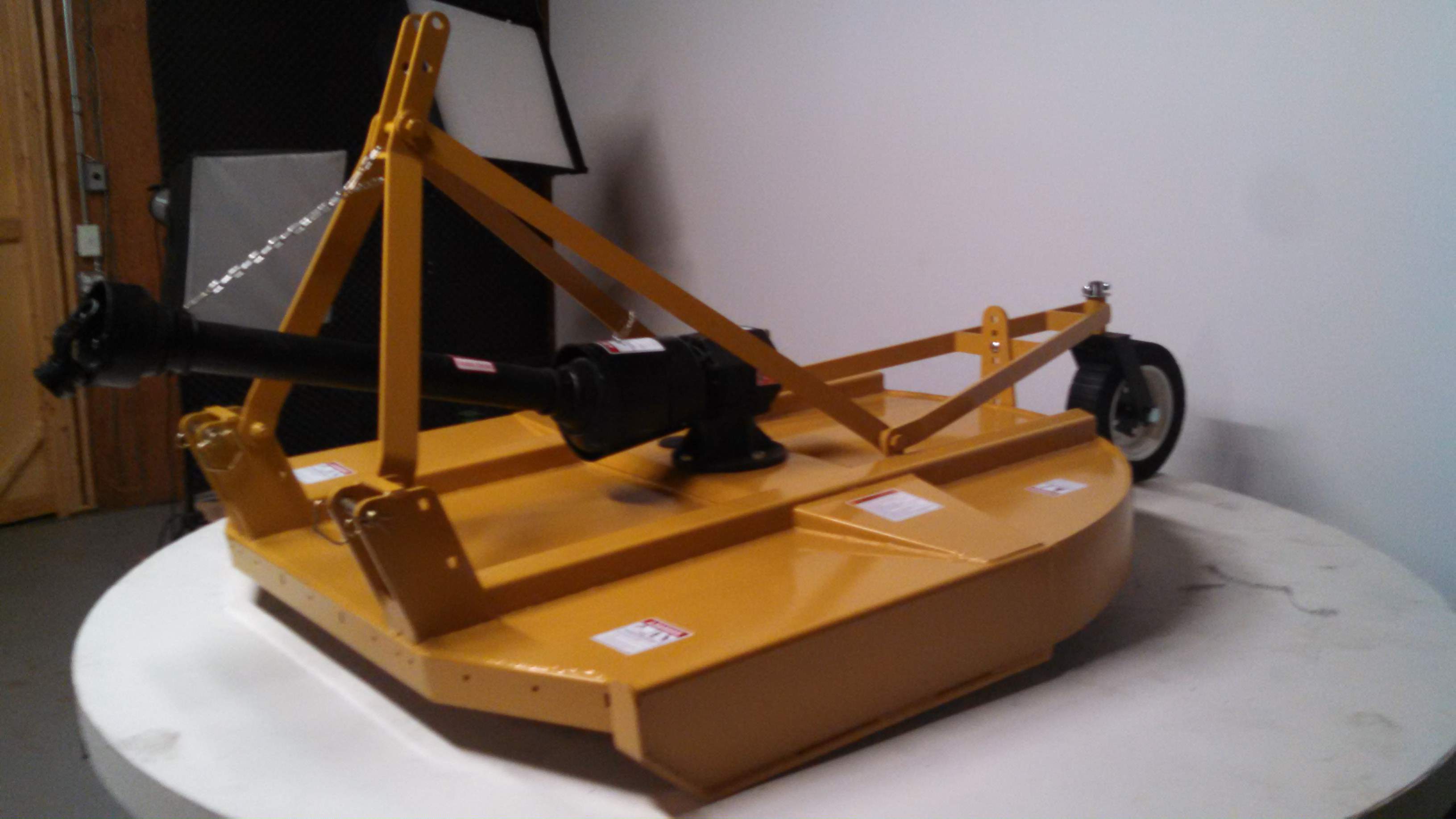

The 72" ETA Brush Cutter is now inside and ready for glamour shots. They're getting ready to shoot the video, so I'll post it soon!
Travis
attachment.php
attachment.php
