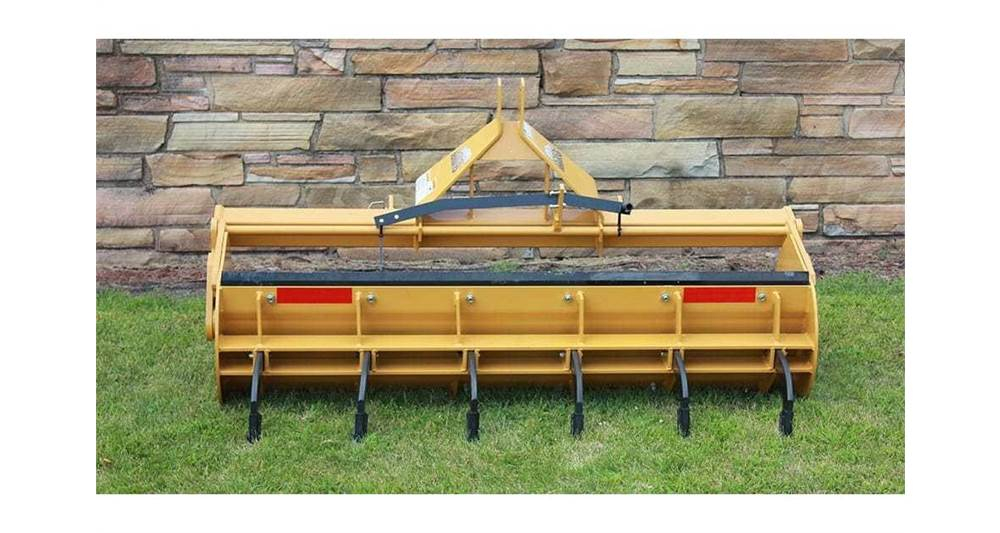

I prefer a back blade over a box blade by far for driveway maintenance. With a back blade I can rip a good sized ditch, spread the spoils out or move them sideways out of the way. I can countour a slope or crown a driveway. I can create a shallow or a good sized waterway. It will also windrow rocks a bit while blading with it angled.
The only thing it doesn't do good at is to move material from one location to another, but that's what my bucket is for.
I have both back blades and a box blade, I would say I use the back blade 10 times or more over the box blade.

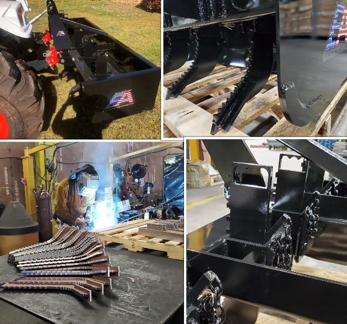

Tractor Box Blades, Taken Very Seriously​
At Everything Attachments, we take everything intended for our customer's tractors seriously, and our experience with box blades goes wayy back in time. You see, prior to ever making, or even thinking about making an EA box blade, Ted used many other box blades, spanning from his childhood up through his adult years, in which he used, tore up, fixed, and sold about every brand in existence. Knowing how to use an attachment, and knowing how the attachment should perform under a large variety of circumstances is very important when designing the best attachment. Besides knowing how the overall design should be laid out, knowing the best materials and structural features, along with what material to use where, is very crucial. Because of all his experience, Ted has created a very impressive lineup of box blades, so we can recommend the BEST box blade for small, subcompact tractors, up to 150+ horsepower machines.
Proudly Made in the USA!
Find the full lineup of Wicked box blades here: XTreme Duty Box Blades, Box Scrapers or Grader Boxes For Tractors By Everything Attachments

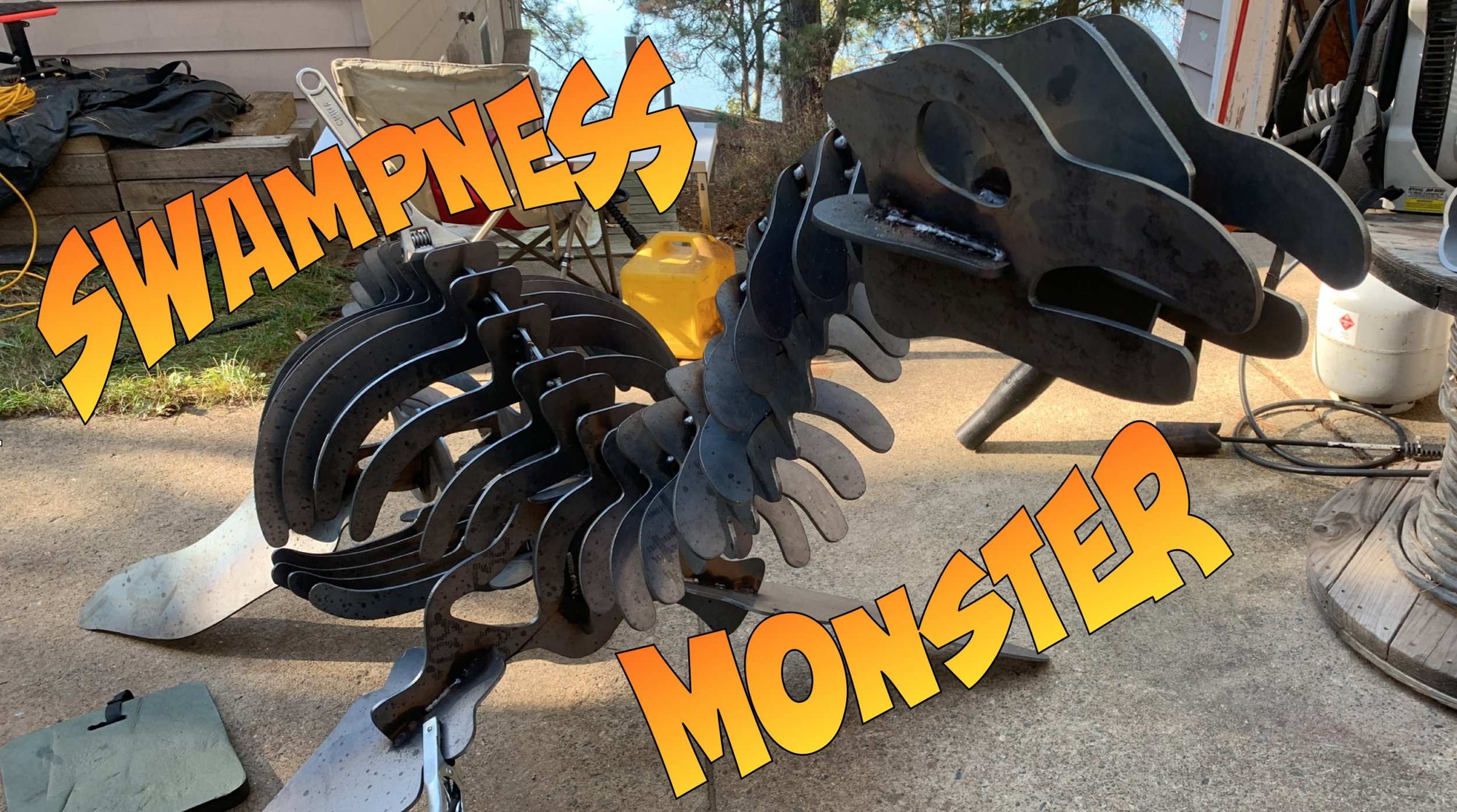

Send me a set of your shanks. My box blade uses the clip retainer style, Travis. AR400?
