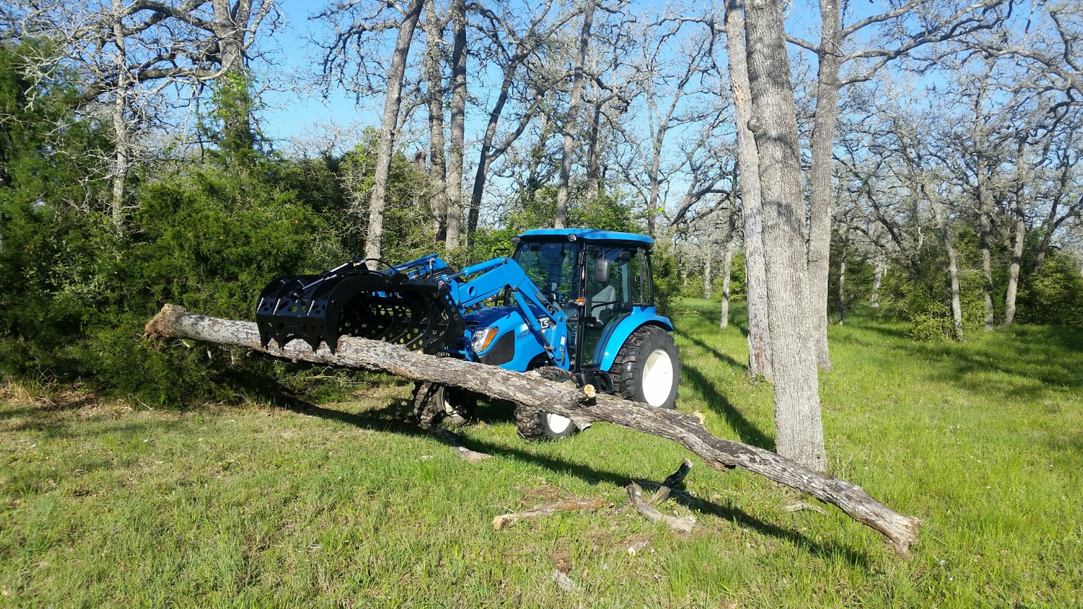

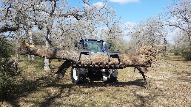

Oh my! The ole single vs double lid debate.
That's a subject that has been argued about for days without a definitive conclusion among the TBN masses!! :laughing:
Personally, IMO, I prefer single on a smaller grapple and double on a larger one.
A double lid will clamp tightly across the width of the grapple, which is more efficient than a single on a tremendously off balanced load.(my first pics will illustrate)
The cylinders are Teed together, so the fluid goes to the path of least resistance until it's tightened fully.
BOTTOM LINE: A grapple is one of the most useful investments for a tractor. Just make sure it's a WICKED GRAPPLE!!

Single lid grapples will have a somewhat faster cycle time because the fluid is only being sent to one cylinder. You can also clamp/pinch something right in the center, rather than to one side or the other.
I've got awesome pics showing what single lid Wicked Grapples are capable of.
This is why the great debate is forever ongoing!!!
yep, all of these are single lids

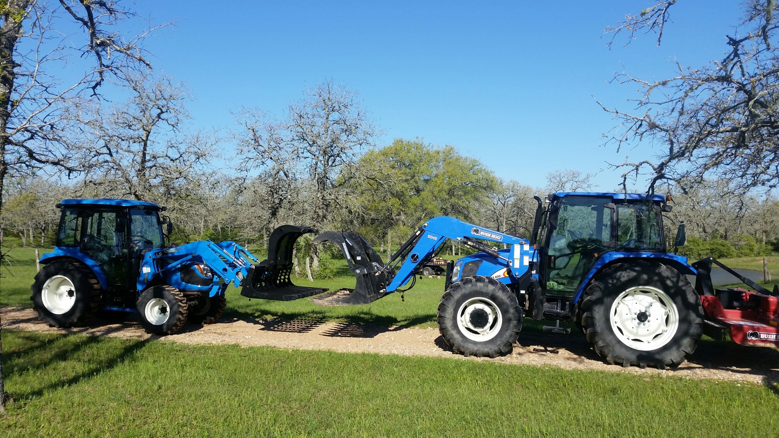

Or get one of each!

That is such a well composed photo. Like two giant prehistoric blue beasts squaring off to fight one another.:)
No doubt....I should follow Rick's advice and just recommend both from now on. It will take less explaining on my end and we'll sell twice as many grapples. :laughing:

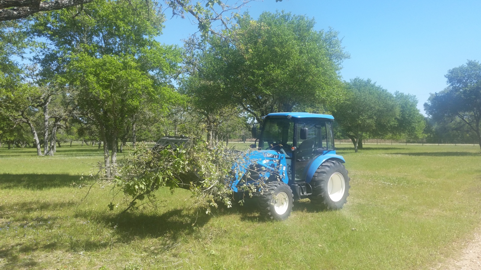

Yep, big tractor (96 HP) with 84" dual lid for pushing over / picking up dead trees and small tractor (46 HP) with 72" single lid for tree limbs and brush. They work well in tandem. The 72" is a EA Wicked For Utility tractors. Excellent product, well built. Just between us, it has pushed down some smaller trees in places I couldn't get the big tractor into.

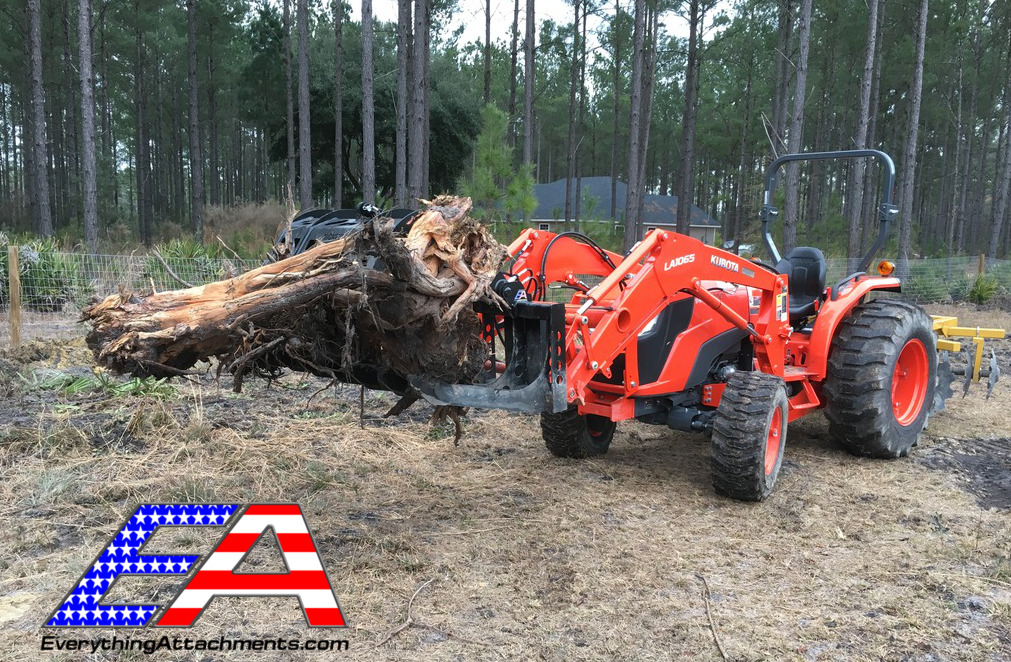

No worries. It's tree push tested, trust me!!
Travis
Here's proof. The grapple being punished is the dual lid version of yours.

Travis, no disagreement here. I know I could put the 72" wicked on my big tractor and go crazy.
As you might recall, my rationalization, for a second grapple, was the 42"+ jaw opening. Makes it excellent for brush and tree limbs. The 84" only opens 34".
