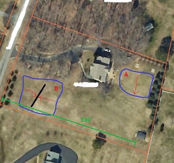

So I am looking to level out my backyard a bit. It is a 2 acre property and I would build a retaining wall where I am cutting into the ground. Here is an aerial view:
Section A is where I will be taking the dirt and moving it section B. I also want to level out the dip in section B (arrows) The black line in section B will be a 80' 12" pipe for drainage from the tree area to the neighbors yard. BTW, I have never seen any moving water in that area - even in the heaviest rains, I think it is a "just in case". The green line that is 350' is going to be a driveway for the detached garage I am planning to locate where the shed is currently. (Shed will be moved)

I think the "right" tool would be an excavator plus a bulldozer or a large front-end loader to move the dirt from "A" to "B".
If Area "A" is roughly 4' x 50' x 50' of excavated dirt that is 370 cubic yards of material--about 23 tri-axle dump truck loads--which makes me think the tractor isn't going to dig, move, and grade out that much in 2-3 days.
If you have never seen surface water running across Area "B", I wouldn't put a pipe there. Can you live with a broad gentle dip in the driveway, enough to let any water across? It generally isn't nice to concentrate and direct water flow to a neighbor's land.
Will you be permitted to have a second driveway? See what the retaining wall will cost before creating the need for one. :) You might be shocked.
Do you have surface water running to your patio from Area "A"?

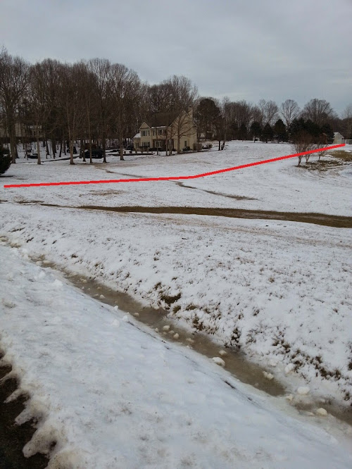

Thanks for all the responses! Seems the biggest question is the pipe and water run off to the neighbors. That is not an issue.

Here are two recent snow shots that show the melting snow and where the "natural waterway" is. This is where I would put the pipe so that I am not actually changing how the water runs currently.
Where the pipe would go as marked by the arrows:
