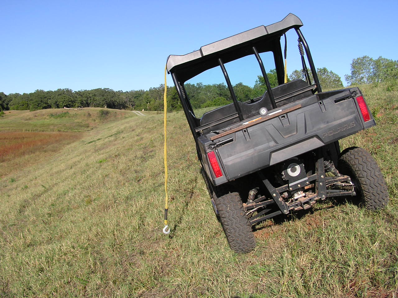

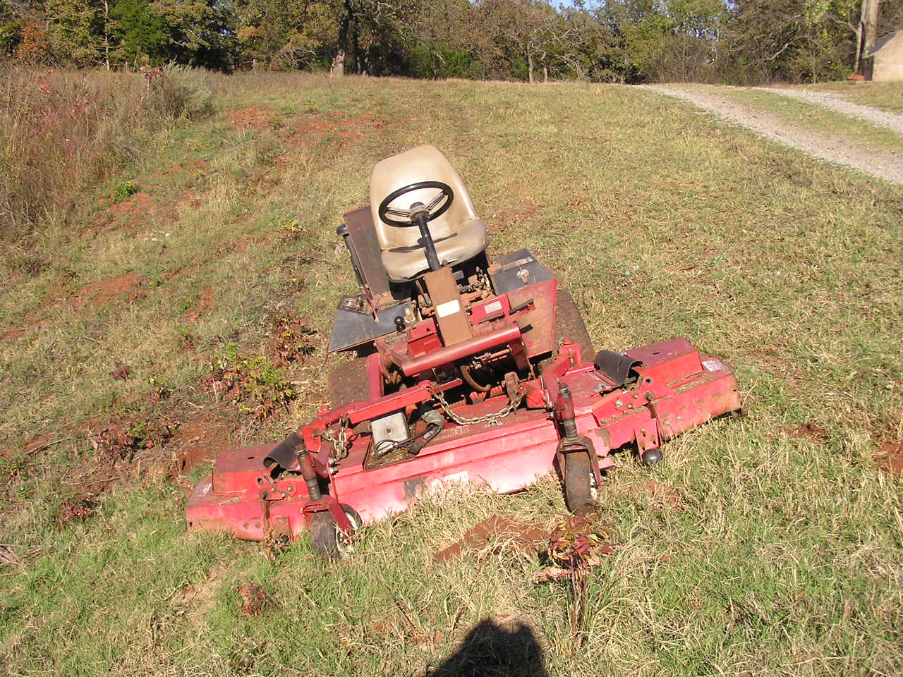

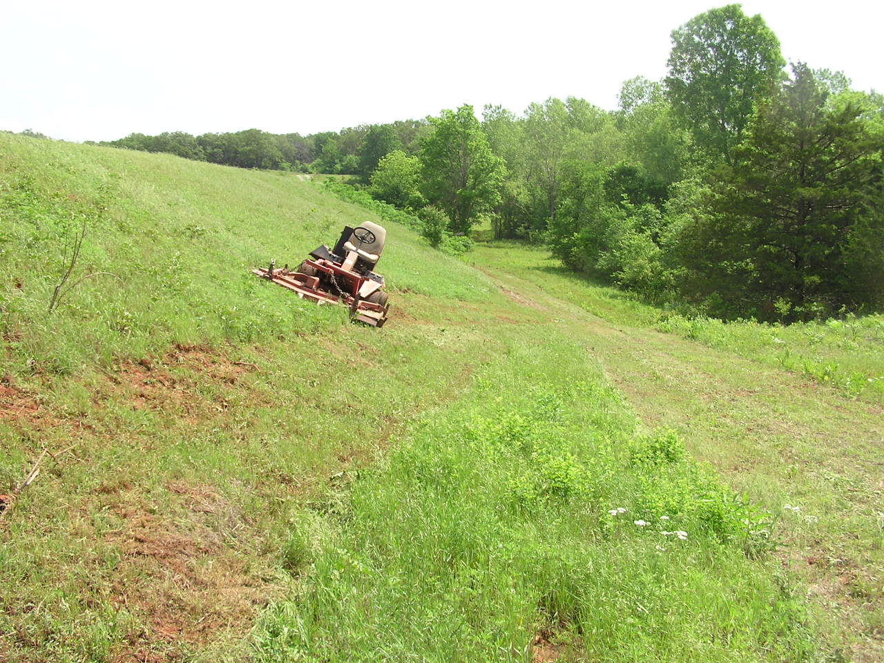

3:1 is pretty unfriendly feeling, but if your careful you can do it, 4:1 (four feet horizontal to 1 foot vertical) still feels steep but you can easily mow or drive on it. It feels steeper than it is. I don't think a dozer will "stick" to a 2:1 cross slope but can go up and down, if that helps give a reference point.
Steeper than 2:1 and you'll be pegging sod, and mowing with a weed eater
I agree, 3:1 was a major pucker factor the first time I mowed it.
The hanging tow rope shows true vertical.
This side is 2:1 and the mower slides sideways downhill a lot. :eek:

Whoa! Yeah - not liking the 2:1 :shocked:
In reality my total height differential is about 4.5-5 feet. My thought was to not side hill mow but up and down.
/ Excavating/grading question #60
Down should be super easy with the 2:1 lol. Up should be fine also, far more likely to spin out than go over backwards.
