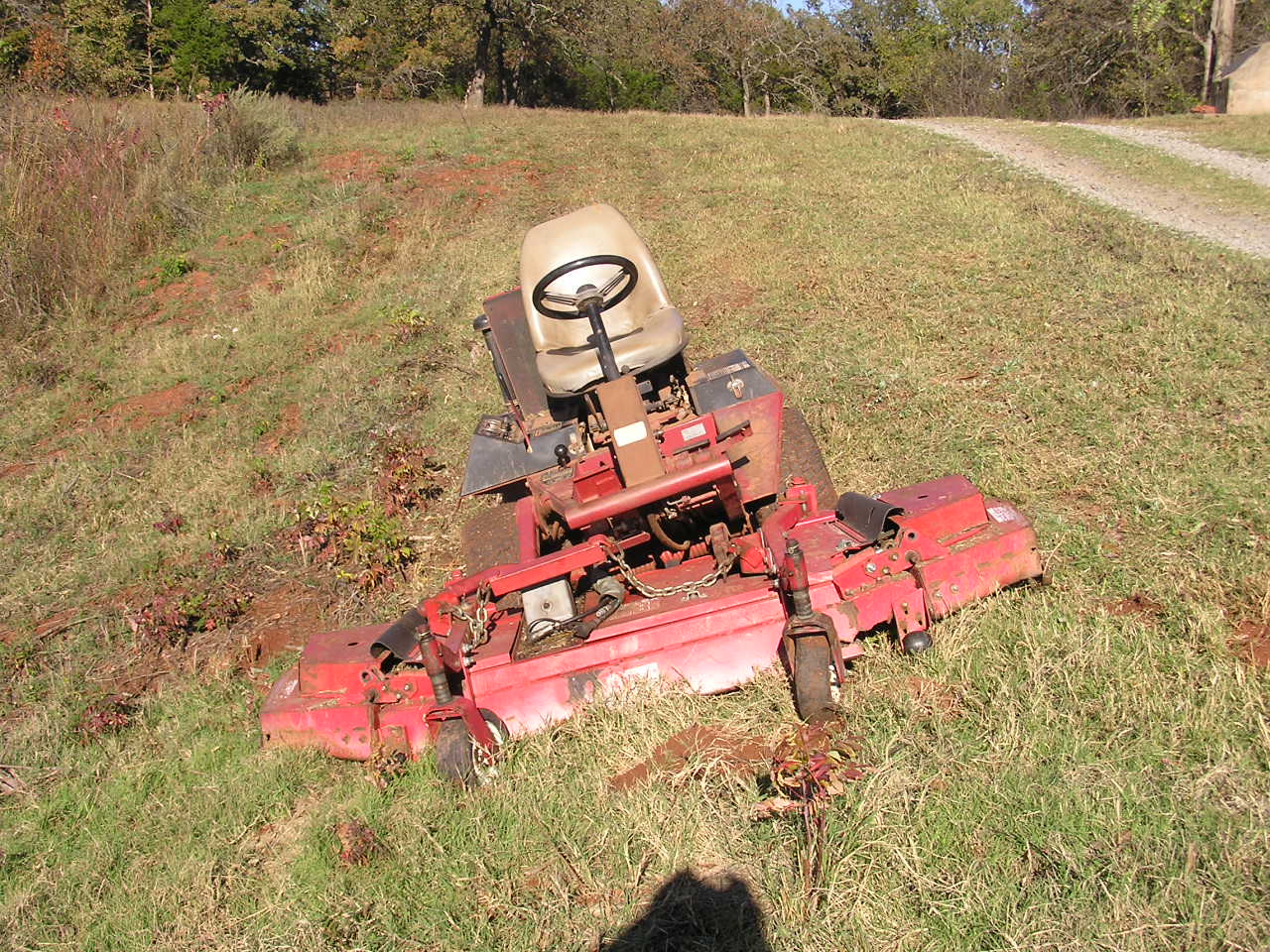

So I have been thinking more about the 50-80' tiered retaining wall and the associated $$$ with that... How about I make most of the wall a hill down from the upper horseshoe pit area to the "level" area. Have the grade be "smooth" enough that I can mow it. Like the following:
Below is a rough drawing of the hill idea. The green is existing railroad tie wall. This can be seen in the other pics in the thread. This would be replaced with stone. The yellow is the new proposed wall angled out into the hill. The red is where the "grassy hill" would start. This way I say money on stone and still have easy mowing.
I wonder what grade I can get away with using my Bobcat ZT mower and how long the "base" of the triangle would be. Here is the slope in yellow that I am thinking:
Thoughts?

3:1 is pretty unfriendly feeling, but if your careful you can do it, 4:1 (four feet horizontal to 1 foot vertical) still feels steep but you can easily mow or drive on it. It feels steeper than it is. I don't think a dozer will "stick" to a 2:1 cross slope but can go up and down, if that helps give a reference point.
Steeper than 2:1 and you'll be pegging sod, and mowing with a weed eater

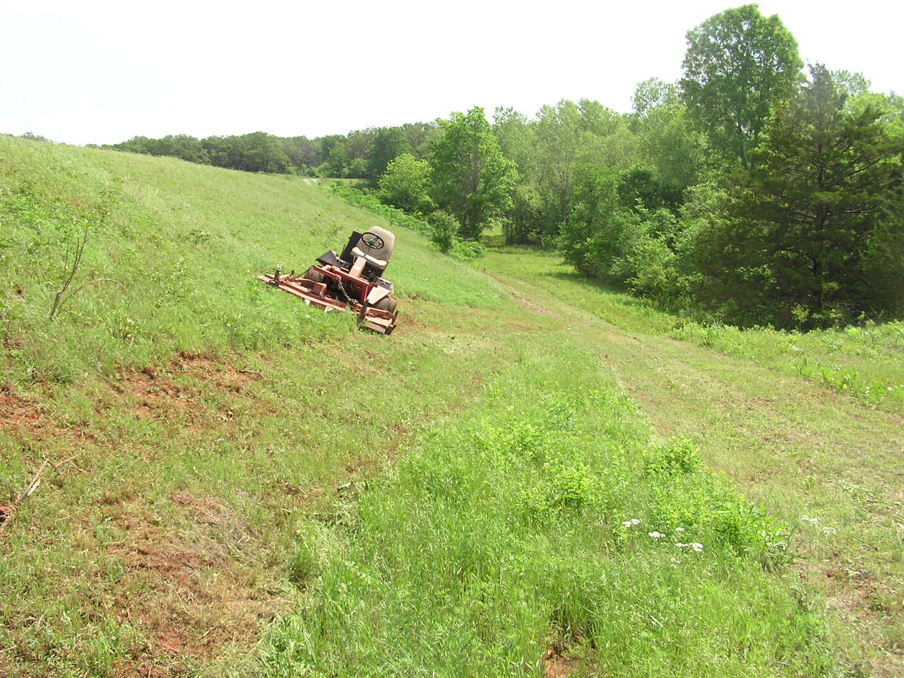

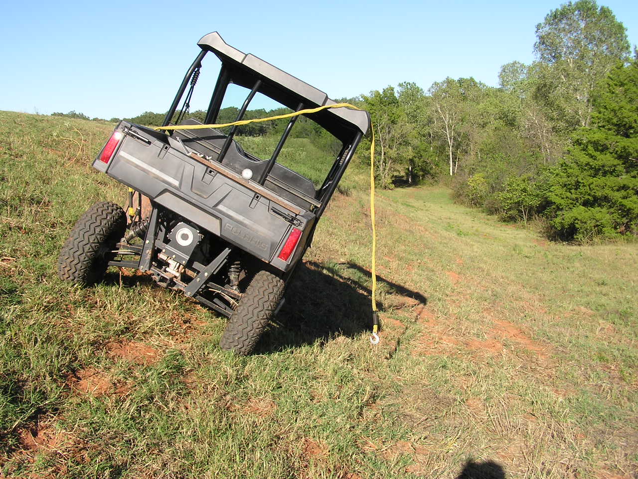

I agree, 3:1 was a major pucker factor the first time I mowed it.
The hanging tow rope shows true vertical.
This side is 2:1 and the mower slides sideways downhill a lot. :eek:

Whoa! Yeah - not liking the 2:1 :shocked:
In reality my total height differential is about 4.5-5 feet. My thought was to not side hill mow but up and down.
   / Excavating/grading question #60
Down should be super easy with the 2:1 lol. Up should be fine also, far more likely to spin out than go over backwards.
