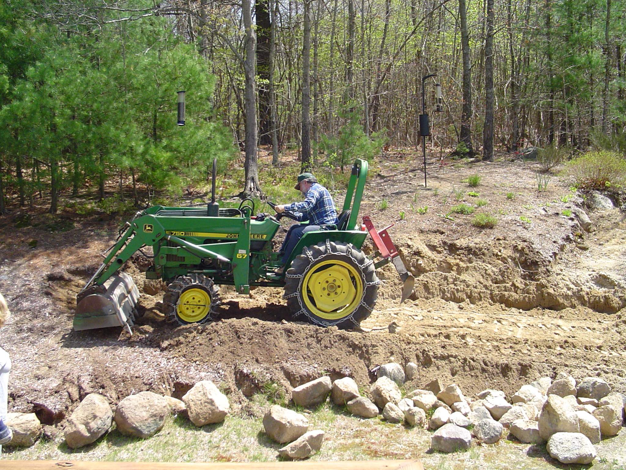

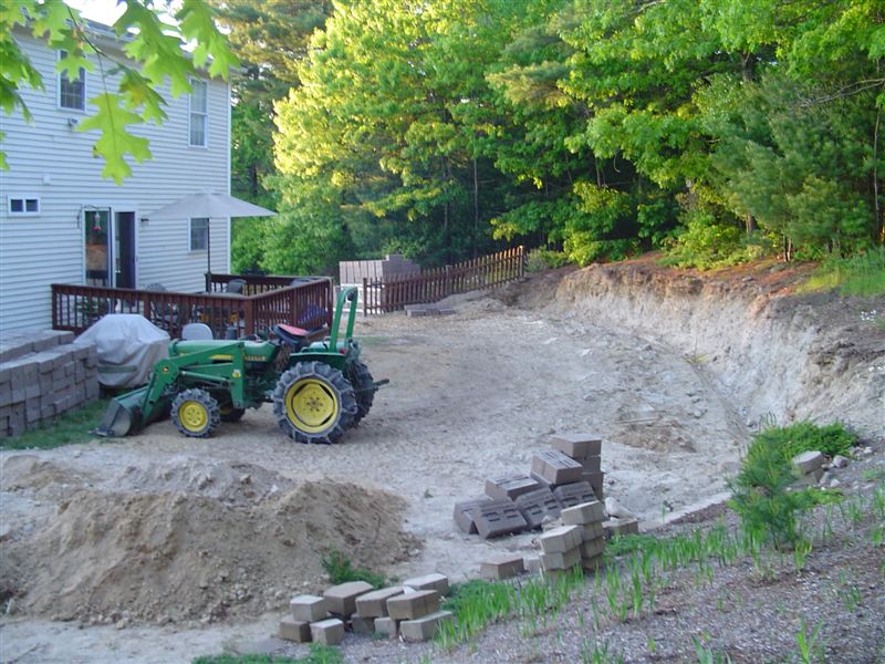

If it is any help DB, these are some picks of a similar project last summer at my daughters house. The slope was also about 45*. I started on one end by lifting the bucket up and making a secondary road about half way up the slope with the material cut from the top part of the slope. I dug the entire length like this first. I then got to ground level and cut away the rest of the slope. This excavation took 2 and a half days to complete in soil that was rock and root strewn. For me the tooth bar was a invaluble comodity that I bought just for this job and I bought one that had 2 extra teeth installed. (54" bucket width)
