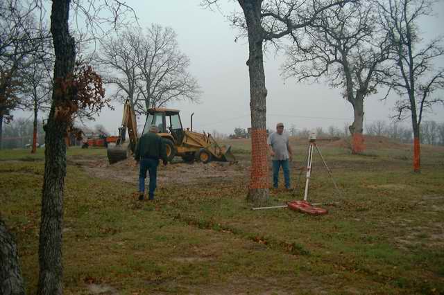

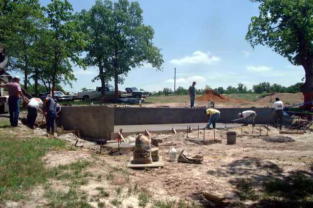

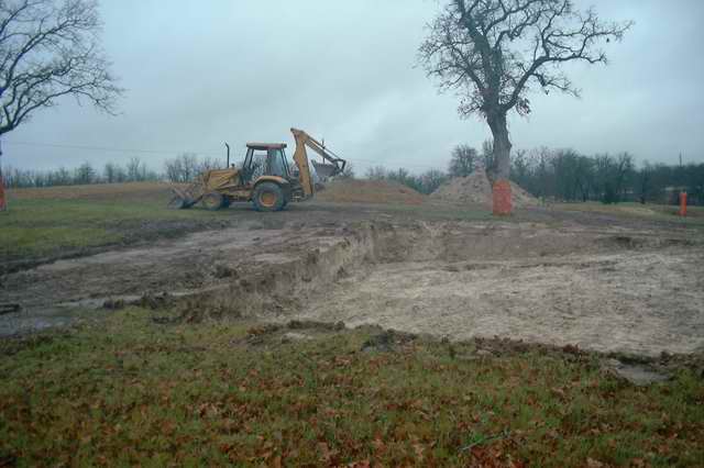

I paid less than $700 total for the excavation in the pictures. When finished, it was ready for the concrete contractor. It was done in less than two days. I just wanted to put it into perspective.
