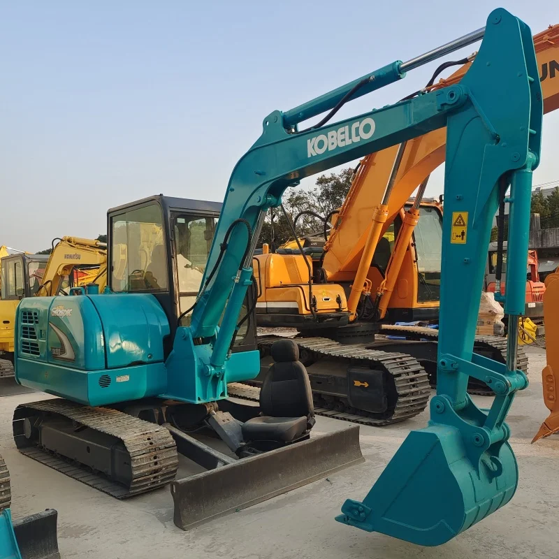

Retirement is scheduled for 2025. soooo I have had the bug to get an excavator for some time. Rented one to do some work around my 2 acre pond years ago. I have a specific project to start with it. Its a wooded strip about 170 ft long and about 40 ft wide. Most trees in it are under say 20 inches wide, mostly pine. A few are well over 30 inches but I could leave them there as they are right on the property line anyway. My goal is to turn that wooded strip into a parking area for our U-pick customers.
Second project would be to remove some smaller pines/hardwoods that have started growing beside the ponds edge.
I found one (see pic below) and it looks like it might do most of what I needed to do. If I had to cut some trees down, saw them in half and then take an EX to move them to the disposal area I would.
Price is in the ballpark of what I could afford. Especially if I decided to sell it when I have run out of ideas what to do with it.
According to the specs (see richiecpes below), it says it has a lifting capability of a little over 5K#.
It looks like from what I can understand about green timber/trees a 20" pine would weigh about 3k# . Well under the capabilities of the one below. The particular one listed shows as having a 6 month warranty. Asking price just under $22k + delivery.
i had checked into renting a bigger EZ at about $6k a week +$700 delivery.
What'cha think underpowered? I'm not too concerned about it taking longer with a smaller piece of equipment.
Don’t know if these would be applicable to you
   / Excavator size for farm work #29
Machine is underpriced. I smell a rat scammer here. DO NOT send money until you personally meet the seller and see the CAT.
