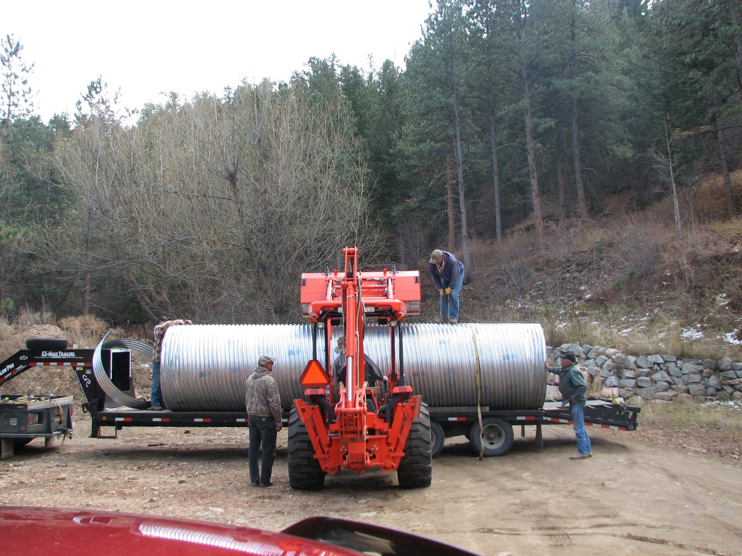

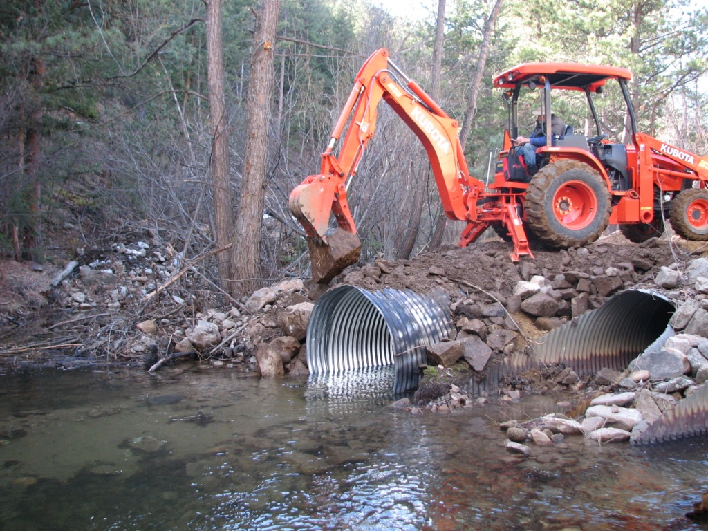

THe question you ask is one we hear a lot. Like a lot of TBNers we find ourself doing more land maintenance and landscaping and little traditional farming. For us, lifting and digging - and especially a hoe with a thumb - are what we want.
It might be a telehandler, excavator, or skid steer.... or it might be a mid-size TLB. The TLB is the solution several of us have come up with but they aren't as well known as tractors. A TLB is a purpose built machine and made much heavier than a tractor with BH & FEL accessories. On a TLB the 3pt hitch is the accessory, not the FEL or BH.
Construction companies are well aware of TLBs, it's the common yellow "backhoe" you see on every work site.
Kubota is the only company making a homeowner type mid-size TLB, but luckily they make a good one in 3 sizes.
rScotty
View attachment 754006View attachment 754007View attachment 754010
Now THAT is a culvert pipe!
