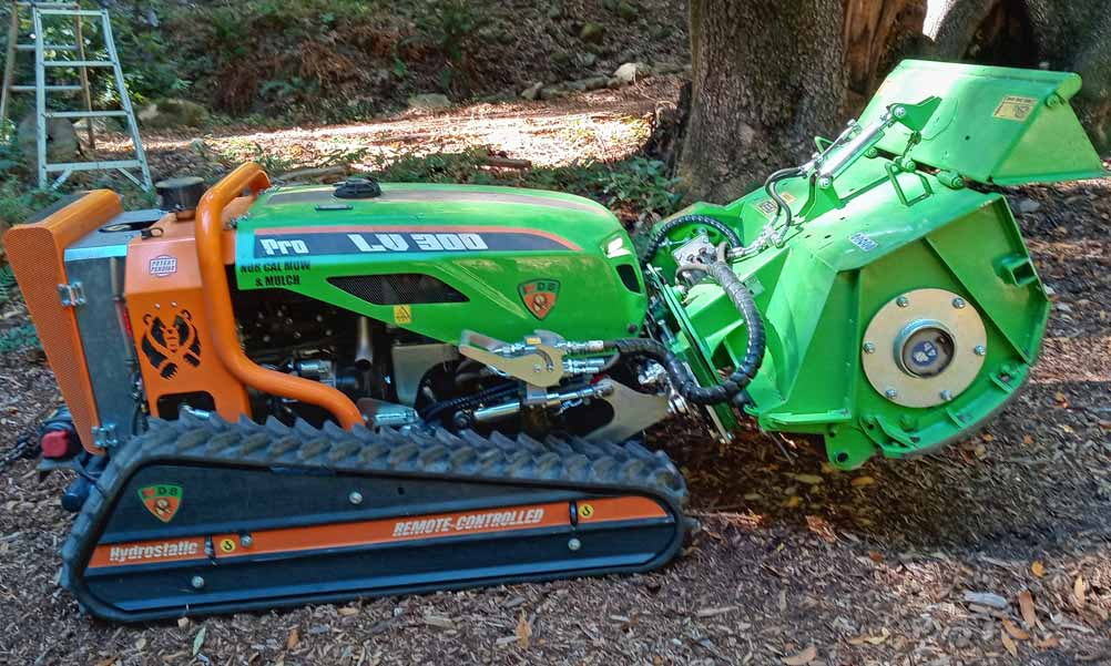

Just had a demo here of the Green Climber LV300, which is 1-ton, diesel, tracked, and REMOTE CONTROLLED. It has extra-deep treads on the tracks, but it still struggled to get up loose duff on the slopes. Flail attachment pictured.
Not as slick as Faxman's Bobcat, but intriguing nonetheless.

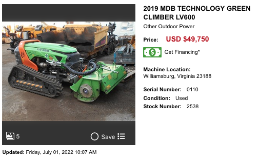

OUCH. That is one expensive, albeit probably very useful machine for the right application. $50K for a used machine
I wonder how many of these get rolled over because the remote operator gets a little ambitious with the incline?

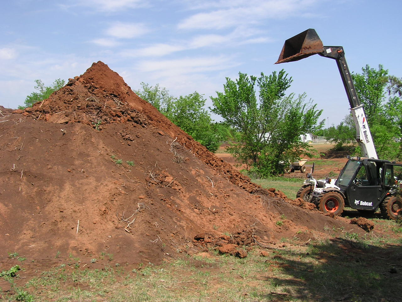

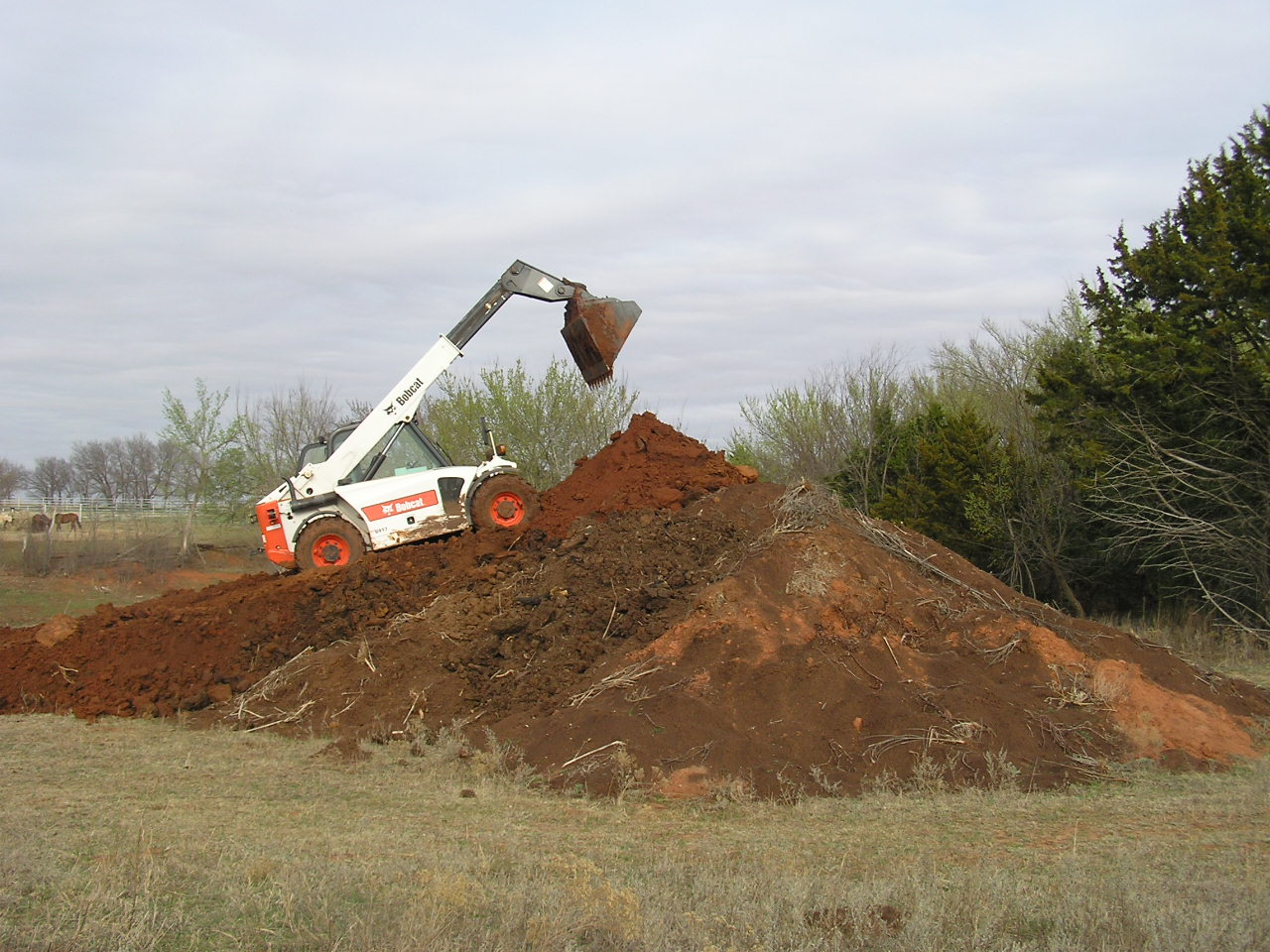

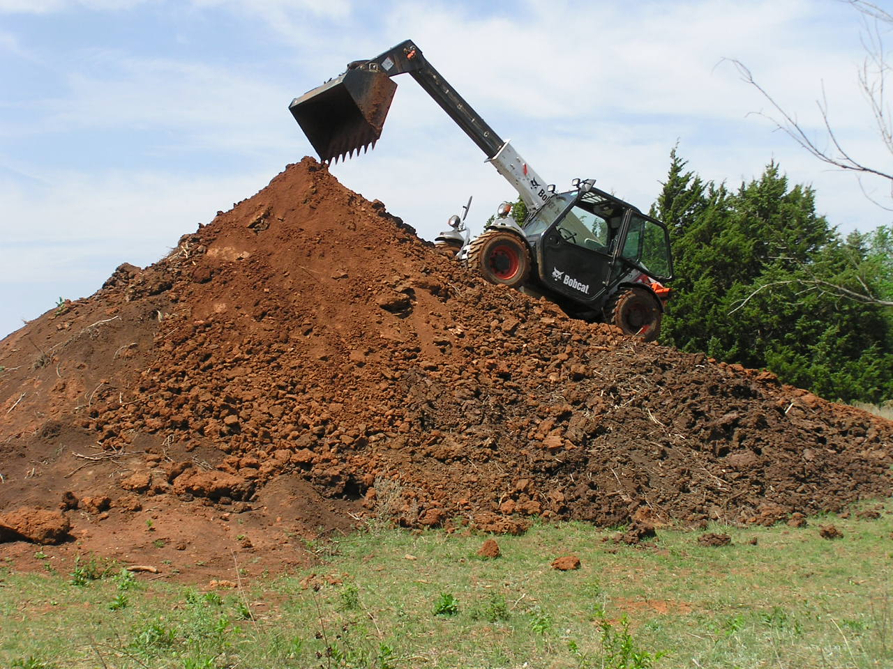

Speaking of large volumes of dirt:
The little one in my photo above (Green Climber LV300Pro) is new and cost about $80K. Good for a contractor specializing in brush-clearing on difficult terrain. The 600 is much bigger and heavier. I will I had the extra-deep rubber tracks on my mini-X.
The LV300 looks like it can handle a rollover without damage, other than scratching paint off the rollbar. I do think it needs more counter-weight for mowing downhill. Just had a demo here yesterday, and I posted vid on my Utube page.
I am not promoting this method or this product for brush removal; I just want to see more efficient and economical methods of reducing the fuel loads in our local forests.

I don't see how a telehandler could dig a deep hole with steep sides. Am I wrong? In any case, they are hard to find used in this area.
