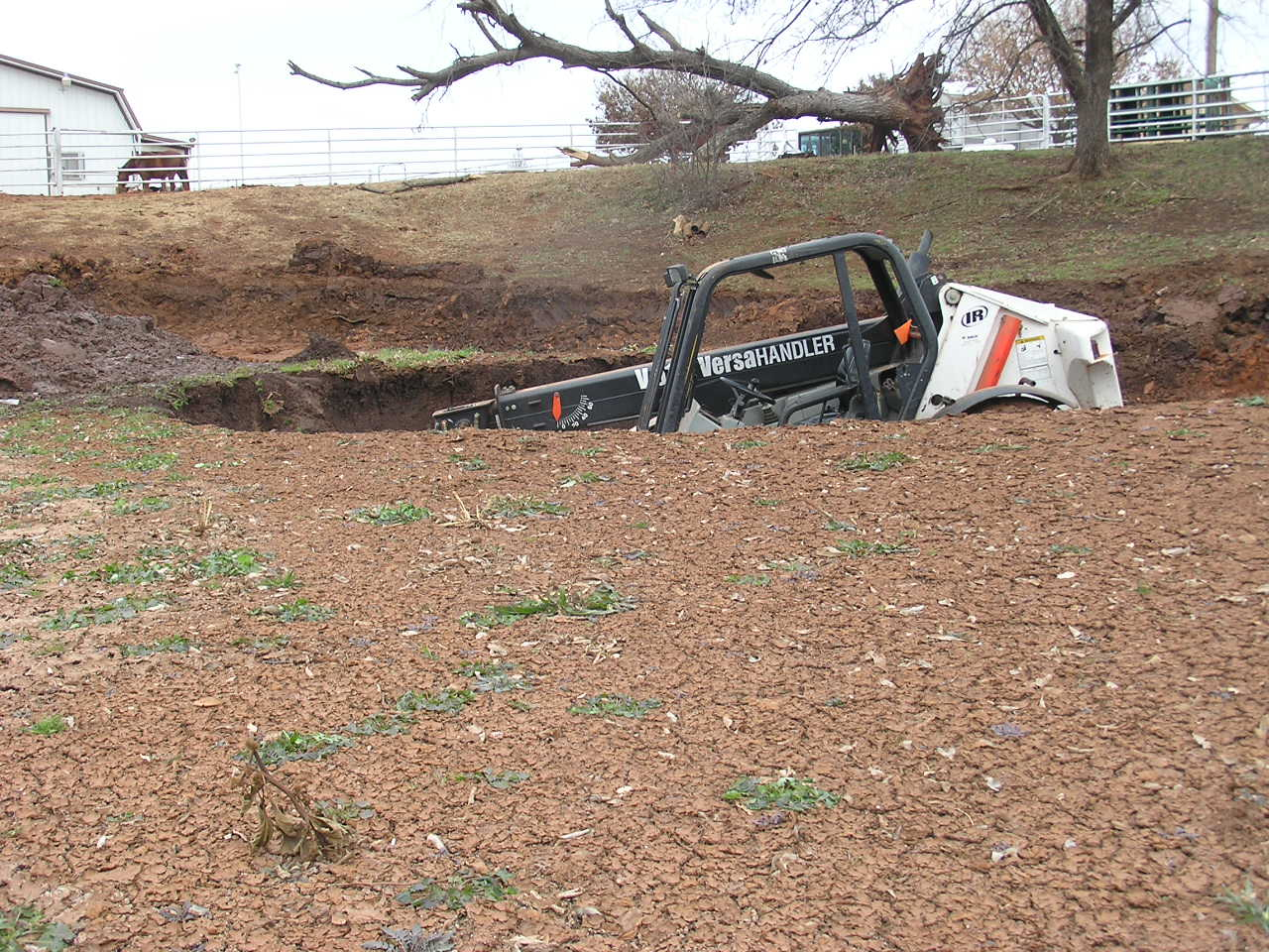

I don't see how a telehandler could dig a deep hole with steep sides. Am I wrong?
How deep?
One way is to get down in the hole:

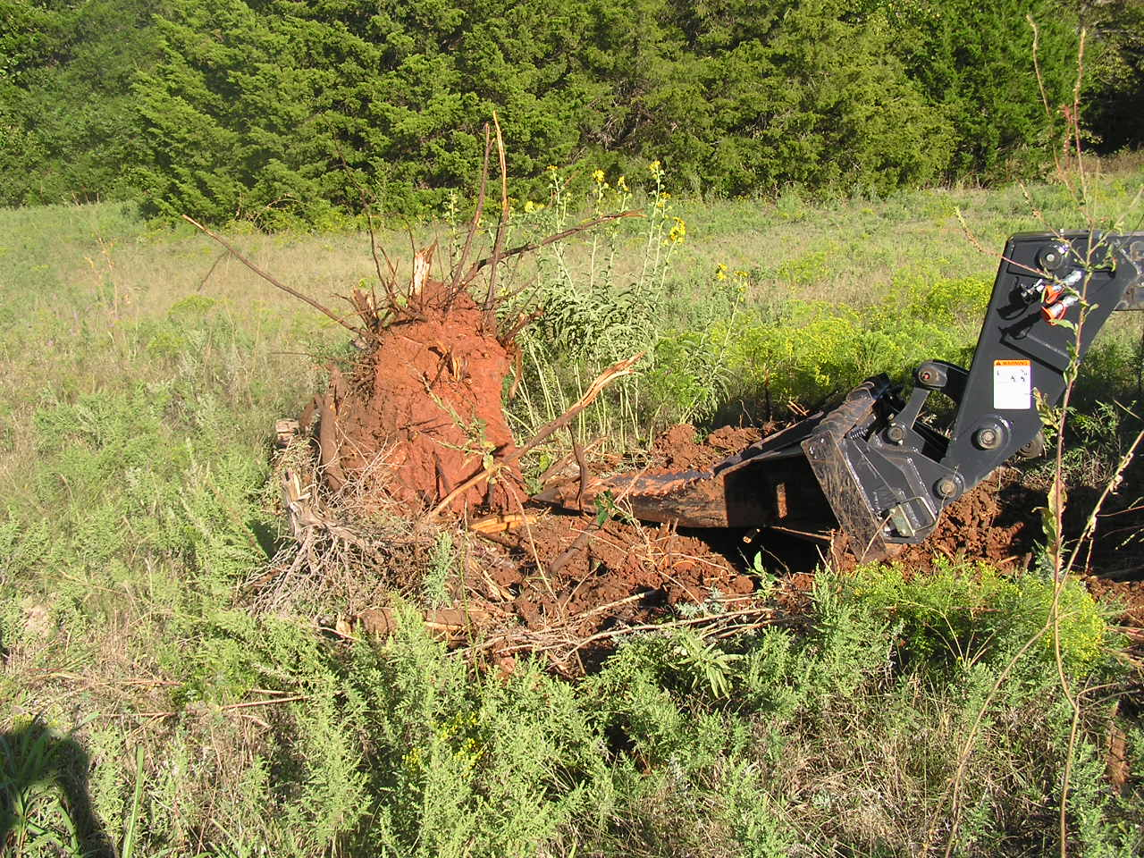

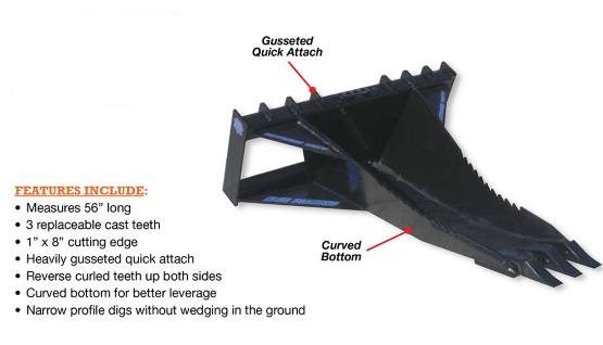

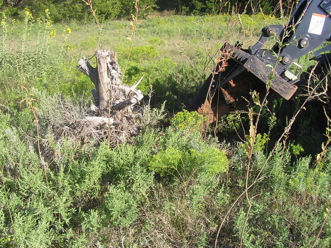

For digging out rocks the stump bucket will go over 4' deep:

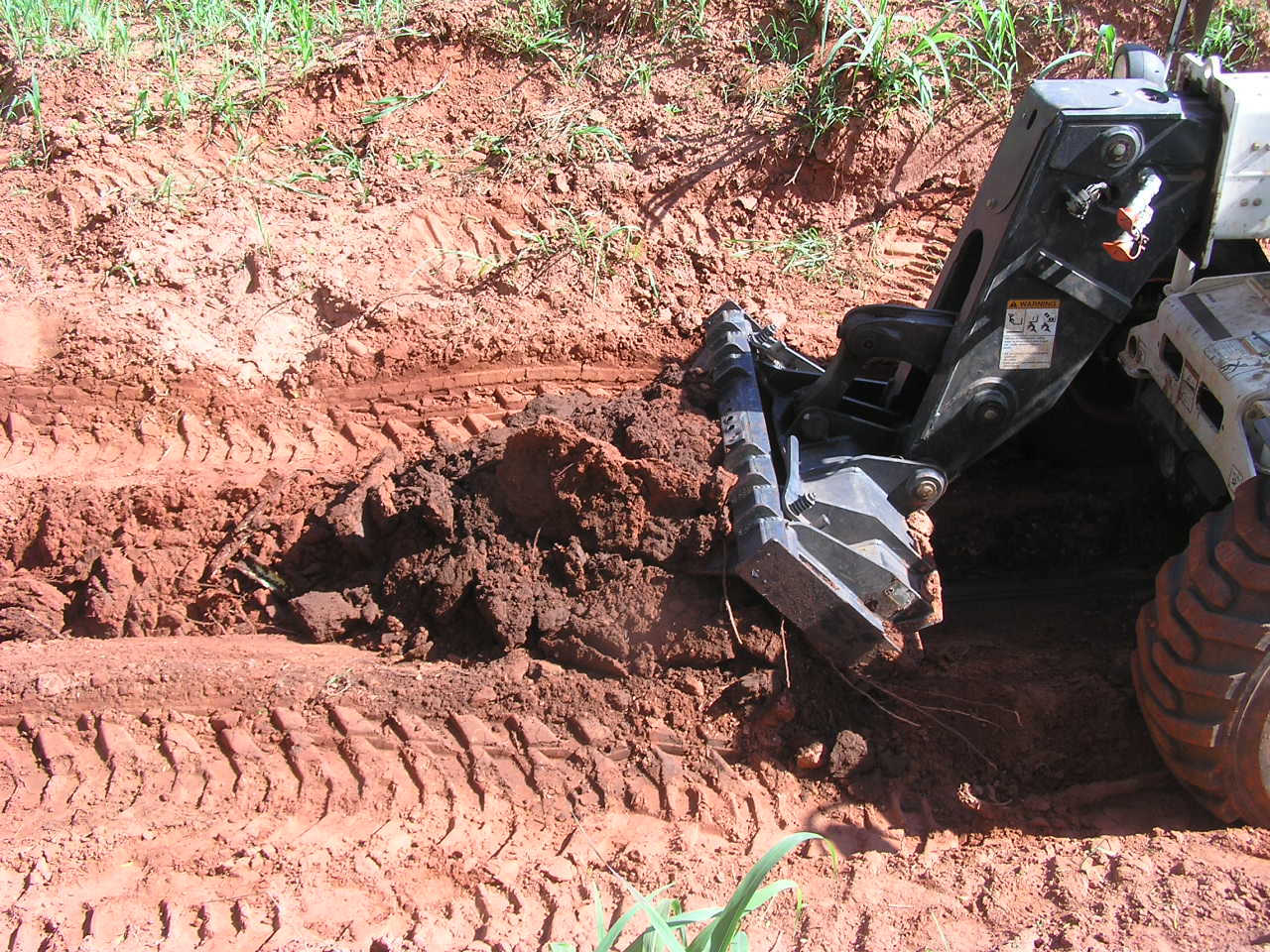

Also works good digging out trees:
And stumps:

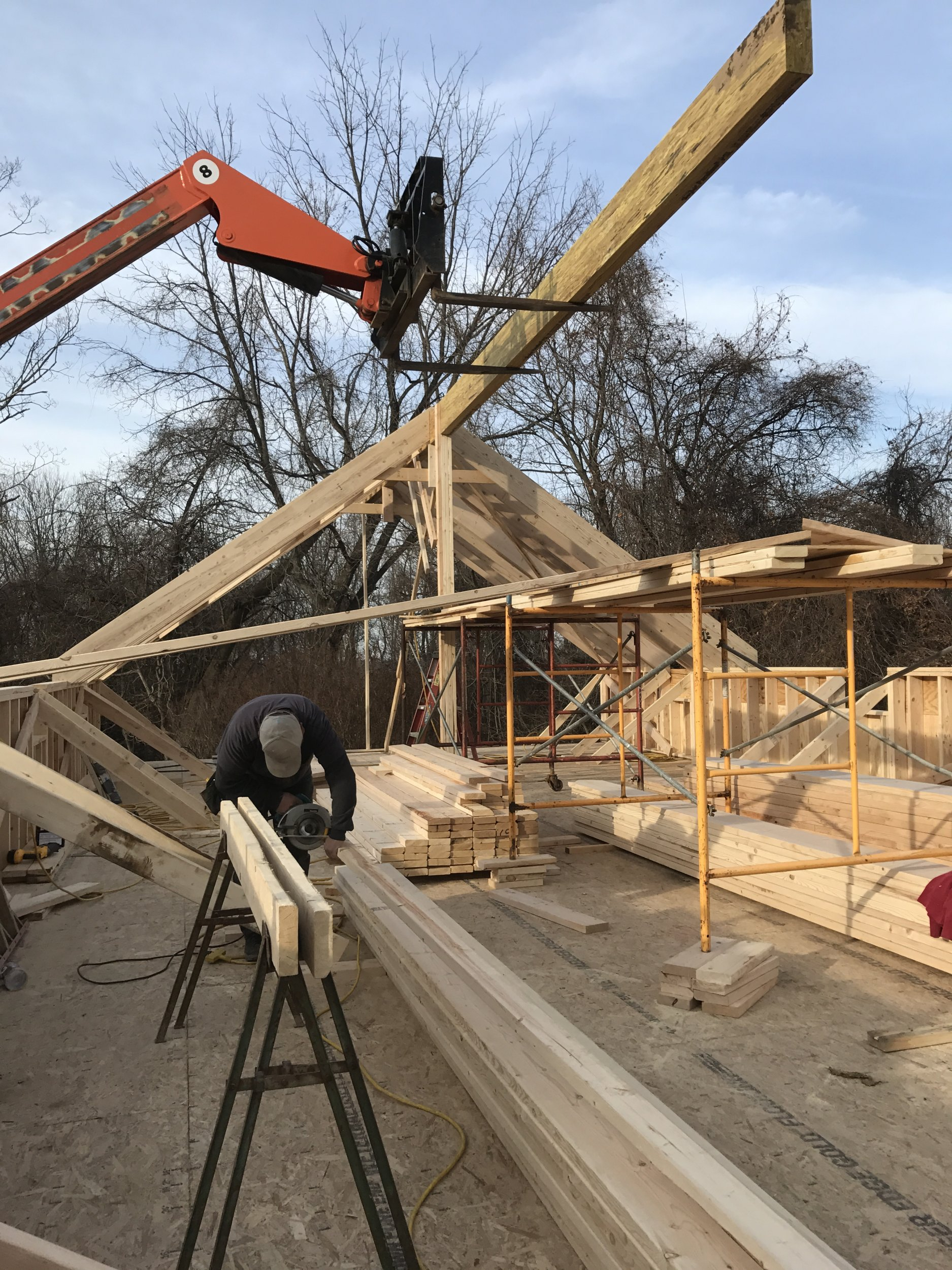

I rented many telehandlers over the years to do construction projects. You couldn’t build a building without them, unless you wanted to have 3 extra laborers around.

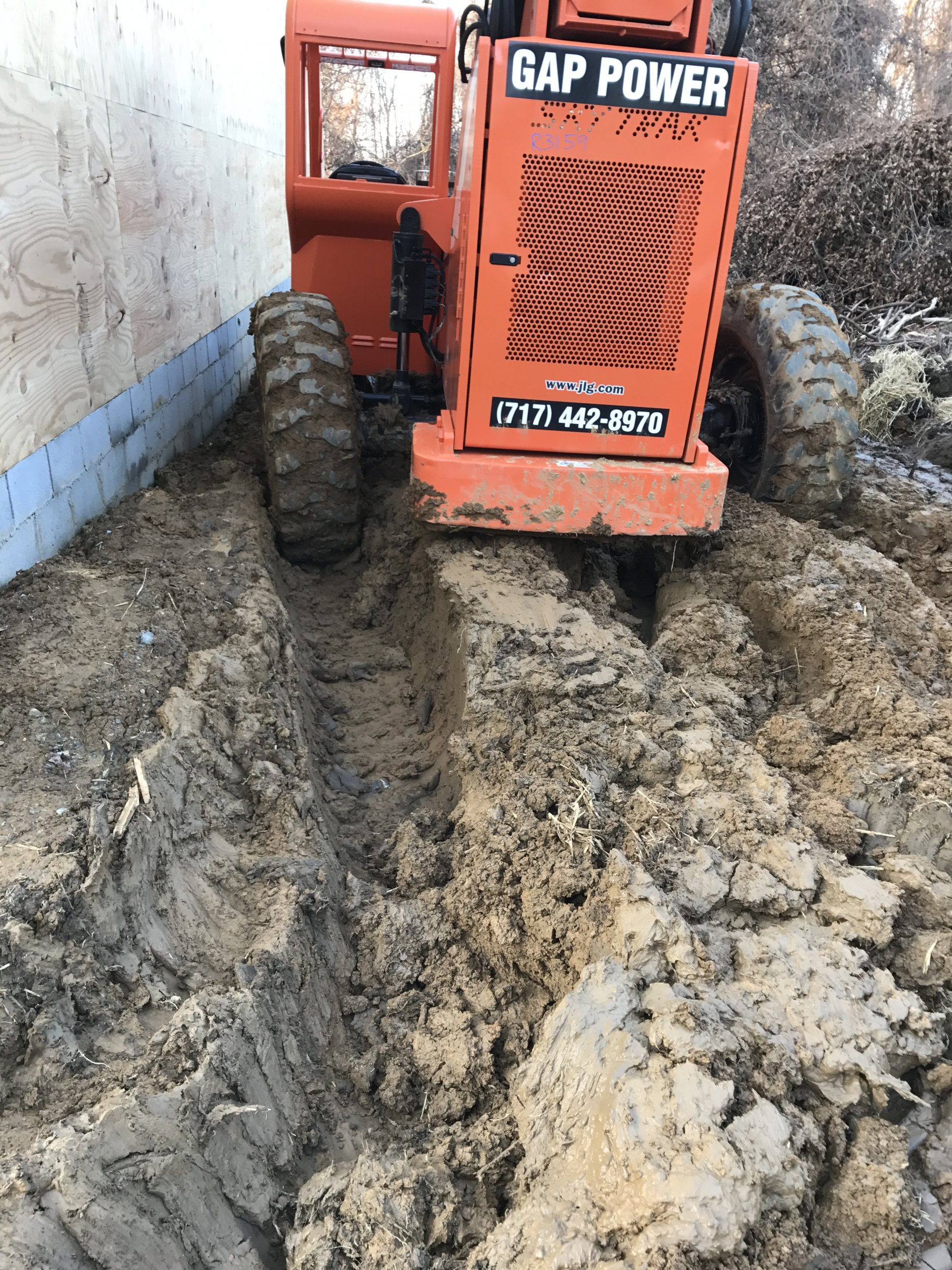

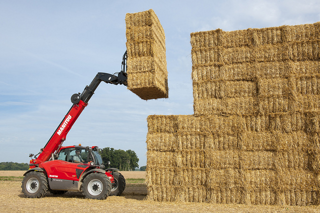

This is what I would like to be able to do
   / Excavator v. Skid Steer for Hobby Farmer? #89
For your application, definitely get the Ag version of it with those nice R1 Radial tires. Those can actually be useful and move on some wet ground. The other ones sink in the first pot hole it finds.
   / Excavator v. Skid Steer for Hobby Farmer? #90
Oh, if you only knew the mud we have dealt with…..lol
