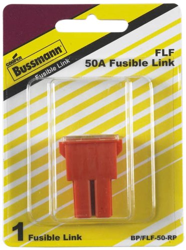

I believe I've read several times that there is nothing special at all about a fusible link, except that it is four wire sizes smaller than the rest of the circuit's wire.
Do some research before trusting my memory. :)
Bruce
/ Excavator won't start. Round 2 #4
I cannot help you with the location but on my Link Belt excavator, the starter fusible link tends to blow every winter when there is a cold snap and I have not run it in a while. I believe my links tend to blow because I let the battery's get low from lack of running and it takes more cranking time to start up in cold weather. Like you, I unusually start it once and run it all day, it is always the next day I find it is blown.
If you find it blown, you may be able to get one at a parts store, they had several 12V versions of mine but I needed a 24V, found it at a local tractor dealer as I have no Link Belt dealers around.

Thanks, guys. BCP that was what I thought the diagram indicated and that is what I looked for. But what I saw was a plastic housing that was similar to the one kubotaToy showed.
