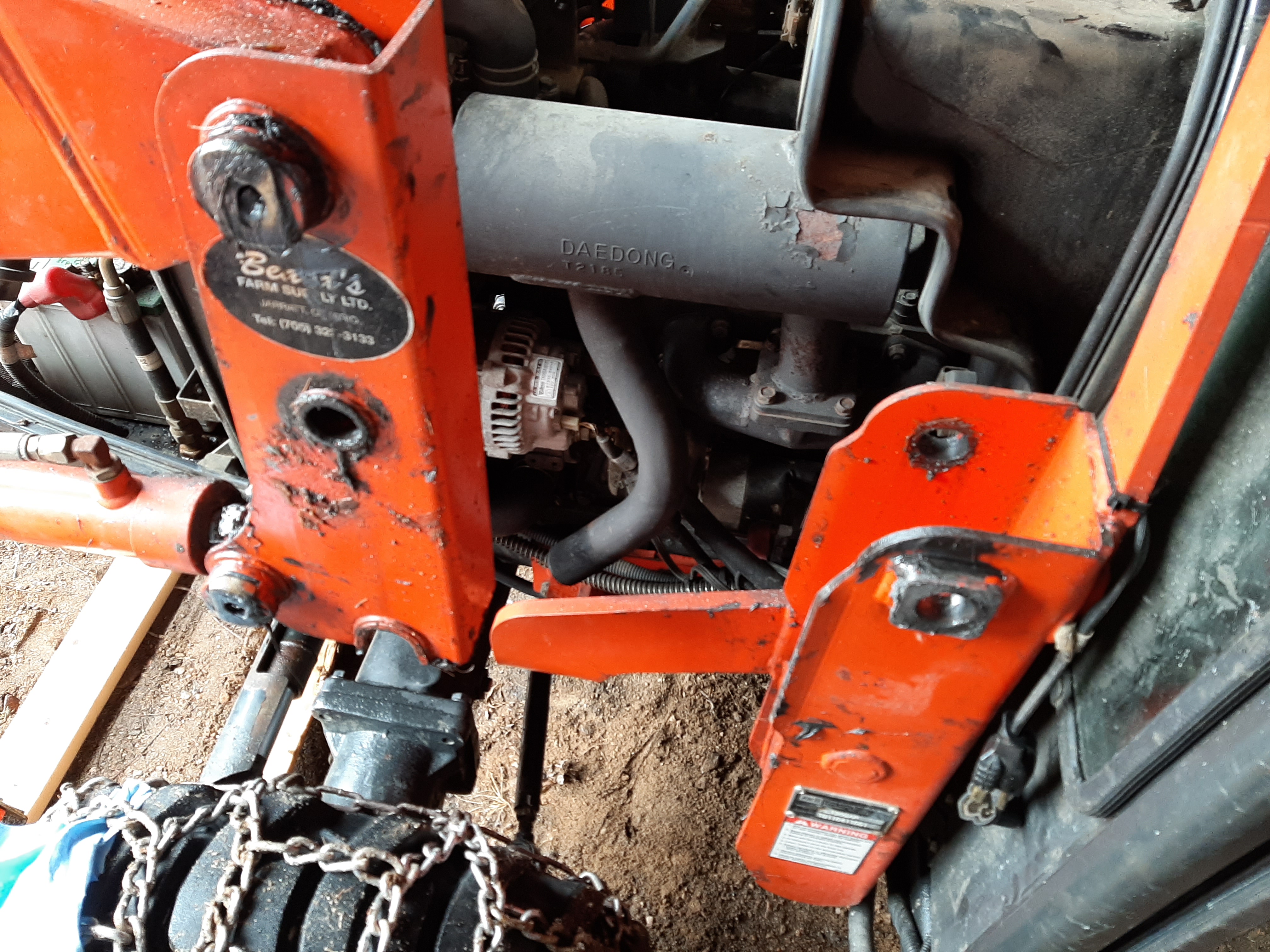

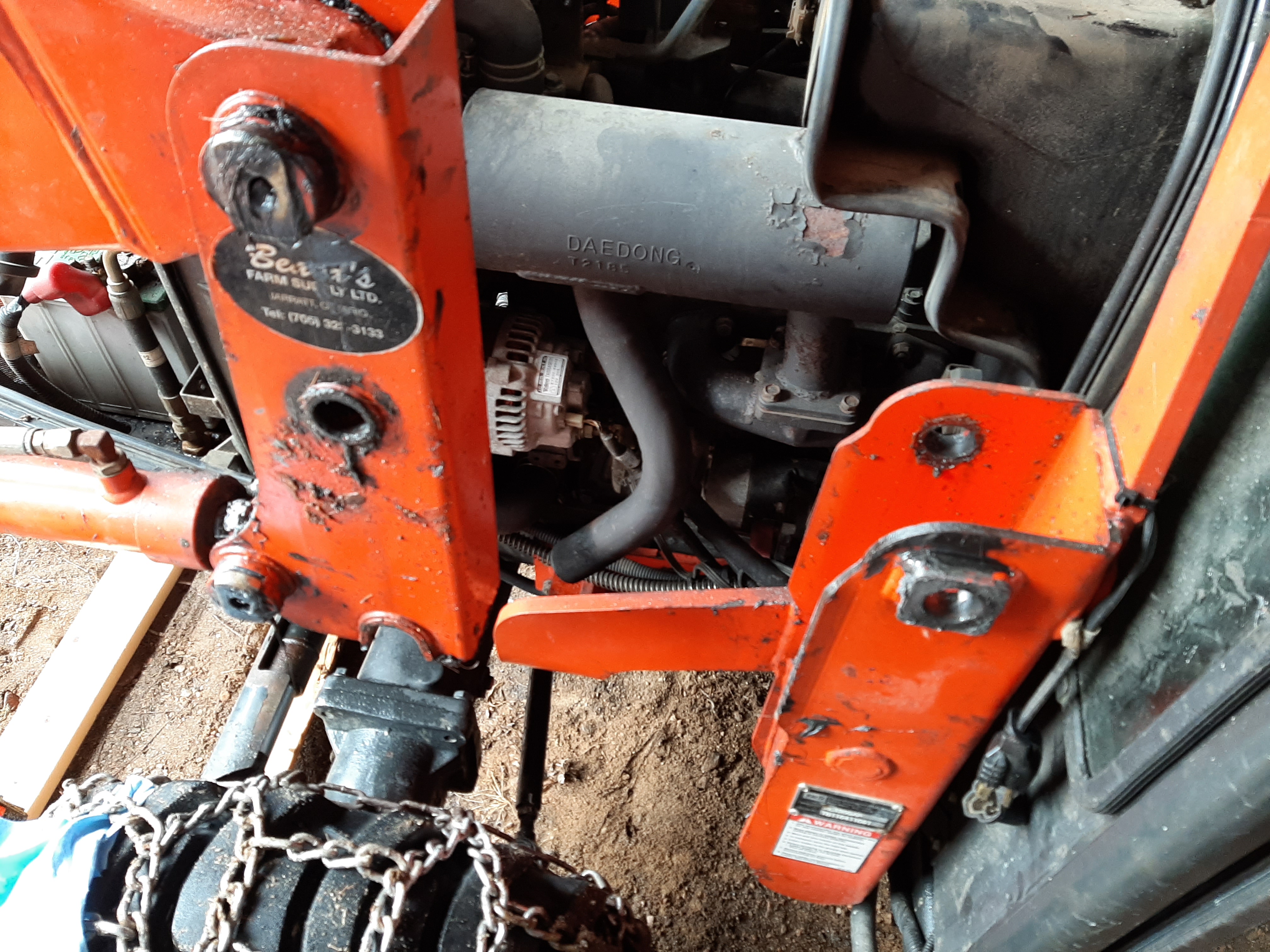

I don't dare run my Kioti in long dead grass for fear of starting a fire. So after 5 years of thought and designing I bit the bullet and took her apart.
We separated the loader from the tractor;
The bolts holding the muffler onto the manifold were easy to take out;

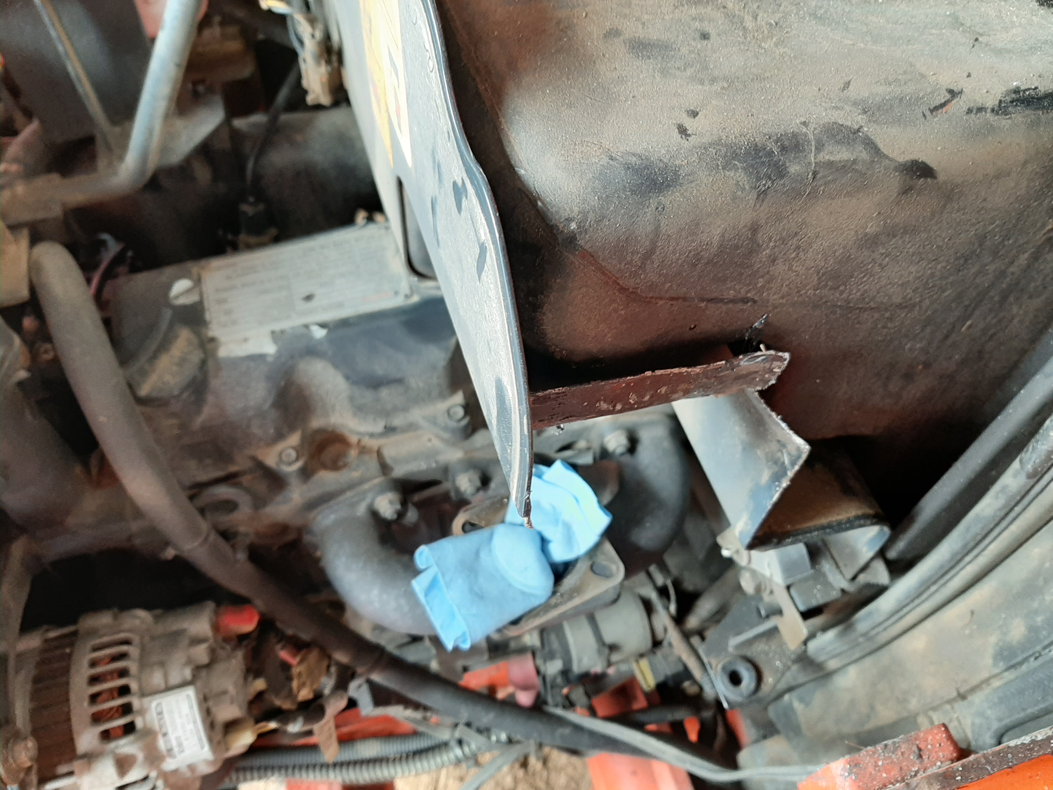

I needed to remove the hood, first. The hardest part of that was getting the headlight harness off the hood. (No pics)
Stuffed a rag into the manifold hole to stop any cuttings falling in and cut the heat shield in two places so I could bend the horizontal part up.
The pipe I used was 1.75" by 45° angle, with a little 'customizing'. There are two of them. One off the manifold and the other fit into the first one. Both of these needed cutting/customizing.

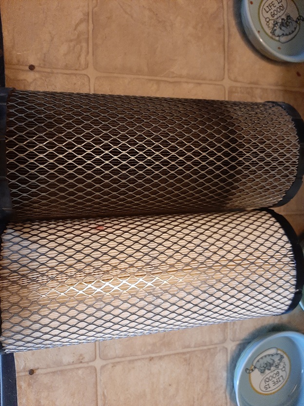

I looked at my intake air filter just before I quit for the day. It is black. A pic of that will be loaded today.
New air filter ordered.

Here is another reason for the stack.
/ Exhaust conversion from grass burner to stack #19
I buy from Summit Racing, too.
I have a buddy with a tubing bender, he bought it to bend the tubing for his roll cage. Trouble is, he is 6 hours north of me one way.
Did the heat cook your air filter?
