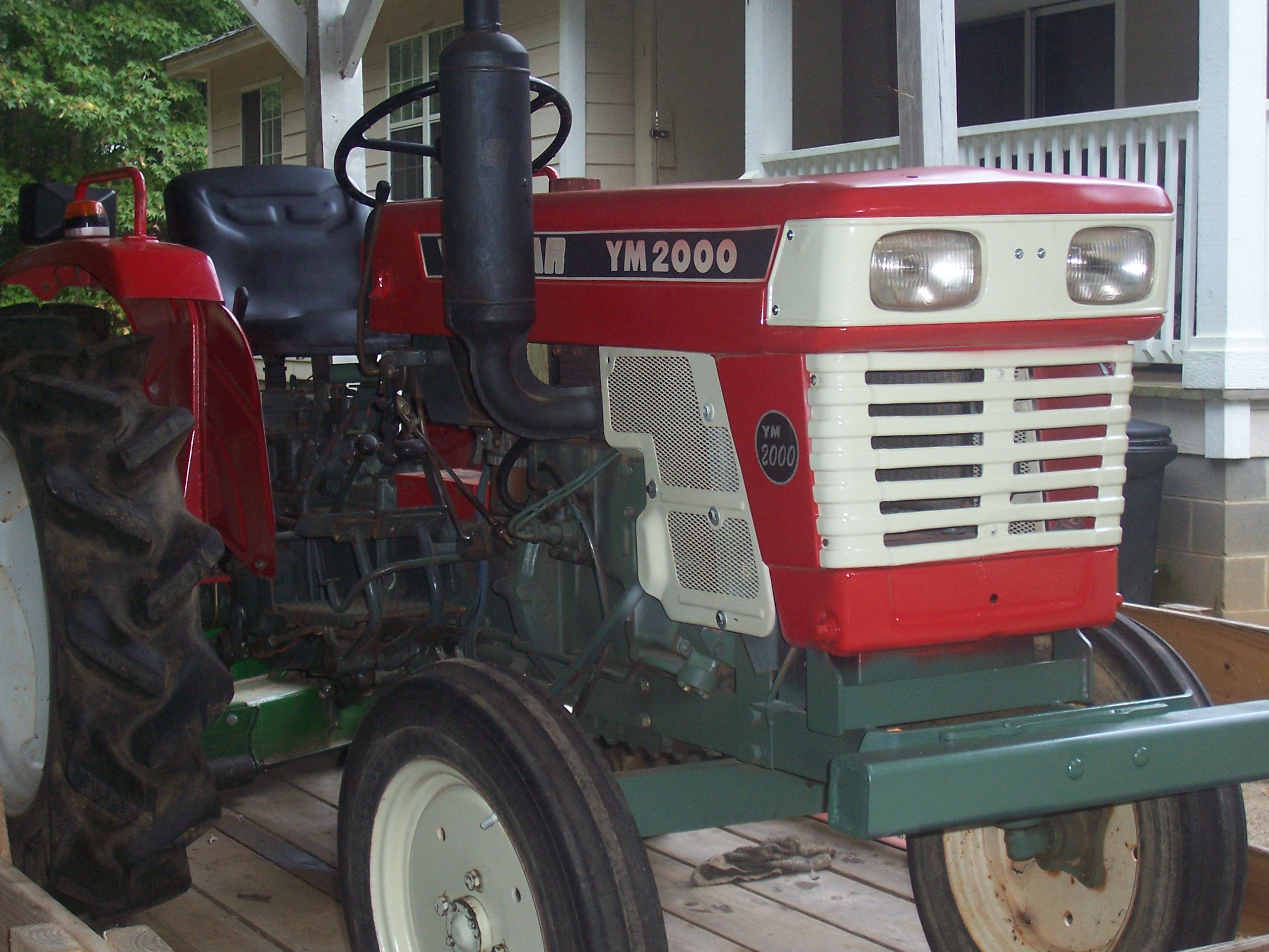

Just finished cleaning and touching up the grills/white with the spray touchup paint. I went out of commission for awhile and had it since I bought the parts it needed. I touched the grn.up awhile back. Like I suggested before get the maintenance and tractor working properly then work on cleaning it up your give it alittle more TLC. :)

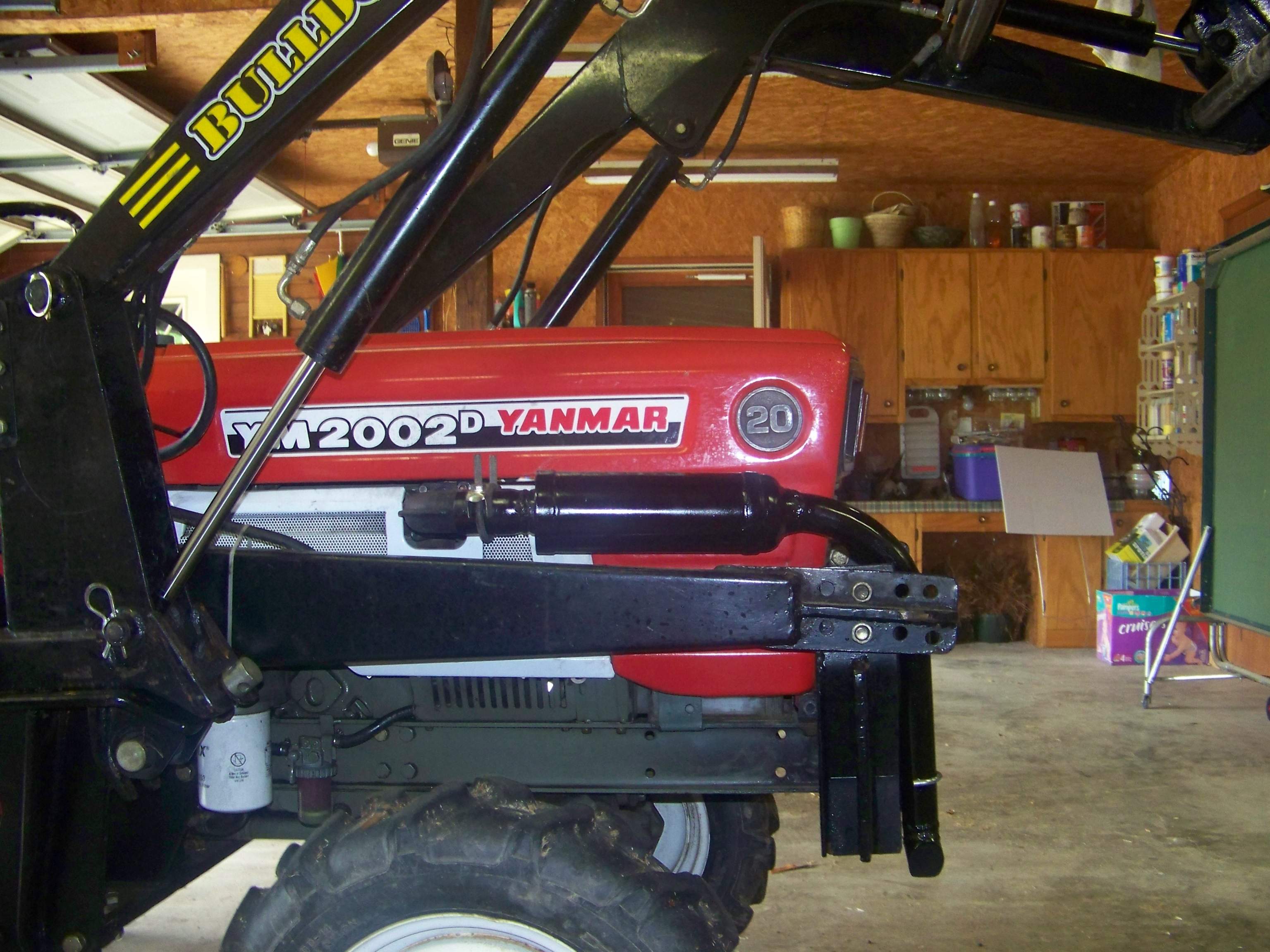

Here it is, I mow under a lot of trees and need a low profile. Has worked good for me. This is a 2002d

I had thought of re-routing the exhaust to under the tractor and have the pipe exit out from the rear of the tractor as would a car would be, although was told that the more length and bends in the pipe would cause restriction and back compression,
Deep, I had been thinking the same thing. If I turn the muffler straight down, and depending on where I cut the pipe I believe I could use a 45 instead of a 90. There would naturally be a few slight sweeping bends to get to the back. Do you remember who told you this? If restriction is a problem maybe a 2" pipe may solve the problem. Maybe one of our dealers will chime in .
/ Exhaust Muffler #10
ninefinger, I wouldn't think having a 45* bend would cause any restriction on a downward flow, I had been transporting my tractor one day when I stopped in to talk to an old friend who owns a muffler shop, and I brought up the reconfiguring of my tractors exhaust to the rear is when he advised of the possible holding back compression ( exhaust ) when having to bends around the QC to my loader and many other things being a routing problem,
he would have had to make 7-8 bends and use about 6 ft of 1 3/4 pipe and then find a place to put the muffler,
said something about scavenging diesel exhaust would lay in the pipe, the tractors 2 cyl. diesel engine wouldn't blow it all out the way he would have to rout the pipe,and would not be on a continuous downward flow,
he could however simply dump it down about midway of the tractor but he also said I would hear it even more when sound rebounds off the ground, Kinda like having turndowns on your cars exhaust right at the rear axle, I do know how that is:confused2: cant hear myself think:cool:

Both of the tractors that I use regularly has Vertical exhausts and doesn't bother me at all. The ym2000 and the JD5103. On my 8n Funk the exhaust is horizontal to the rear like a car and that is the only one the exhaust seems to get to me the most. Esp. if I'm moveing slow or sitting still. The 5103 that has a FEL. is the only one IMO. that has the power to even have a FEL. With the vertical stack if i'm in under tree's etc. easy Fix Just reach up and remove the Exhaust pipe and slip it back on when you clear it. :rolleyes:
