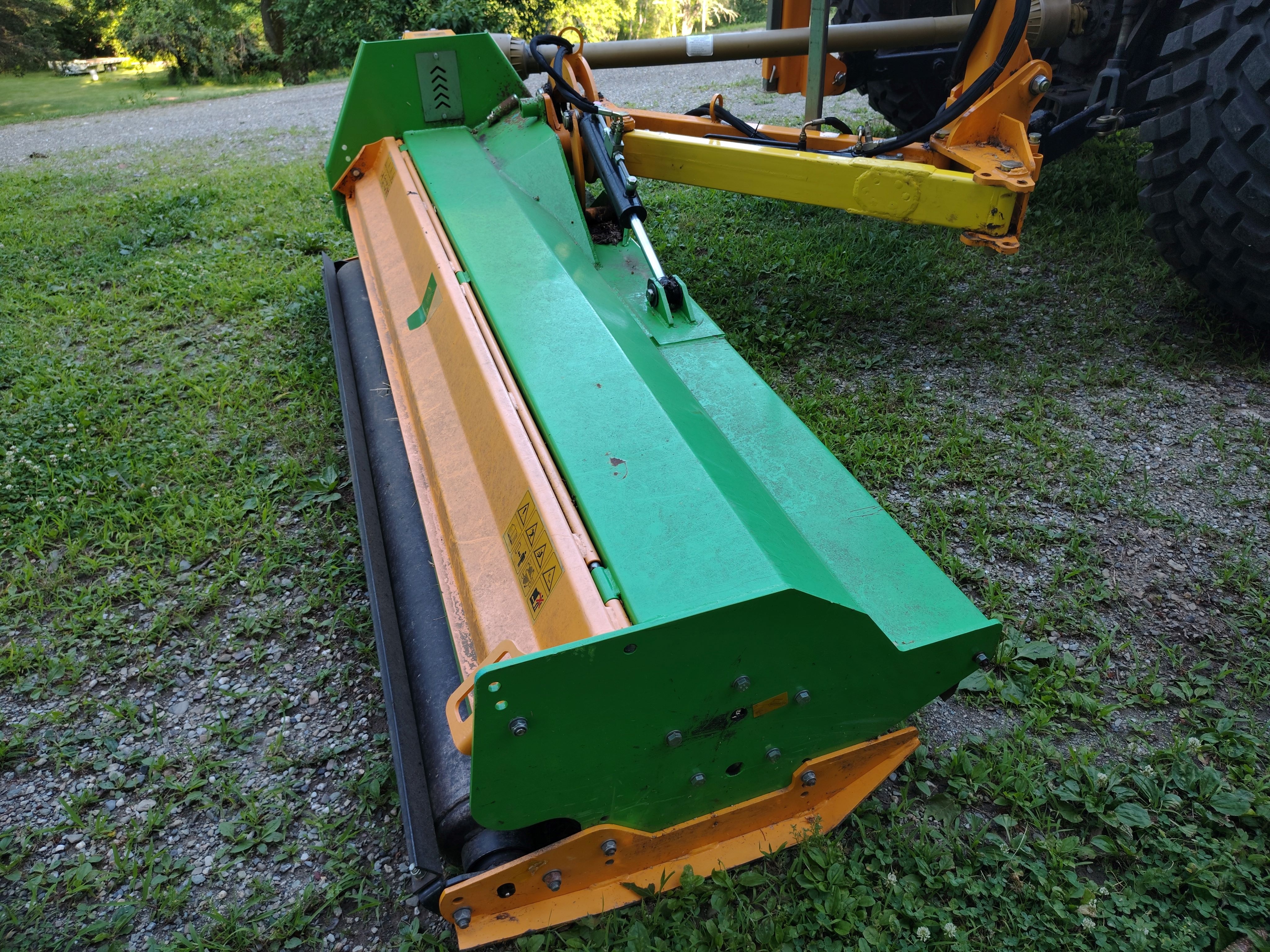

My ditch bank flail also has an openable rear cover with three adjustments. The further opened the less recutting and the more material spread out behind the mower. Also the less hp required in heavy material.

My old Seppi has hammers and an adjustable rear hatch. I have the rear hatch wide open. I have the roller on the lowest setting, whereby the rotor is at its highest position. I also have the top link set pretty long, also raising the rotor. It seems to distribute the cuttings pretty evenly set up like that.
This is only the second season I have used it. I will try the hatch closed this fall and see how it works. In this position it mulches more and I assume will add additional load to the tractor, so I may have to go slower. And, it might clump some?
I really like the flail mower compared to my rotary cutter.
The trash door on your Seppi Flail shredder serves 2 purposes; (1) it allows the user to mow/shred tall grasses and crops in one pass.
(2) you can inspect the flail shredder knives without lifting it and crawling under it.
