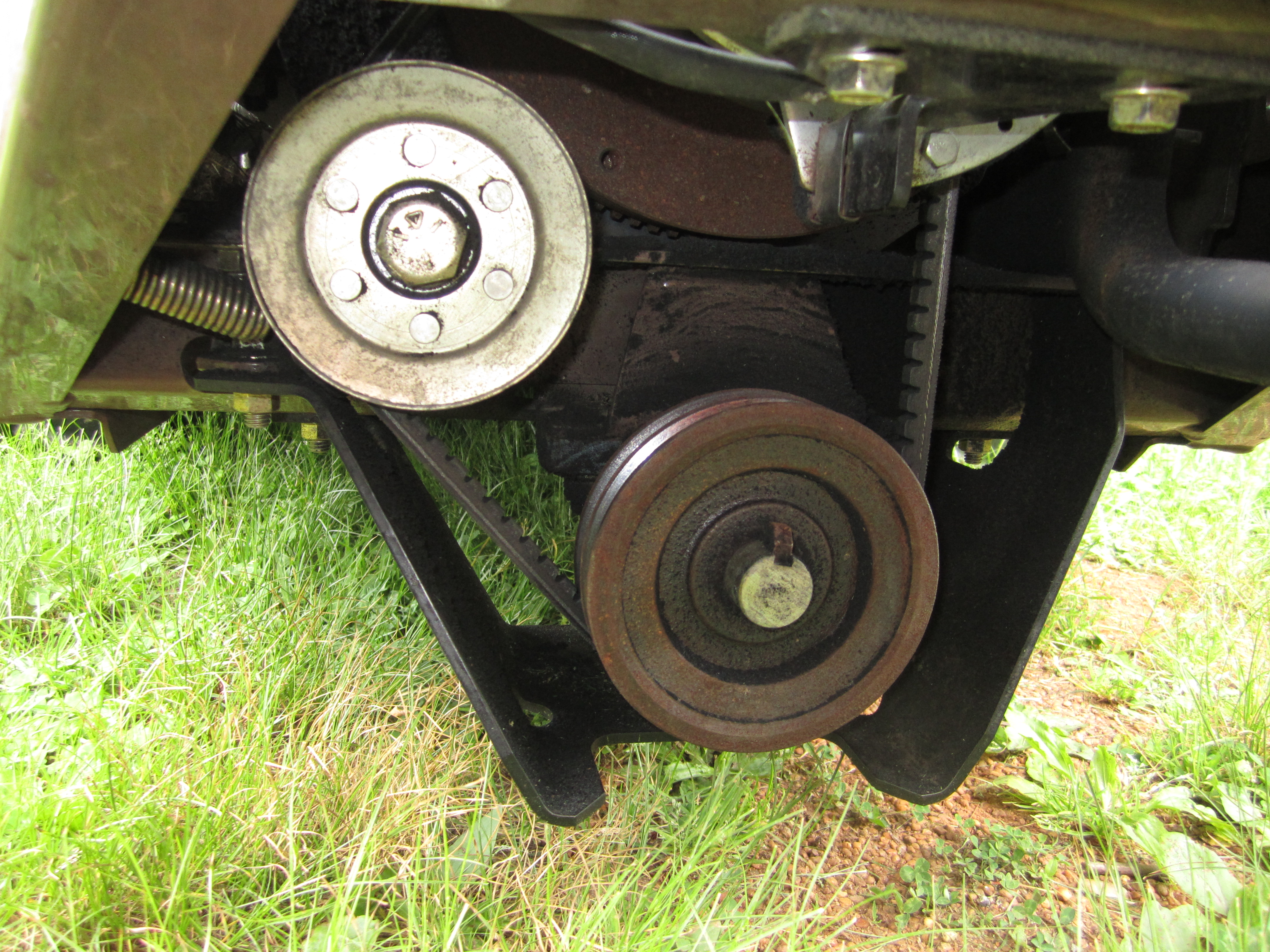

So I looked at a few things on the parts sites, and found my 700's share the same belts and sheave part numbers as the 900's. The sheave spring arrangement is different between the two though. So I ran out to the barn to compare the rear ends of my 722DT6 and 725DT6 to the photo of your 930. I think you might have the wrong sheave on yours. As someone else pointed out, your belt sits low in the sheave (idler pulley) and on both of mine, the sheave is much shallower and the belt sits with its outer surface about flush with the rim of the pulley. I don't know why that would have been replaced on such a low hour mower, but it is definitely not the same part as shown in the parts diagrams or what's on my older or newer 700's. See this diagram Grasshopper 93�D2 PTO Shaft Clutch Assembly 2�11 Mower Parts Diagrams- The Mower Shop, Inc. and look at item number 20, part number 415610.
The belts on mine are not as tight as I would have expected, and have about 1/2" deflection. I guess it could be that you have the wrong belts on there too, but mine are not very large at all. That would make more sense than having the wrong sheave.

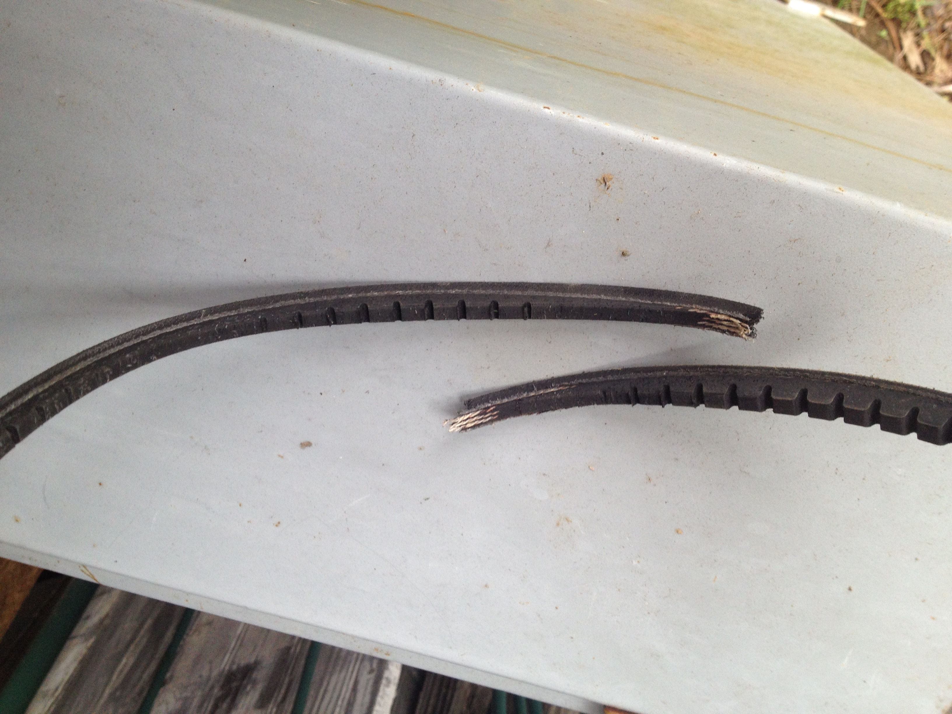

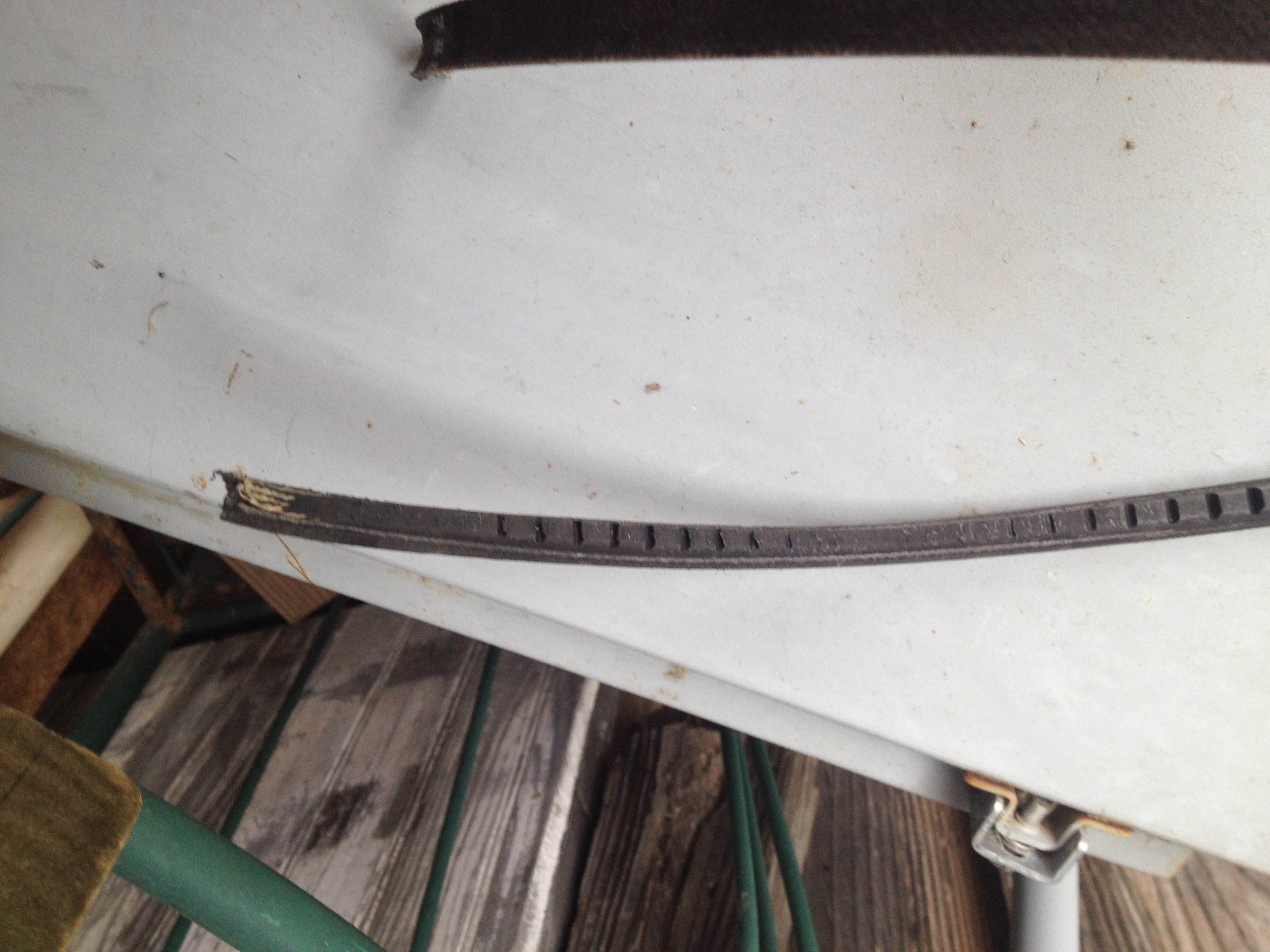

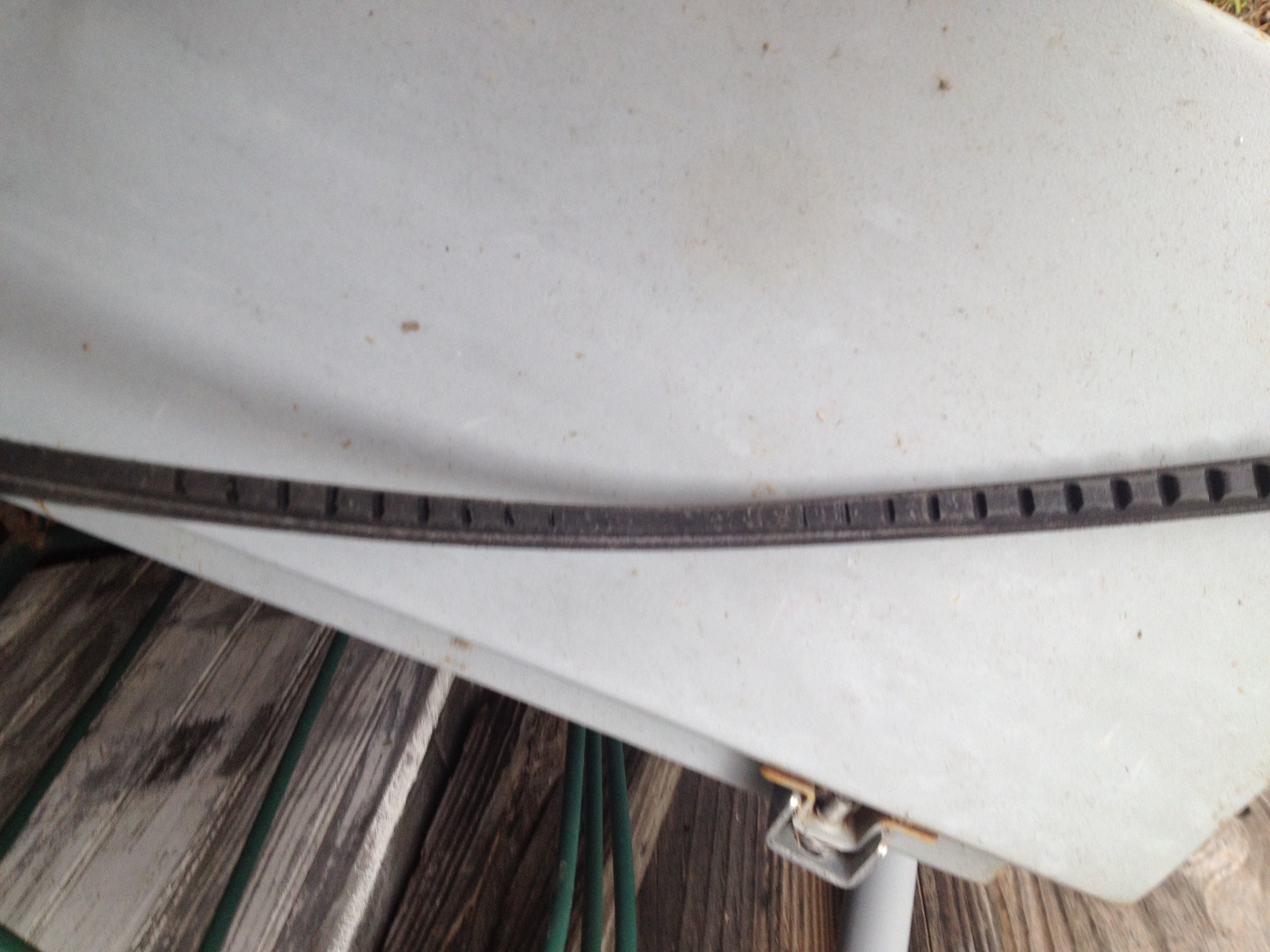

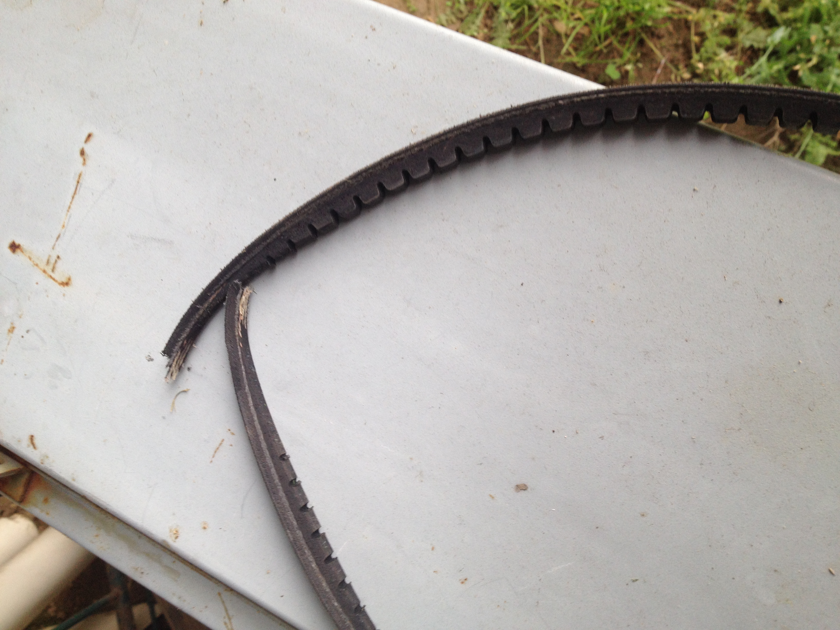

riding out the teeth of the belt ouch. and multiple flat spots.
with others, belt rids up on the sides, not the bottom of the teeth of the belt.
the teeth act more like "structural support" for the belt. and there be some gap between bottom of teeth and inside diameter of pulley. other words the teeth help hold the belt from slipping all the way into the inner diameter of the pulley, along with keeping the belt within the groves of the pulleys. but most of the work is done at the edges of the belt itself. not the teeth.
if belt is allowed to slide all the way into the pulley inside diameter. the belt will physical bend more, creating more heat build up within the belt. causing it to stretch more, more heat and stretching = loose belt that will burn itself up causing flat spots.

looking at diagrams others have posted. double check alignment of the PTO shaft and the bearings holding the shaft in place to make sure bottom pulley/shaft is running true/level with the other 2 pulleys. and that the bottom shaft/pulley does not pull back and forth (slop within the shaft/bearings/pulley), i would go as far as, checking with deck fully down, and then fully raised. to see of the bottom pulley stays aligned.
would also check the correct placement of the idler pulley. looks like there is some washers, that could be mis-placed, and assembled wrong, causing idler pulley not to be in line with the other 2 pulleys.

I would recommend checking the clutch belt idler spring. Replace if you feel tension is not sufficient.
Also check the idler pulley and the double groove sheave on the power shaft. Viewing these from the side, you should see a ‘V’ shape in the grooves. If even one groove is wallowed, a new belt will slip, resulting in belt failure. Once one belt fails, the other will also fail due to excessive load.
Check whether the deck or the power shaft under the tractor is binding, resulting in excess load for the clutch belts.
Have your dealer call the service department if the cause is not found.

Is it possible they replaced just the belts and the bearings they said they replaced weren't done, possibly resulting in ongoing wobble of an idler pulley and the excessive wear and flat spots in the newly replaced belts, along with their premature failure?
What bearing(s)were they supposed to have replaced last Fall when you gave it to them to fix the issue?
Did they give you pulleys or bearings that had been replaced at the time?
Though 275 hours is not a lot of hours, they aren't YOUR hours on the machine; so the damage could have already been done to the drivetrain, and is now showing up on your watch. If the prior owner beat it to death, there could easily be damaged pulleys that can't take the stress, even with new belts, and the cycle started before you took over just keeps repeating.
I'd send those pics to GH guy you spoke with and see what he says is likely cause of the particular type of wear/failure you are seeing.
Also, if dealer replaced the belts with what was already on the machine they could be the wrong size, sidewall profile,(height) in the pulley, etc.
I'd want everything verified and all replaced parts returned for discussion and inspection with the mechanic/dealer.
