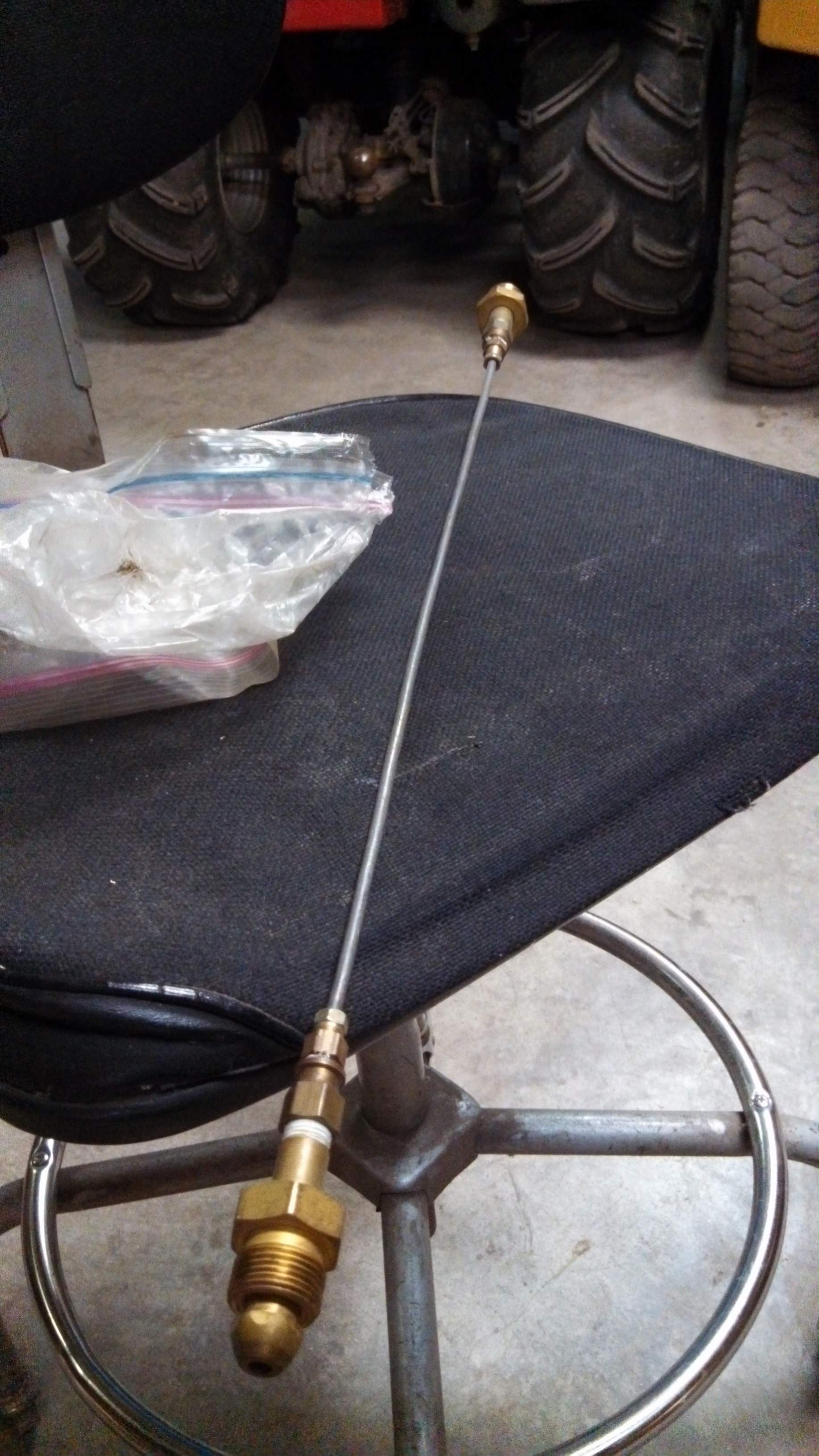

This is what I use. The ziploc bags are to keep "stuff" out of the line. The sets we have at the farm, the ends are covered in foil.
By not "full fill" it is not like taking a gallon or water and filling a quart glass with it.
Instead it is like taking a large air tank and filling a smaller one. the PSI the small tank fills to depends on the size of the two tanks. If one was completely empty and the other at 100 psi, IF both tanks are the same size and you connect them you will wind up with only half in each.
Perfect, thx for the pic!
