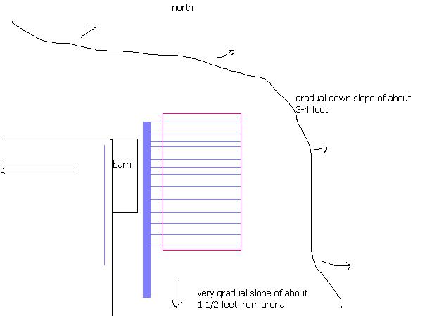

Attached is my attempt at drawing a site map. The red is the arena boundary, the blue lines are where tile drains would go. It's not to scale and the changes in elevation are approximate. The barn and future arena sit on a fairly flat area like a small plateau and I think it's impractical to drain east. It's actually farther to the edge of the "plateau" than I've drawn. The thick blue line is where I need to put in tile anyway to help divert water off the roof and from a low spot near the barn. Is it possible to run the arena drains into that larger one emptying to the south? I know a ditch would work better but I'm not sure I could put one there.

Grant,
You bet you can run them all into one and it will work just fine. What I did off of my barn is I ran 4" tiles into a 6" tile and ran that to the gulley where all the run off water goes. Just make sure that it all runs downhill to where you want to go. I have a transit that I use but you don't have to use one. Hey also don't make the mistake of putting the tile with the holes down. I've seen some people do that and wonder why it never drained. The tile will have holes either on the top or the bottom. Put it with the holes to the top. I know that goes without saying but some people aren't even aware that it makes a difference. I will get you some pics tomorrow if I get out of here in time to get home before it gets dark. I finally got my digital back today from being repaired.

Okay, I thought of a few more questions. How much did you slope your underground tiles from one end to the other, both the arena ones and the main drainage? Did you just dig a two foot trench and gradually fill in over the length using a level to make sure it slopes downward? Did you rent a ditch witch to dig that many trenchs? When you get a good rain, do you see a substantial amount of water coming out your main?
