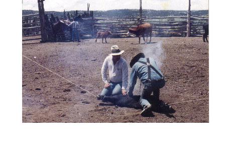

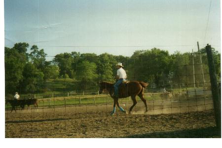

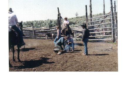

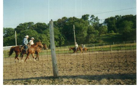

Grant,
Here are some pics of my big arena. It's pretty simple and doesn't even have 2x6's on top. It's 150x300.
   / Experience with making an arena #25
more
   / Experience with making an arena #26
another
   / Experience with making an arena #27
another pic

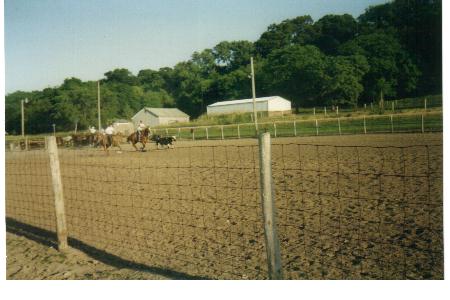

   / Experience with making an arena #28
Here's another arena that we use at home.
