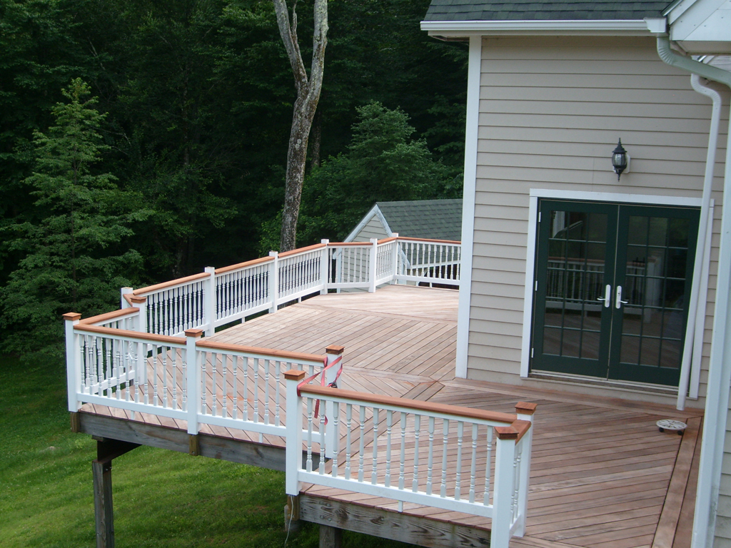

I'm telling you for the price of composite you should be looking into hardwood decking. The stuff lasts forever. Unlike PT it rarely has splinters and the only time it's slippery is when it has frozen ice on it. In the hot summer it doesn't get any where near as hot as composites. The stuff is so dense and rot resistant that several versions are fire proof. Ipe is usually extremely easy to find if you start calling around but there's other species that are a little cheaper. It has a lot of silica in it so it will dull blades and you want to wear dust protection (which you should anyway when cutting wood) so it's not as easy to work with as PT or composites. It's also a lot stiffer than cedar so it doesn't dent.
