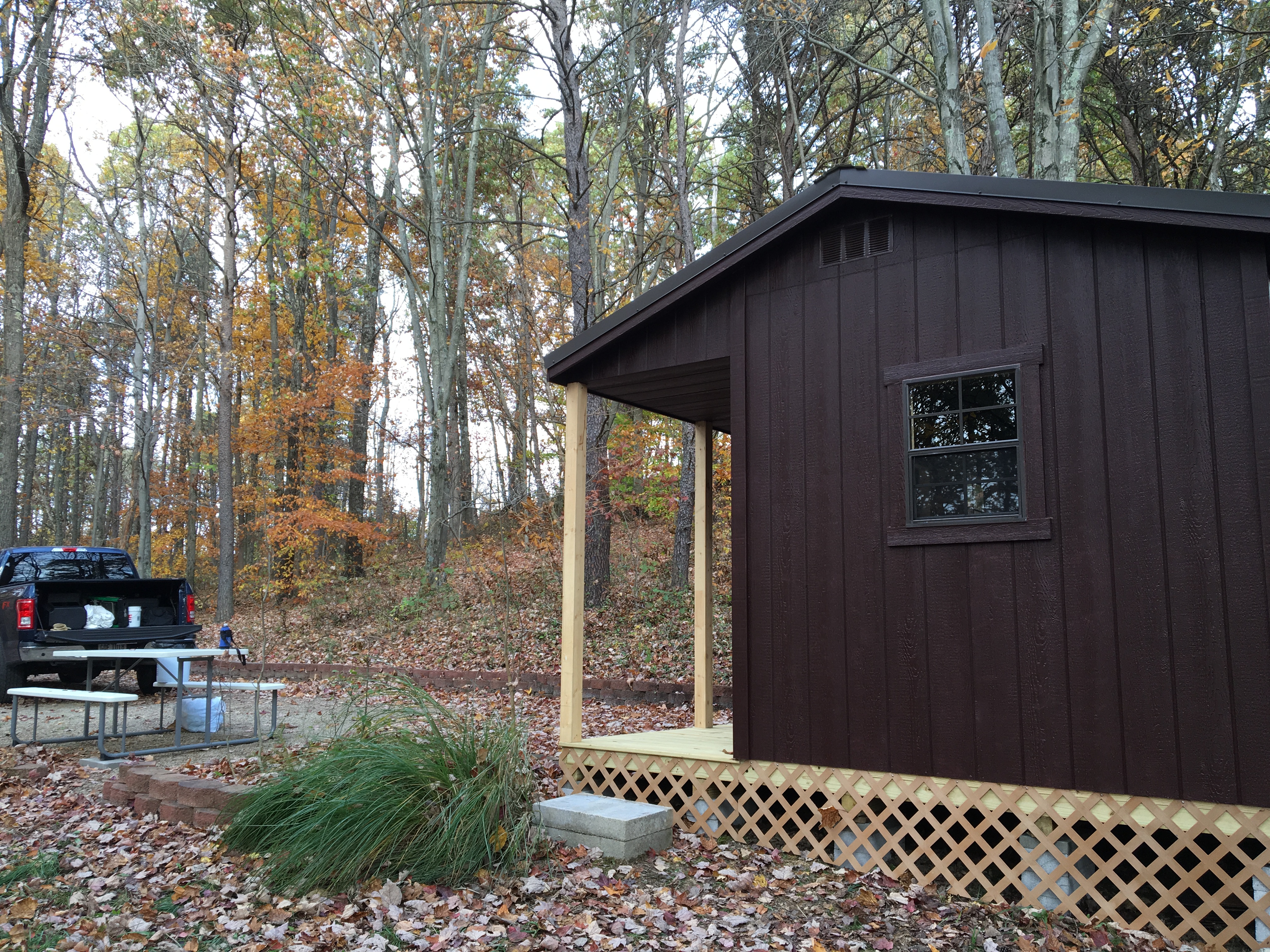

The best advice i can give you if you wanted a floating,freestanding deck is use the blocks on 4 corners only, use 2x10's doubled up on the headers and frame spans off from that and you wont need any middle supports for the size you wanted (8x12 or even 10x12)) and have virtually zero bounce. since you said the ground slops down 12-16 , one thing to think about is are you going to cut into the bank so the framing on uphill side will have top of ground flush so the downhill wont be about 2 feet off ground with blocks and 2x10's? even with 2x6's directly on blocks its going to be pretty high on the downhill side without cutting in bank. just some of the few things to think about. you might want to build couple steps the whole width of deck so no one will fall and get hurt and can step off anywhere on downhill side. despite of naysayers - a 8x12 deck is good for couple Adirondacks chairs and end table for viewing off comfortably or a small 3' round table with couple chairs will be just fine. building a small square deck isnt rocket science esp its less then 2 feet off ground. I'd build everything with screws if u could.
Thanks radioman. I'm leaning towards the skid style support like s219's, but i will evaluate the 4-corner deck block method as you suggest as well, and see which will be easier to level out. I'll also get the deck built, then determine if any additional steps or railings will be needed. My initial thought is no, but we'll see. Again, this is a remote camp deck, no codes or inspectors to worry about. The high grade end will match up with the deck on the front of the cabin, which will be the main enter/exit point.
Here's a pic that shows where the deck will go, matching up to this end of the cabin. The zebra grass has already been moved.

/ Experienced Deck Builders? #77
the picture is great, i'd think it'd be easy to copy what was done with the cabin,
some concrete blocks for piers, and a couple 6x6s every 4 ' or so then use the 2x6 joists as the cabin uses,
as you say, very remote, and no inspectors, it should serve the purpose well.

#78
That's kind of my thinking as well. But it might be easier to level out 4 deck blocks vs. 12' runners......I'll have to look at that closely.
