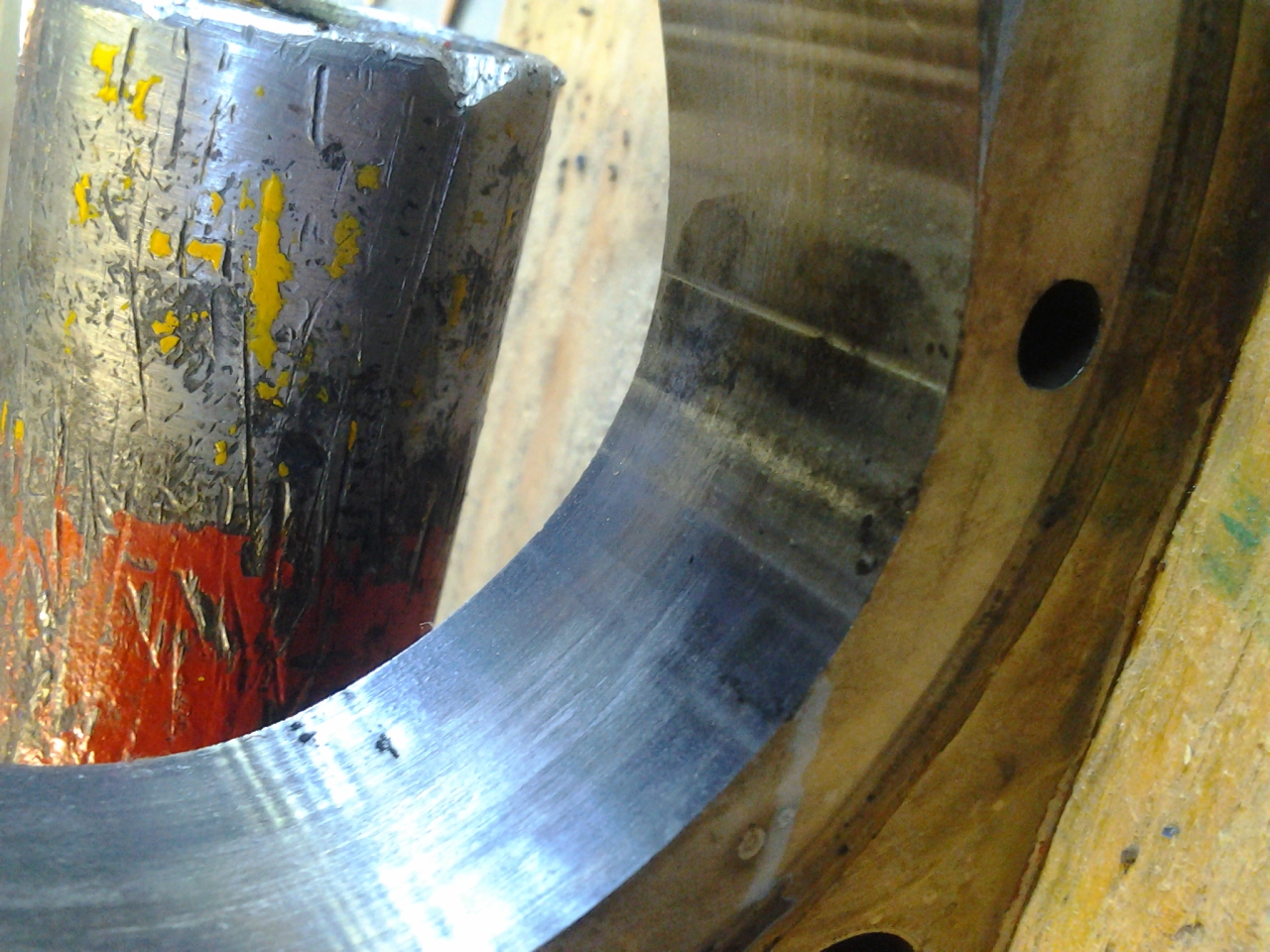

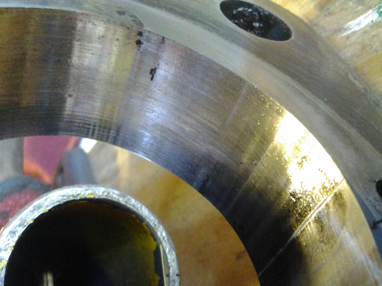

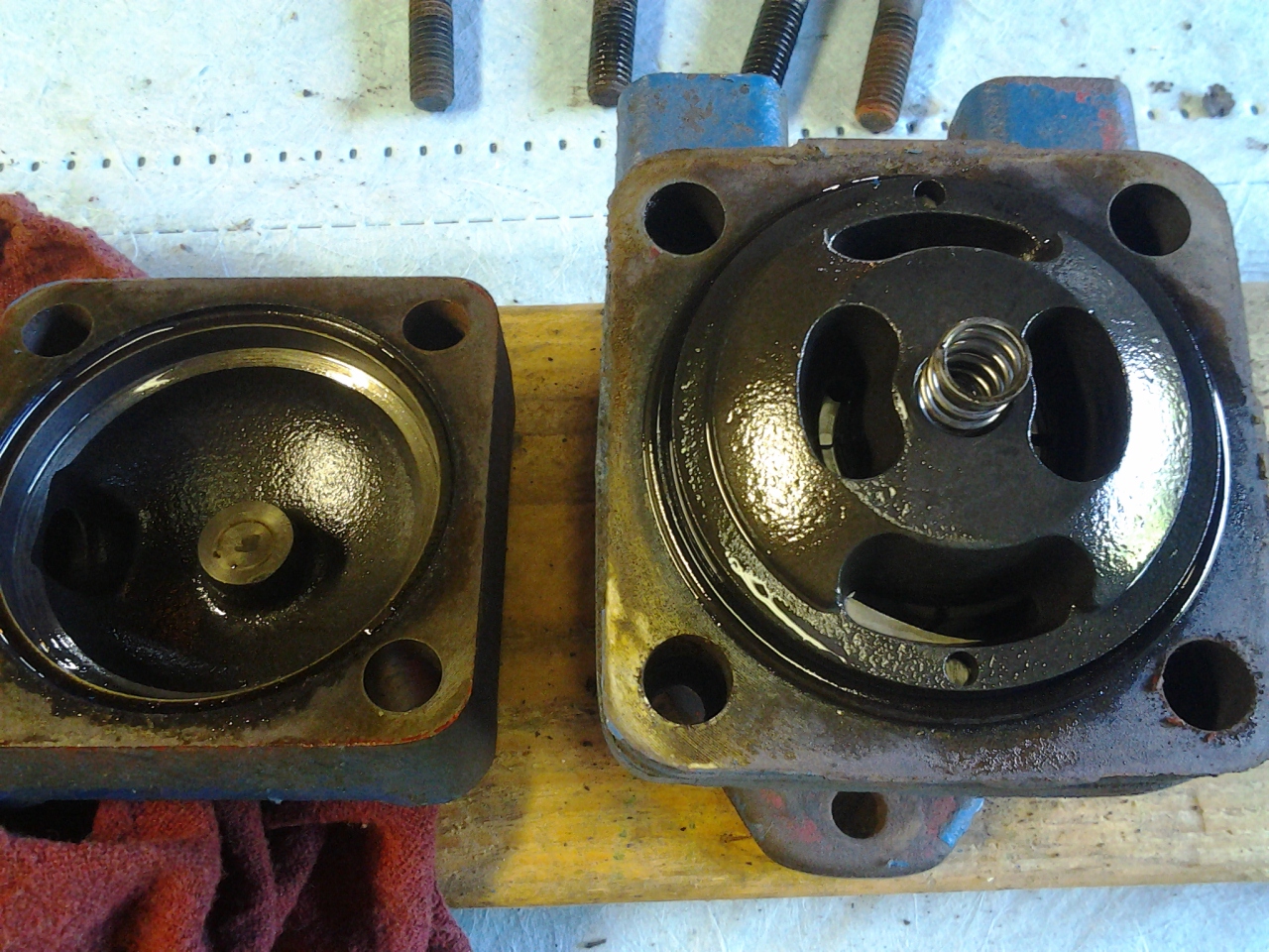

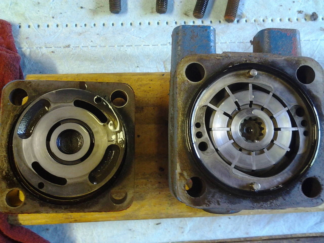

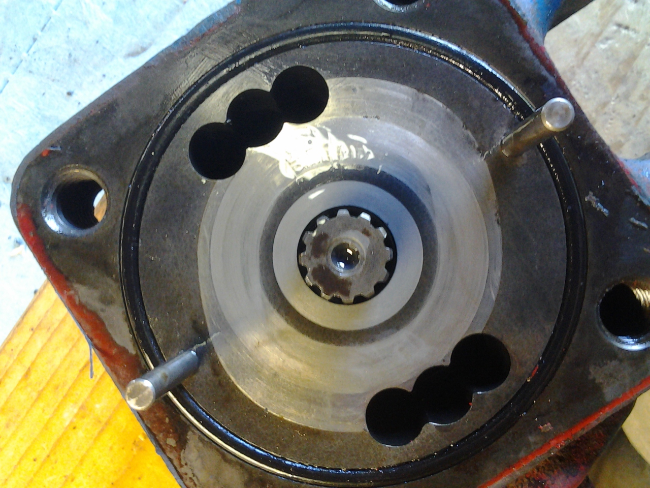

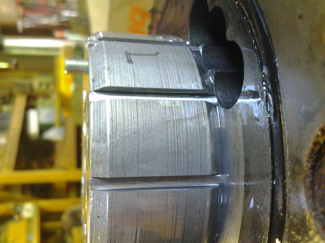

Well I got it apart today. Pretty straight forward per CJ's instructions and the exploded diagram. It looks pretty good for an old pump in my opinion. The old seal is kind of hard, not exactly brittle but not that great. A bit of scoring on metal parts but nothing outlandish. There is one spot on the ring that isn't great. The outer sealed bearing needs to be replaced the inner rides in hydro fluid and is in great shape. The shaft looks ok. I got a bearing for $8 at the local bearing house. The seal kit is ordered and will be here tuesday. Total should come in under 40 bucks. Here are some picts. IF anyone sees anything questionable please let me know.
Just FYI a rebuilt for this application would be $480 plus a core charge. Given that is nearly a quarter of what i have into this tractor total...that doesn't really pencil out for me... 20140710_125209.jpg20140710_120653.jpg20140710_122154.jpg20140710_122112.jpg20140710_122056.jpg20140710_120819.jpg
   / Exploded diagram for Vicker pump off Ford NAA #16
That ring is shot. It at least needs a ring and vanes. That pump is old enough that you have to replace individual parts. Pump looks as if the body is also the end plates/port plate. CJ
   / Exploded diagram for Vicker pump off Ford NAA #17
I agree with CJone: That cam ring is in bad shape and should be replaced.
#18
Well, that's a bummer. Any reconditioning I could do to in in the mean time?
I was quoted $496.51 for a new cartridge kit, plus freight. I could get a re manufactured pump for $557.00 minus $76.00 core charge for a total of $481.00.
So anyone have a good source for less expensive pumps? An eaton v20 is pretty much the same pump.
   / Exploded diagram for Vicker pump off Ford NAA #19
Try contacting Attica hydraulic exchange: 800-422-4279.
They rebuild Vickers vane pumps and also have a line of their own which is basically a direct interchange to Vickers. You will probably need a valid model code for them to help you.
