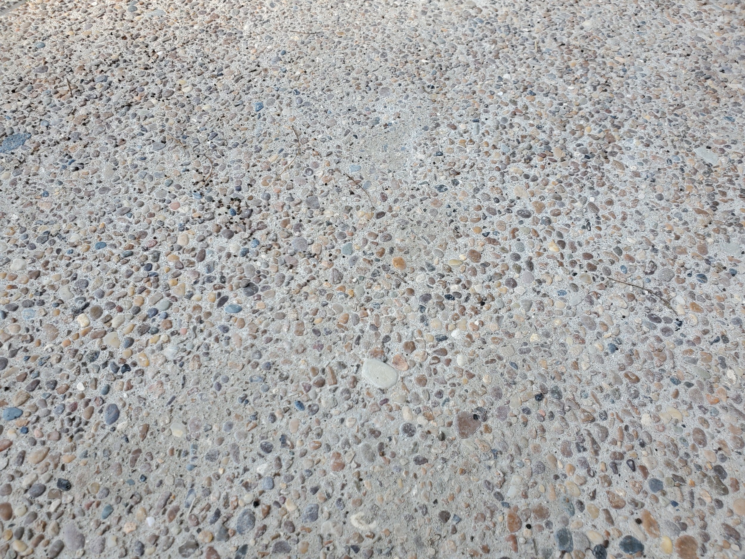

To me that is exactly what exposed ag concrete is supposed to look like....with the spray on and rince off method. By nature, concrete is only about 50% aggregate. And that looks exactly like what you have.

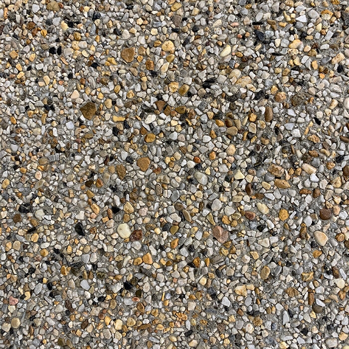

The picture of what you want looks like the aggregate covers 80-90% of the surface. And the way to achieve that is to "seed" the aggregate after the concrete is placed. More expensive and labor intensive.
The truth is, no matter how much you wash, blast, grind, or let wear.....the aggregate in your concrete will never look like the picture because as mentioned....50% of the surface will always be the grey concrete/sand binder and not aggregate
How many of these details were discussed with the contractor? Or what to expect or how it would look.
If you just called a contractor and said you wanted an exposed ag patio....that is exactly what he did and exactly what you got. So no need to point fingers and call him every name under the sun for doing exactly what you asked. Because what you asked for and what you wanted were NOT the same thing and that blame shouldn't be placed on him if that were the case

That is two very different methods and I believe your contractor should have known the difference. It's to late now, what you have will never look like what you want.
As it appeared, this creature does not know his but from his head, i showed him pictures, i explained what i want, i asked more than 10 times if he was sure it would be EXACTLY like this. and i told him i need 1-2" pebbles, not 1/4" ones
minimum 4,000psi and high volume

Yep. That's two different methods. Did you show your contractor that picture before he started or bid the price? One is the cheap route the other is a loaded aggregate. Typically done by hand and more expensive. You probably got what you paid for. But I wasn't there. :cool:
yes i did, and he told me he would bring additional aggregate. He told me 2 bags would be enough, i tried to argue that it is too little for this size, but he assured me, he knew what he was doing and 2 bags is plenty. He ended up using only 1.5 bags, but he put it too early and they sank to the bottom and you cannot see it.
Yep, it is what i wanted and was supposed to receive per promise and the picture is in the contract

What i asked and what i wanted is exactly the same thing, same picture i show you, was sent to him and attached to the contract.

After seeing the picture with the level in it, I'd say the contractor did the best job he knew how to do and his best isn't what you contracted for. That's actually quite a bad job unless it was intentional for drainage. I have the same problem in my area. Not sure there is really a solution to this other than tearing it out and getting a different contractor. I've not tried muratic acid on concrete so don't know how that would work, you might try phosphoric acid. That'll eat the concrete and leave the stones, but you run the risk of undercutting the stones and they'll then become loose and be worse than what you have.
There is an option to overlay this with an epoxy and gravel mix. I think they call it Cool Deck and use it around swimming pools for bare feet and drainage. I'd call pool companies to see what they have available as an overlay.

I am retired - but owned a company that fixed concrete problems. I currently consult with architects and owners in commercial construction projects.
First - Don't panic and do something to ruin what you have. It can be made to look much more like what you desire. And - Yes, you CAN make it worse. Especially by following many of the in-experienced ( and some hare-brained ) advisements I see in this thread.
Second - contact a company called ProSoCo. They are on line. They are the biggest and best at finding ways to fix and maintain exposed aggregate as well as many other forms of decorative concrete. They will have a rep that work with commercial construction material supplies that serve your area. Find out the names of the companies that sell their products.
Third - Once you know more about how the ProSoCo cleaners, acid based detergents, and sealers work - decide if it is something you want to perform or have a contractor that specializes in this type of "cleaning up behind a slob" work do this. After cleaning - this surface will need a penetrative water repellent applied to prevent freeze/thaw spalling ( rocks popping out )
And - lastly...folks who have no actual experience in these things seem to feel empowered to get on a computer and tell someone else how to fix" a problem. They ought to be head slapped for that. And, you really should do your research for fixing this with an attorney letter to the concrete contractor - and Google. Not a discussion forum about tractors.

pea gravel exposed aggregate is what you have, the color is different that salt and pepper .how big is the slab? looking at the pictures I don't think you will ever be happy with it. you can live with it or break it up and start over. Years ago I did an exposed aggregate patio on the 1rst house I owned. I practiced first by making some exposed aggregate pavers before I did a whole patio. I used 1" con mix then seeded and tamped in salt and pepper stones ( small black and white stones ) then sprayed sugar water over the top and gently used water and broom to expose the stones. there is a learning curve to doing exposed aggregate. it takes some practice to get it right.

Sandblast a corner or area off to the side to determine what pressure gives the desired results.
It doesn't matter what kind of gravel you use it all depends on what the desired color and pattern you want in the end. There are different colors and different size stone to think about and that should be relayed to the batch plant where the concrete is dispatched from.
Weather it is larger stone or pea gravel makes no difference to the concrete you work it the same. The mix is worked so that by gravity the rock settles down leaving a thin layer of pasty mud exposed just like with any type pour. At that point you have one of three options, a brushed finish, a slick finish, or the exposed aggregate look, well, there's also the stamped option but that's a whole different ball game. If you want the rock exposed, you spray on the retardant and wait until the lower-level set's up then you pressure wash the mud off leaving the desired results.
If timed and prepared correctly there is no reason any of the exposed rock should ever pop out and should last as long as any other finish would last. Of-course you would probably want to apply a resin-based sealer to the finish a day or two later to make it shine.

I would use acid to remove3 the top layer and scrub then wash off should take the residual left on those areas may have to use a wire brush to scrub but that should work but be careful with the acid and make sure to use all the precautions on the label you can find it at most hardware stores.
