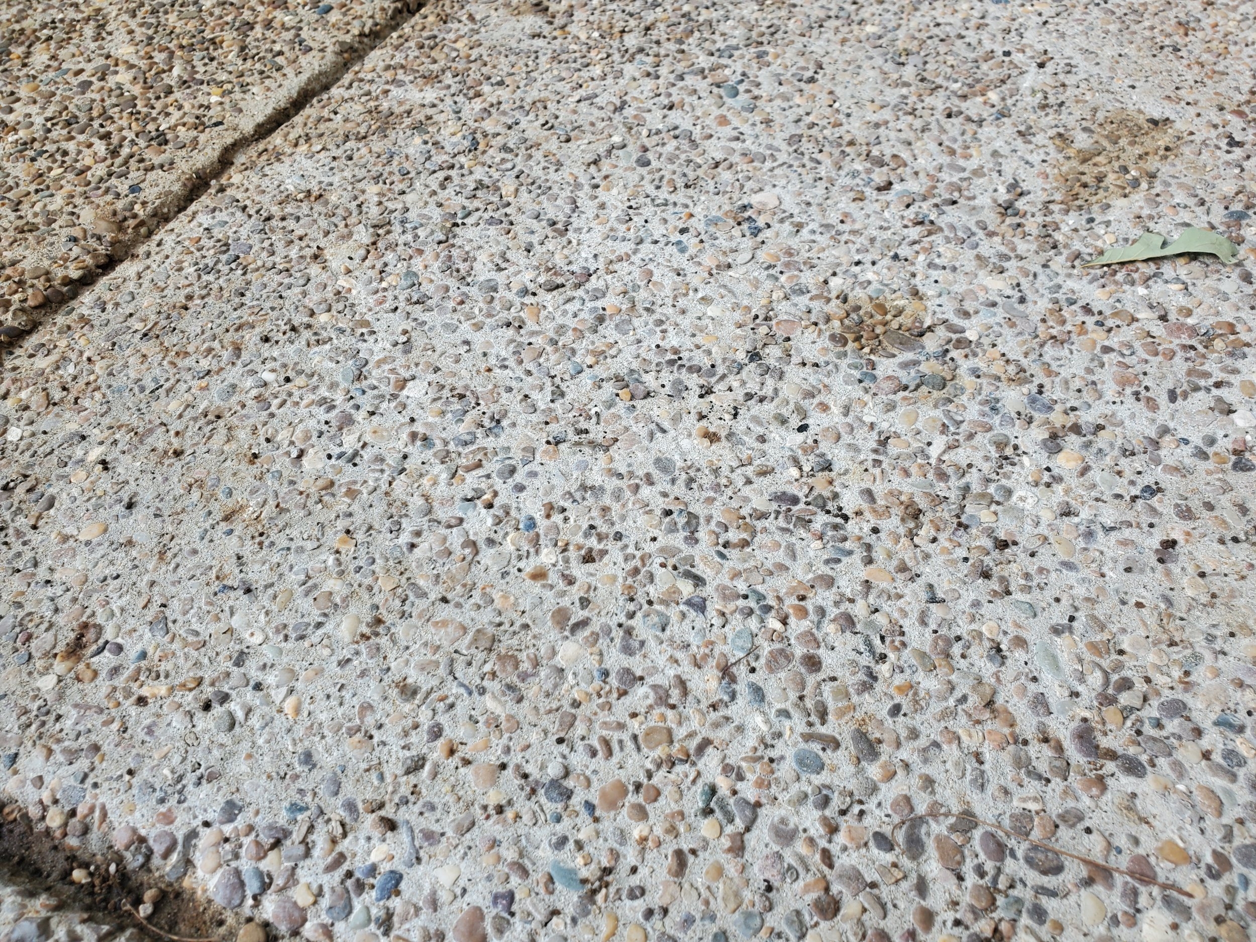

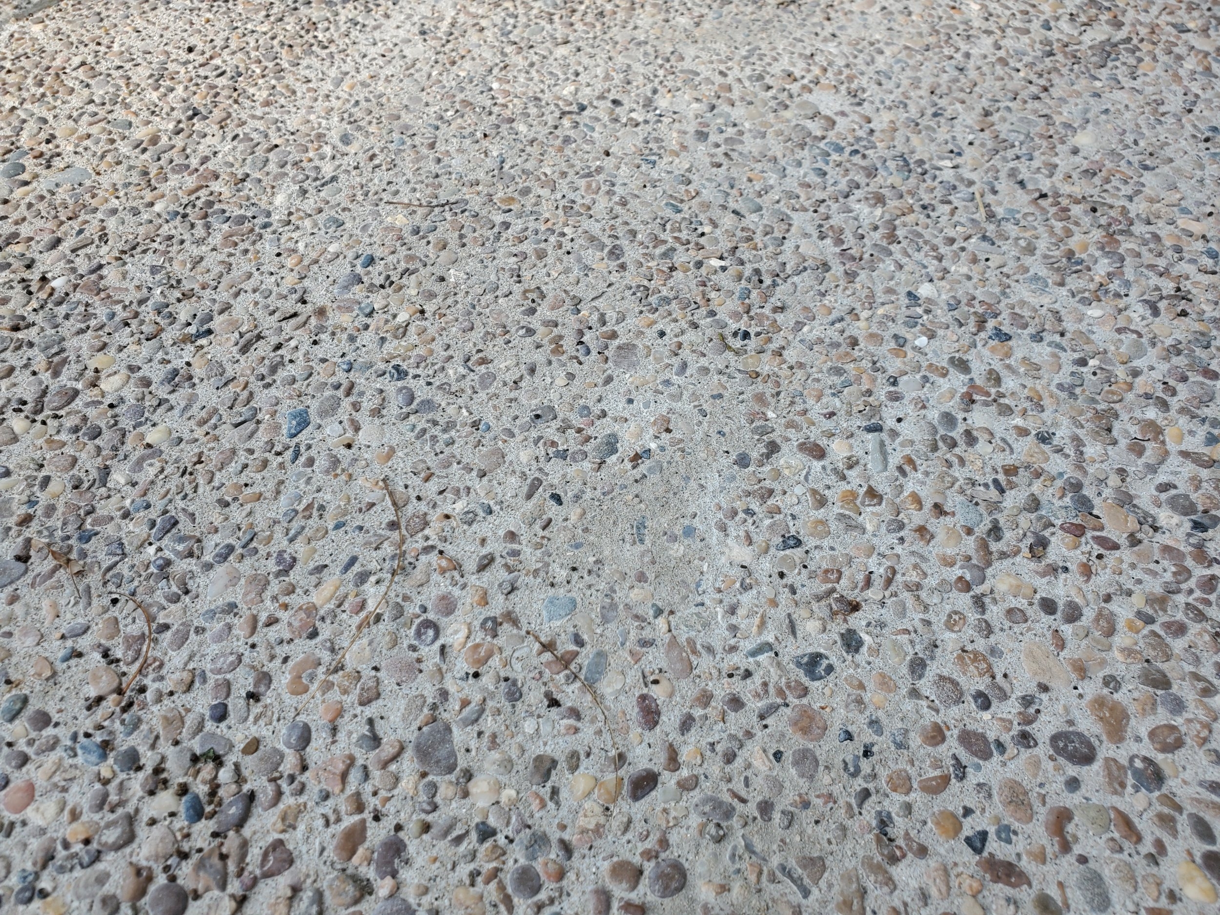

Tried it as well, the wire wheel leaves black/gray/silver metal color on the rocks, looks ugly.
Here is what i was expecting:
amanda1-1024x768-jpg.811057
Not this:
20230712_175002-jpg.811058
I'm not sure that is the same process. We did the exposed aggregate for the driveway in front of Mom & Dad's house years ago. Basic pour and wash off, I think. It was a long time ago. I think it ended up somewhat like the better patches of the second photo. Not patchy, although there may have been places that weren't perfectly flat. It was something that our family did together, so no contractor to complain about. It has weathered well over the years.
For the first photo, either they had a very high aggregate to sand mix (potentially making weak concrete), or as the concrete was setting, they added dry aggregate and rolled it into the surface. Anyway, whatever was done, it wasn't as simple pour and wash off.
Talking to your contractor before the job though, hopefully he actually understood different processes, but apparently not.
By now the concrete will likely be set pretty hard. So, perhaps sand blasting, soda blasting, or dry ice blasting. Perhaps there would be a way to make a test piece for your contractor to do a demo before you pay a bunch of money for something you won't be happy with.
I'd probably just leave it and let it age naturally. Is the concrete exposed to the weather?

Ahhh... so "seeding" was the step the contractor left out.
I'm pretty sure we didn't do that when we poured it at Mom & Dad's house. I can try to get some 40 years later photos if you wish. In the archives, there may be some fresher photos.

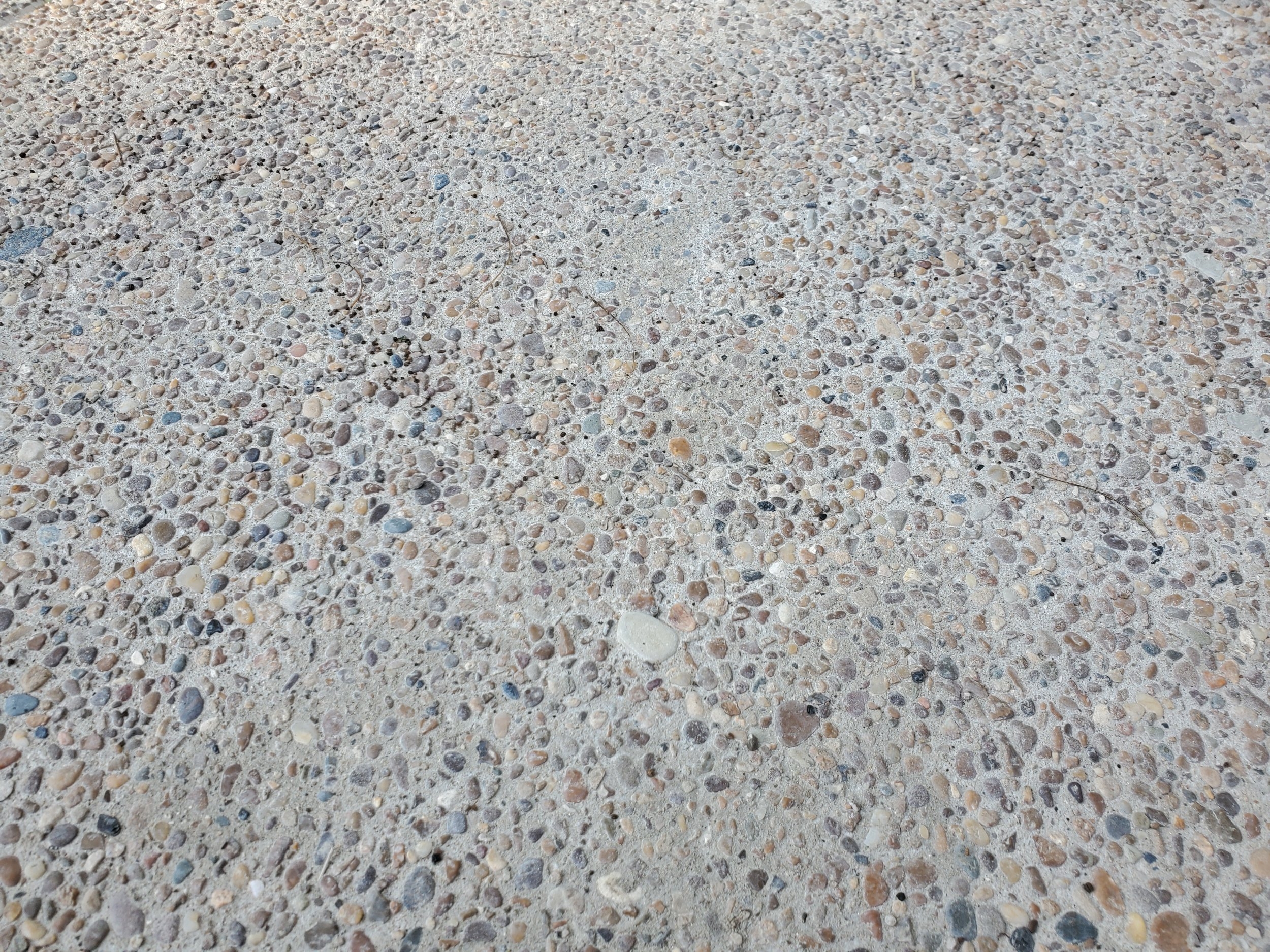

Looking for an advise and TBN collective wisdom.
I hired a concrete contractor to make me a patio with exposed aggregate concrete.
The guy came, poured the concrete, sprayed the retarder, waited about 2 hours, washed and left.
When he was leaving i asked them why there are so many spots covered with the concrete, like 70-80%.
His answer was, it is send and concrete dust which tomorrow you can wash with regular hose. It is not going to harden.
Next morning i could not wash it not with regular hose, nor with jet spray.
I contacted him, he told me he would come later this day. Needless to say he never came, does not answer the phone, texts and such.
The question is: How do i remove a thin layer of the concrete to expose the aggregate?
I tried muriatic acid and KLEEN KREETE - no dice.
Are there any other options?
View attachment 810840View attachment 810841
Can you turn the power level up to 11? Or rent a bigger power washer?

Sandblasting is the answer.
I’ve had it done to probably 50,000sqft that didn’t finish well on a college campus.
