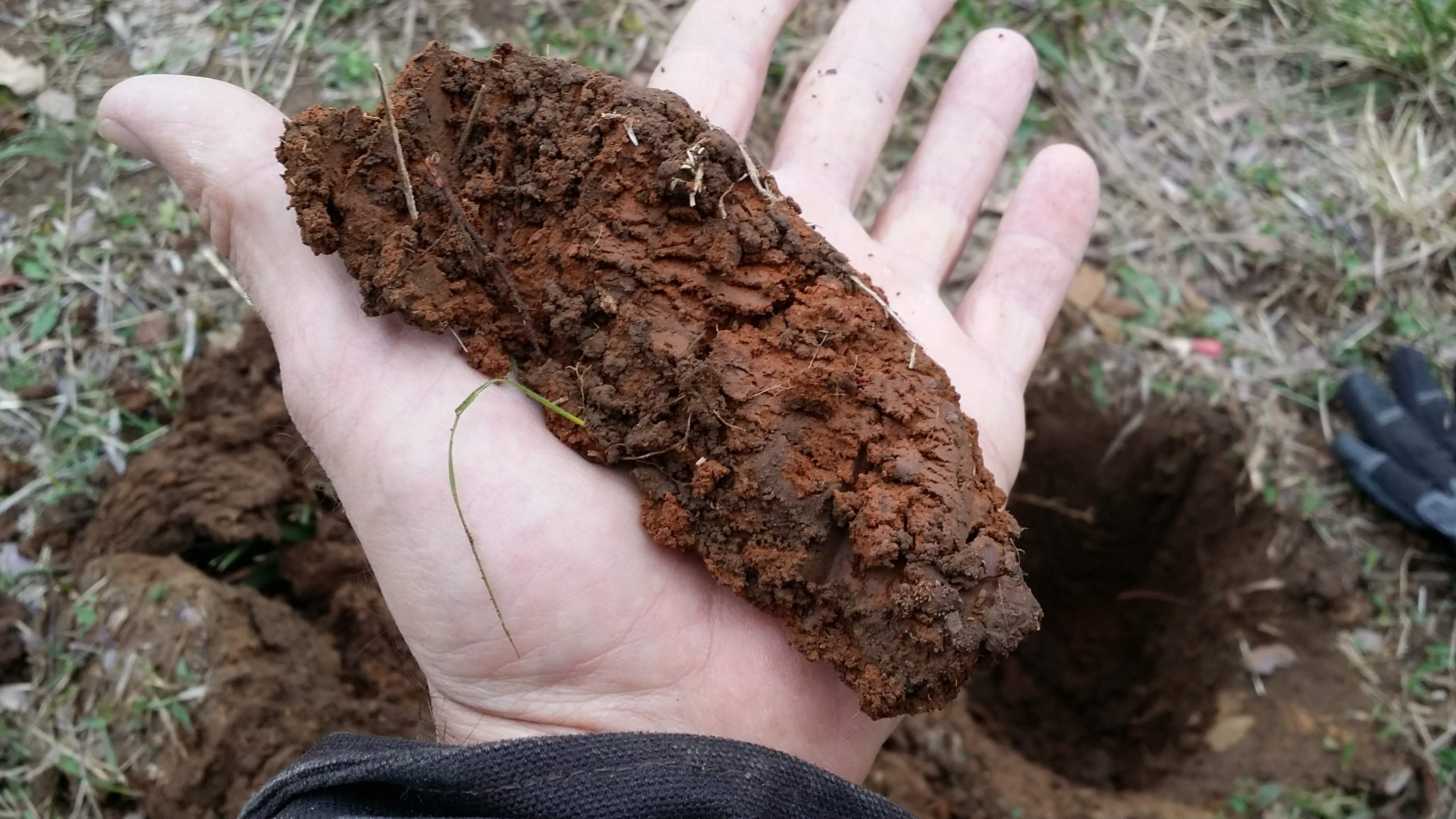

Thanks Eddie. We actually do have very soft loamy top soil. Already stuck the truck once. :ashamed: Once we go down about 8" we hit the red clay.
The revised plan is to remove 8" of top soil to get down to the red clay and lay the geotextile. Then we plan to install and compact 10" of road base that is used by the city here. This would bring the road surface up 2" above grade. Proper shoulders and ditches should keep the water from making it under the geotextile. Is my assumption wrong?
Here is one of the test holes I dug and a chunk of the clay found at 8".
-Brent

Okay, New England logic here, so I may be way off base...but I always think of gravel, packed or not, as being more permeable than clay. So it sounds like you're planning to remove your upper "sponge" layer and stop when you reach the clay.
It would be more work, but what if you remove your topsoil all the way across both your ditches, too? Then take an inch or several of the clay from the ditches, and pile and pack it on your roadway with a crown, so that this water resistant layer has both a slope and a ditch to go to. Then put your fabric and gravel on that to support the vehicle weight now that the under layer is managing the water?
It's also just as likely that a water filled channel in the clay on either side of the road would be almost as bad as a channel in the middle of clay under your roadway, but as you are currently describing it, you plan to stop at the clay layer and not dig into it to put in your roadway. I think several of us were initially picturing your road being cut into the clay and then filled with gravel...pretty much making the road a low spot where water would collect.
If I'm reading Eddies comments correctly, he may even be saying that if you pile and grade the clay correctly, you won't need the gravel...?

I think understand what Eddie is saying about creating a ditch full of rocks. Makes perfect sense. He may have missed the part about me deciding not to use the raw crushed rock anymore. I changed my mind and decided to use a local road base aggregate to build up the entire road to 10" which will be 2" above grade. This should be impermeable after compacting and keep the clay subbase dry. I think it's also important to remember that I am going down a 4-5% grade which will allow me to use shallow ditches and should easily keep the water flowing downhill. I think my biggest challenge on this downhill road will be ensuring a proper crown so the water does not run down hill on the driveway surface and wash it out.
My lack of experience tells me that I am probably wrong about most this though. LOL

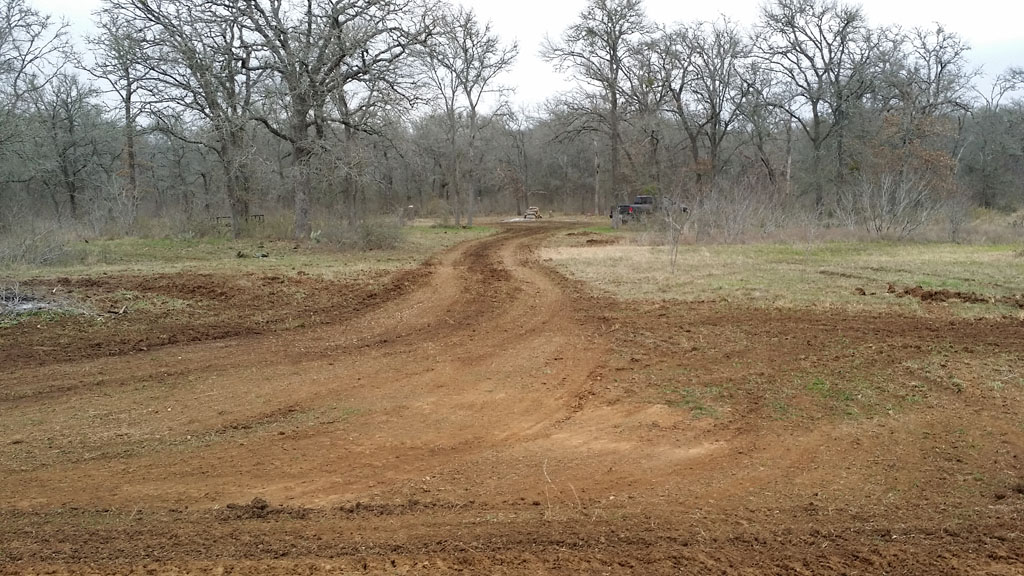

We (dad and I) got a little work done on the road this weekend before the rain started. We heard from the county about the culvert on Friday. No culvert required for our 24' turn it. We were told we could install a dip driveway. When I asked what that was he just said cut off the high spot on the back of the ditch and lay rock to the road. Excellent news since I was concerned about the concrete trucks crushing the culvert.
We used the 33hp kubota and the 6' box blade to get the road subbase going. We did not remove all the topsoil. Only the organic stuff. We measured and marked everything so we could get started. We measured the slope with a line level and got 4%. We ran the surface several times with the bb rippers fully extended. We dumped most of the removed material since it was full of organic stuff. Then we ran the box blade with no rippers for quite a while and moved material to low spots. Between running the box blade we compacted with the truck. The soil seemed to have perfect moisture for compacting other than a couple of soft spots. Here is what it looked like Saturday night when we left.
On day two we had to do some cut and fill with the bucket to try and make a steady slope since trying to move it with the box blade was taking a long time. We cut half the ditches with the box blade set to an angle. It worked well but we went too deep in a few of the softer spots. We will fix that later. I still need to go back and make a transition on the outside of the ditch but we ran out of time. All in all, phase one is going well. (Day two pic)
We still need to build up the road subabse and shape it, then drive on it for a month or so to get it nice and compacted. Then we will lay the geotextile and road base. Overall, I am pleased with the results so far. Thanks again to everyone who posted advice. It has all be helpful in one way or another.

You're plan is sound, but I'd make a couple of modifications. I couldn't read what you were planning using for the base, but it should be a coarse produce. 3-4" is excellent. Now this product is very hard on tires. The contractors are OK with this, but your car will hate it. My local quarry has 3" TB (traffic bond) which has fines in it. The fines do help stabilize the rocks so they're not as abrasive. This stuff doesn't make for a bad driveway, especially for construction traffic. I feel that with expansive clay, the 4" base is a bit on the thin side. I'd suggest increasing this to 6" and keeping the 4" top coat. The 1-3/4" top coat is a bit coarse. Personally, I wouldn't use anything coarser than 1-1/4".
When you are at the point of the temporary base the driveway will be low and will catch water. Be sure to provide a aggressive crown and provide opportunities for the water to escape.
