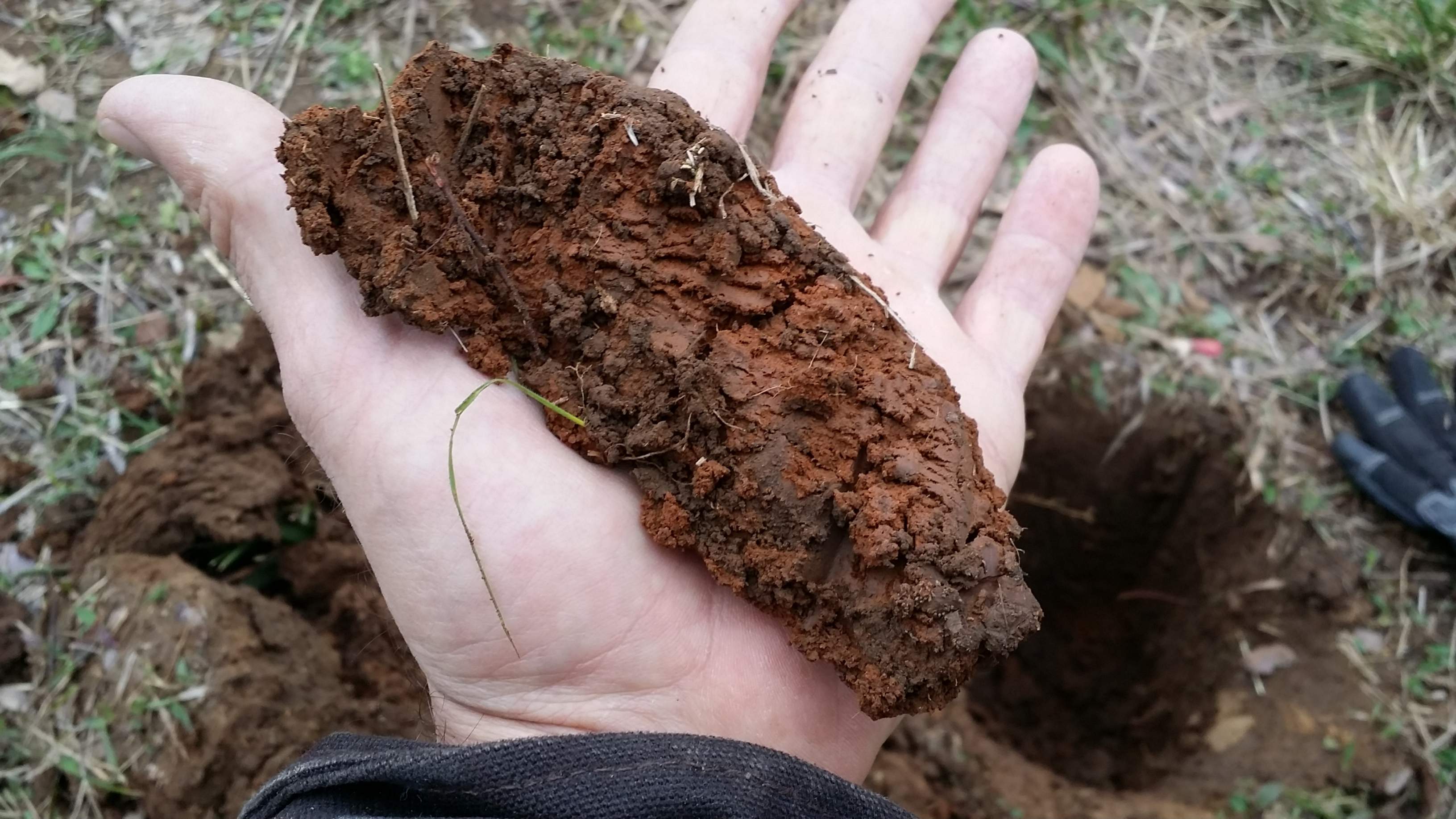

The initial portion of our driveway is going to be 12' x 200' and travels downhill at a 4-5% slope. The soil is high clay content and has a pretty high rate of shrink / swell. (So the soil reports says.)

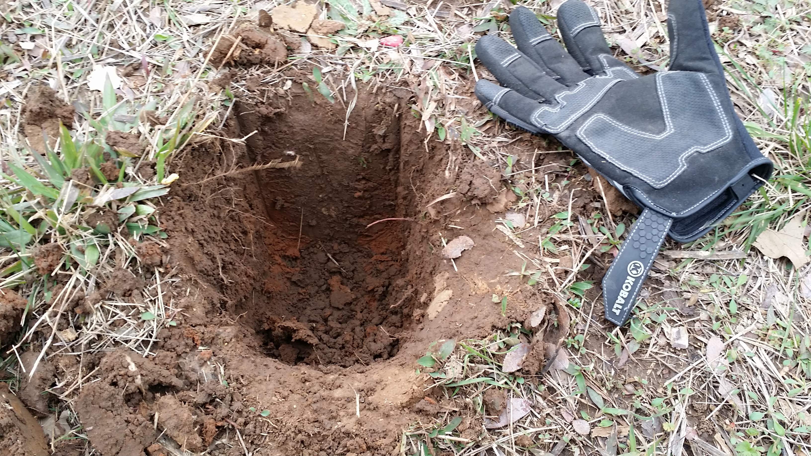

For the road subbase, we will remove top soil down to 8 which is where the red clay begins. After the subbase is leveled and compacted we will be installing geotextile woven fabric. Then we will put 8 of 3肺1 crushed limestone for the road base. There is no fine materials in this rock. It will initially be compacted with loaded vehicles. My plan is to get this portion of road built so we can begin construction of the home site.

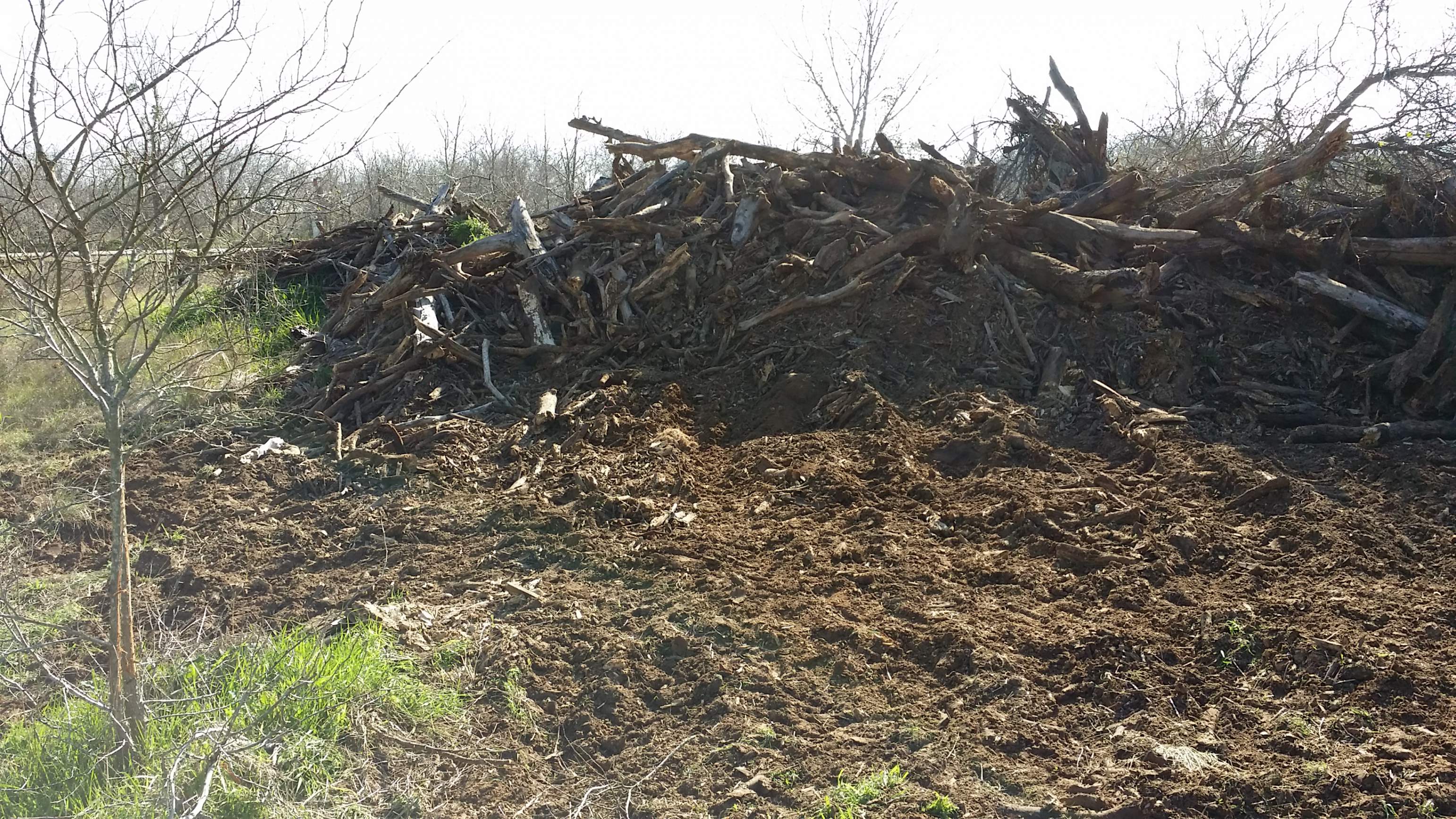

Now they are just in huge piles scattered around the property. They would be easy to burn if the person who did this wouldn't have mixed the dirt in with it when they were bulldozing. I am going to leave a few of the piles as wildlife habitat, but the ones that can be seen from the house and street will have to be burned. I attached pic of the one I plan to burn this weekend.
The piles that have a lot of dirt mixed in with them already would be good candidates to make a "hugelkultur" bed out of them. -Link-

Thats pretty cool. I have never heard of a hugelkultur bed but I can understand the concept since some of the piles I have look like they have already become hugelkultur beds. A few of them I am leaving as such. There are several animal burrows in them and they are growing plants already. One of the draws to this property is the wildlife, so I want to keep as much of their habitat in tact as possible. I like your idea!
