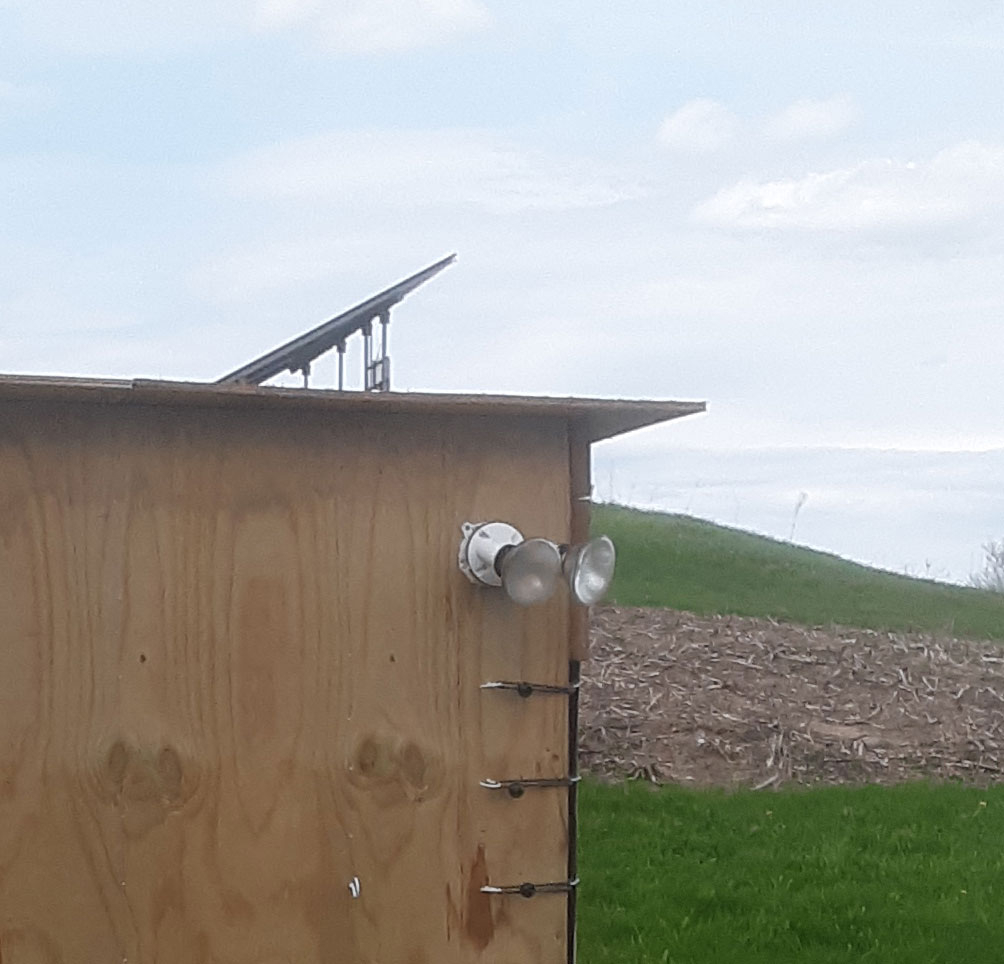

No power pole here, my power is buried from the closest pole on the road. Nothing to get them up high. With a one story house a light like what you are referring to would no light up my entire driveway even from the peak of my roof.
These are what I currently use.
They point right down the driveway.
I can't mount the solar light close to the house because they'd be on the north side of the house and would not get sufficient sunlight to charge the battery. My other shed where I can mount it is out of range of the remote, but the angle would be similar. I might be able to get it up a bit higher, maybe 10 or 12 feet, but with the slop of the driveway they would still likely be pointing right at a cars windshield in order to illuminate what I want to illuminate.
