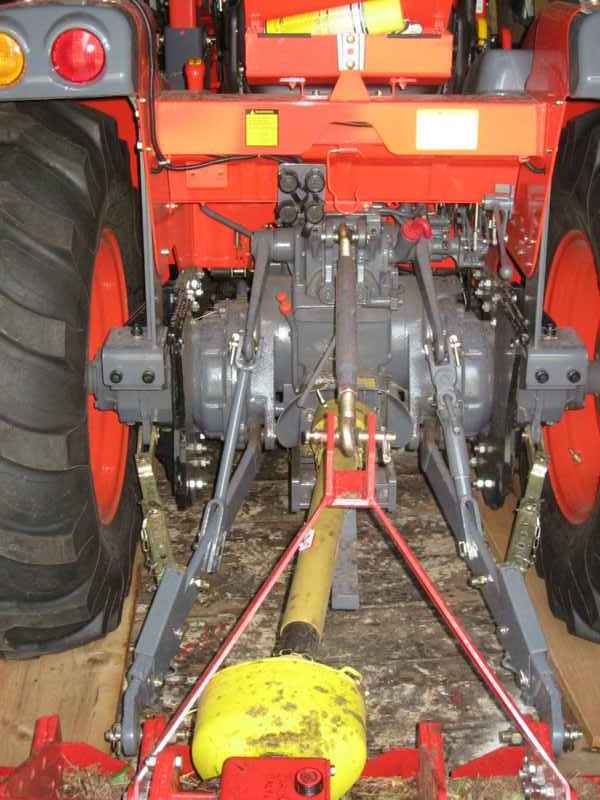

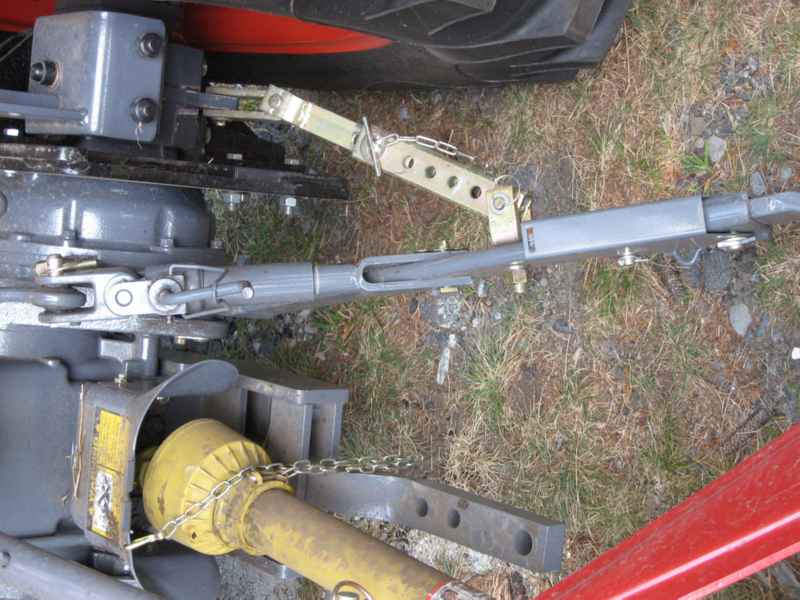

My Kioti DK40se has telescoping links and I imagine they might fit a JD too. Not sure of the replacement price.
