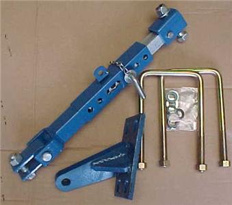

Tessiers, The picture is what I am going to make in the near feature. Maybe it will give you some ideas. This one is for a ford 4000 tractor.

Are you talking about the lower drag links or arms, or the stabilizers like Charlie shows in his photo? If they are the lower drag links, I'd consider making them as heavy a construction as I could if you have the room.

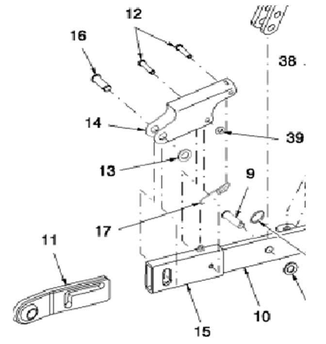

The NH system uses a pocket on the end of the lift-arm. The extension slides into that pocket and is held in place by a spring-loaded latch. The latch has a pin that fits into a L-shaped galley in the slide. When the slide is all the way in, it latches. When unlatched, it is free to slide as needed. I've included an attachment to show the detailed parts.

I think you are making great progress. Your decision to add a spring to hold the latch is probably a good choice too. Are the ball ends on youur OEM lower links at that much of an angle?
/ Extending Draft Links
#13
Yes, I coppied the angle exactly from the existing ball ends. It actually looks worse than it really is. The tab on the new ball ends that you weld to are at an angle from the ball end so I turned them to give me the most weld surface. My next problem is that Tractor Supply doesn't have anymore ball ends in stock so I'm at a stand still for a few days. I originally only bought 2 to make sure it all worked before I invested too much money. I did however install the side I had finished to make sure it all lined up right, and it did, amazingly enough. A little grinding and paint and 1 side will be done, the other side is now complete except welding on the ball ends. Total cost so far is $57.00, with 2 more ball ends and paint I will still be under $100.00.
