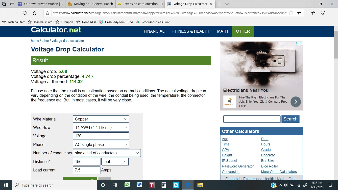

I have a job to do that will require a hammer drill. The only such drill I own is electric, 7.5 amp. The job is located about 130 ft. from the nearest plug. The only extension cords I have are the cheap 50 ft 14 gauge type. Couple of questions. 1) How much power will I lose using this type setup? 2) Will I potentially do damage to the drill?

The old rule of thumb for voltage drop is: You go up one size for every 100'.
14 gauge is rated for 15 amps, IIRC, so 130' shouldn't reduce the current enough to hurt a 7.5 amp motor.
