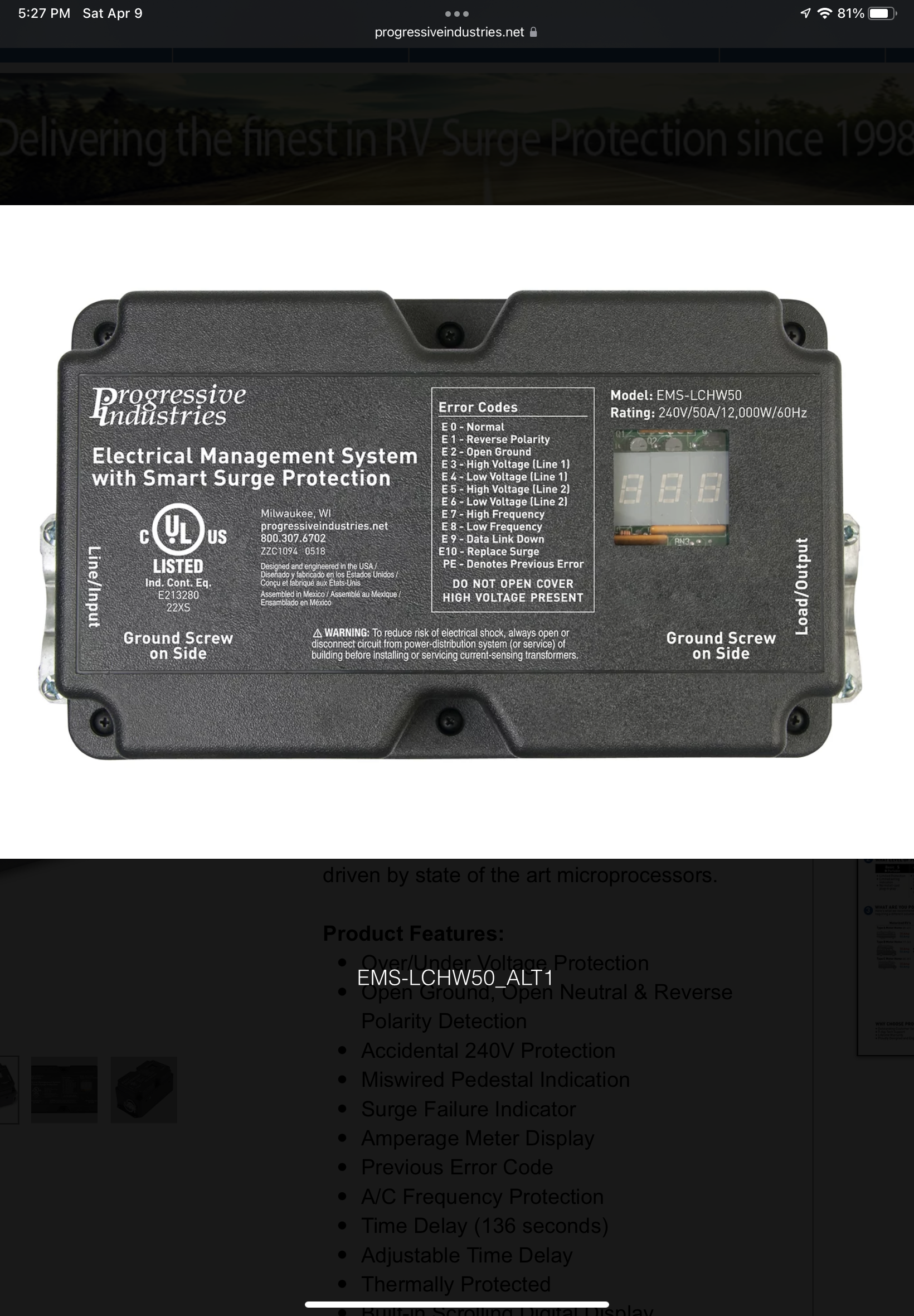

Ok, you'll clearly see I have no electrical experience. I have my motor home plugged in at the storage unit. It appears to be only 15amp gfi outlet and I have a short 14 10' extension cord plugged in to keep batteries up. No problem with this setup. Then after a trip, instead of backing it in and having the sun hit the windshield I pulled it in forward and ran a brand new 12 100' extension but it kept tripping the surge protector and eventually tripped the gfi. I have mostly everything shut off and just incidental stuff still on. Put it back he short cord and all is fine.
What's up?

it shouldn't trip anything, what do you mean its tripping the surge protector? sounds like the new cord is bad.

Thanks guys. Here is the surge protector that one of the best that I installed. It kicks off if it doesn't like the supplied power at campgrounds to protect the rv.
I did leave about 50' coiled up inside the electrical compartment.
How could I test the new 100' cord?

what is it tripping on?

When I first got to the storage unit to ck on it, the gfi was tripped so I reset it. It then was kicking on and then off every few minutes which is the surge protector doing what it does. The gfi never did trip again while I was there switching direction and the cords.
/ Extension cord question #10
right, they throw an error code indicating fault condition, what is the fault condition?

Pixguy, GFCIs only trip on a ground fault. If the GFCI is outside they can accumulate moisture and provide a lot of nuisance trips. The RV power manager unit will trip on a low voltage or overload. 15A circuit w/that long a run would not take much to overload. A RV refrigerator on electric is probably a max load for 15A especially with a long run.

Pix go get the error code and we can go from there
