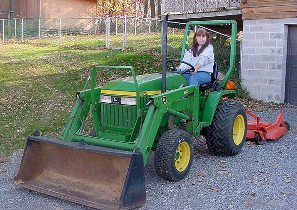

Definitely the bar turfs! You won't need the turf tires at all!
I've got the bar turfs on the rear of a JD 670. Haven't had any problems with scuffing or tearing up the lawn in any way. Now, I don't take the machine on the lawn when it's wet or soft at all.
